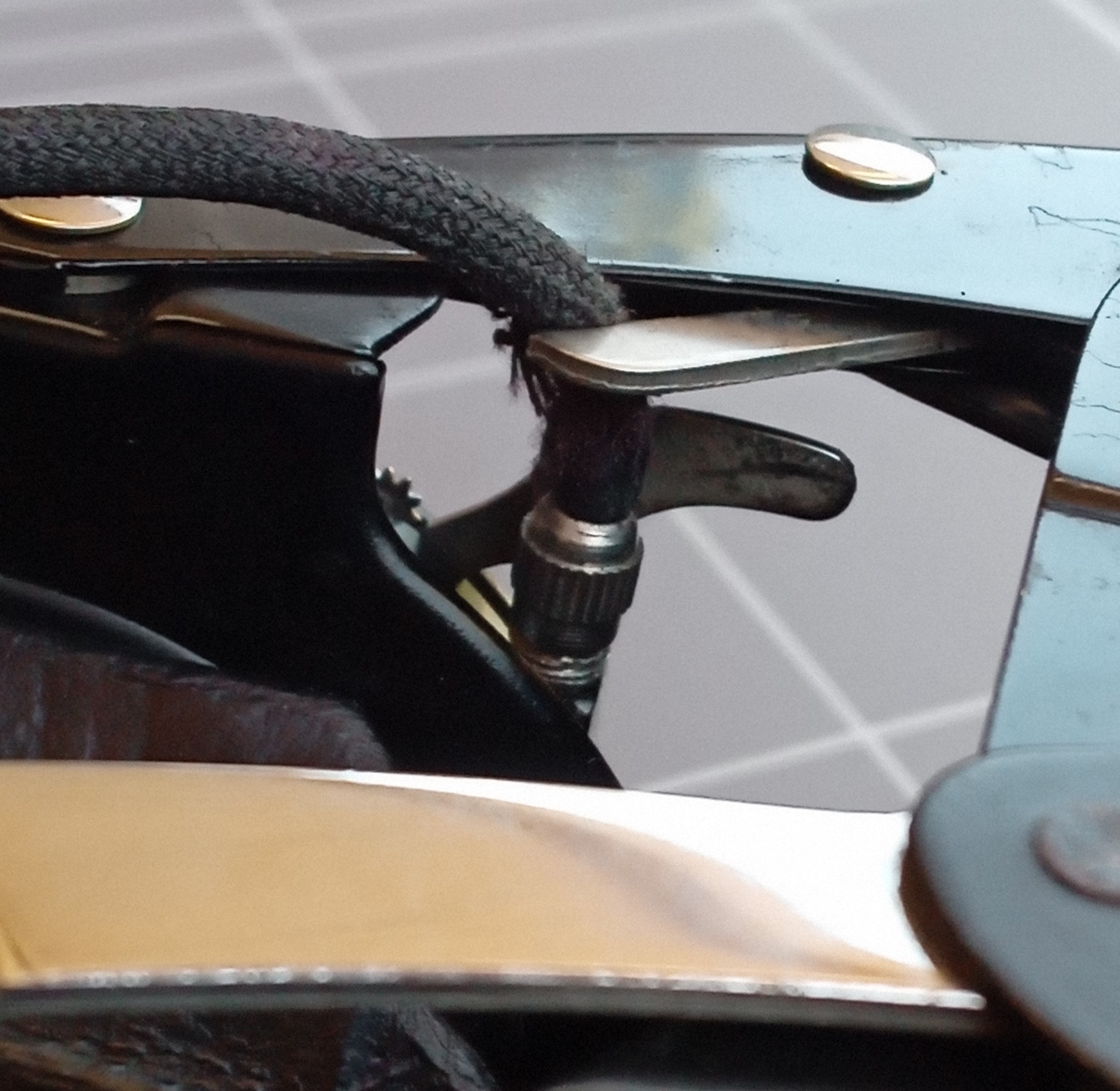

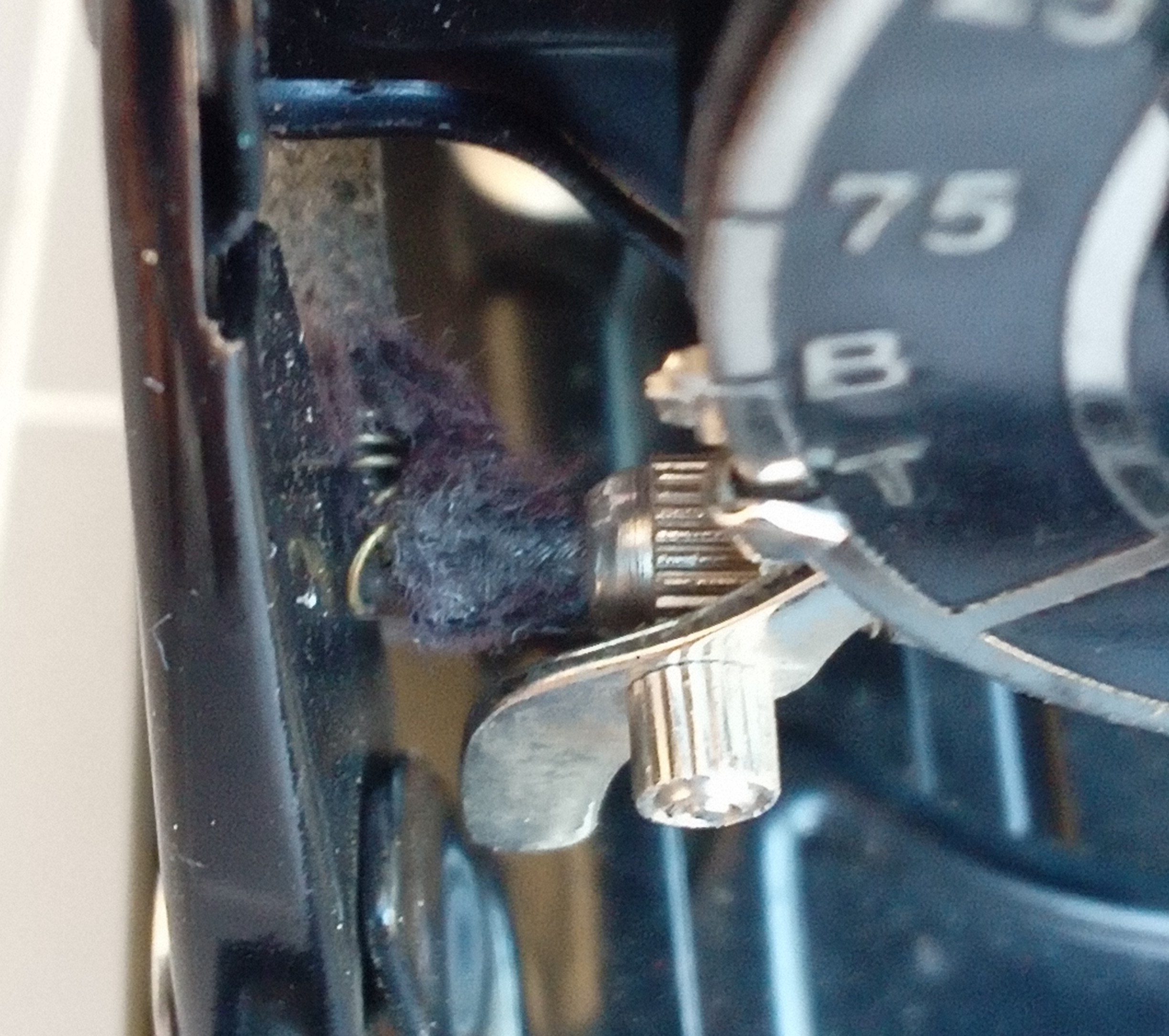

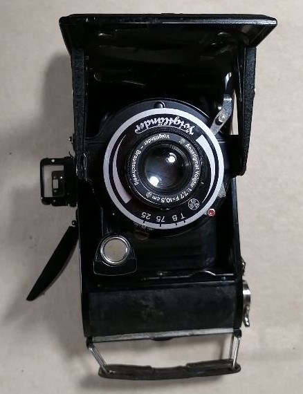

I guess it was cheaper for Voigtländer to supply the short and bent shape cable
I saw pictures from old Voigtländer catalogues and it looks like the cable was meant to be left in the camera. I doubt that I can do this with my Bessa though. I will need to rotate the shutter first, attach the cable and rotate the shutter back hoping that the cable does not break and remains functional.
I unscrewed and screwed back that cable in various Voigtländer folders, including different generations of Bessa.
It is comical how nobody would take out the engine of their car and turn it around when a problem occures but assume in a pinch that Voigtländer employed idiots incapable of mounting the shutter in the right position.
I guarantee you can screw in the cable, it needs a bit of fiddling indeed.
Try to have the struts not completly erected, also try to have the lever pressed/unpressed so it gets out of the way. RTFM would also not be wrong, V. explains what you have to do.
L.E.: Here you go: https://cameramanuals.org/voigtlander_pdf/voigtlander_bessa-optical-finder.pdf Second picture in that manual. You can clearly see how the socket for the cable is fully accessible when the struts are not completly erected. They right strut advances "over" the hole only when locked in place. Until then you can screw in any cable (with the correct thread, it escapes me at the moment how this thread is called) and then either bend it upwards or thread it under/behind the struth.
You clearly haven't looked at the OP's photos in post no. 8. His cable release fitting is nothing like the one you reference.
The metal tip of my newer cable release is longer that the metal tip end of some older cable releases.
The shorter tip end allows the cable release to fit in tighter places.

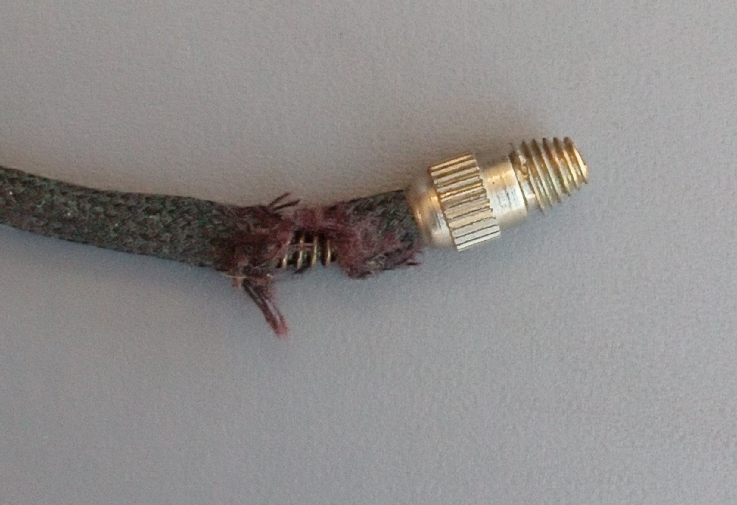

I sacrificed a half-broken cable release to clarify the matter.
Attaching the cable to a partially folded camera was indeed straightforward. To fully erect the camera I had to bend the cable at a very sharp angle resulting in breakage of thereof (or it would have it was not already broken). The cable was not functional when attached to the shutter which is hardly surprising.

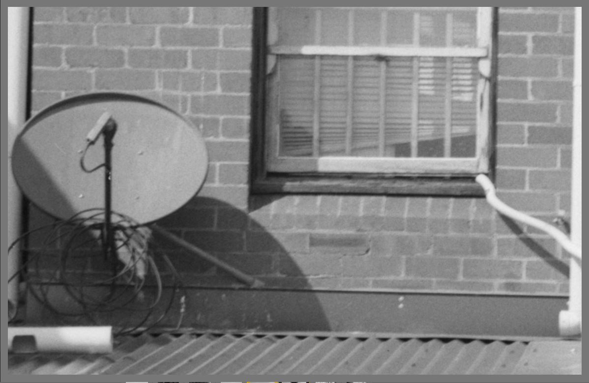

I developed the test roll. The results are much better than I expected. All images came out pretty sharp. I was hand-holding the camera and shot in bright daylight at 1/75 s around f11 and f16. Here is an example:
and 100% crop
The film is Ilford Delta 100 rated at about IE80 and developed in Rodinal 1:50 for 12 minutes at 20 degrees Celsius.
Looks like you're steadier than you thought. 😀
