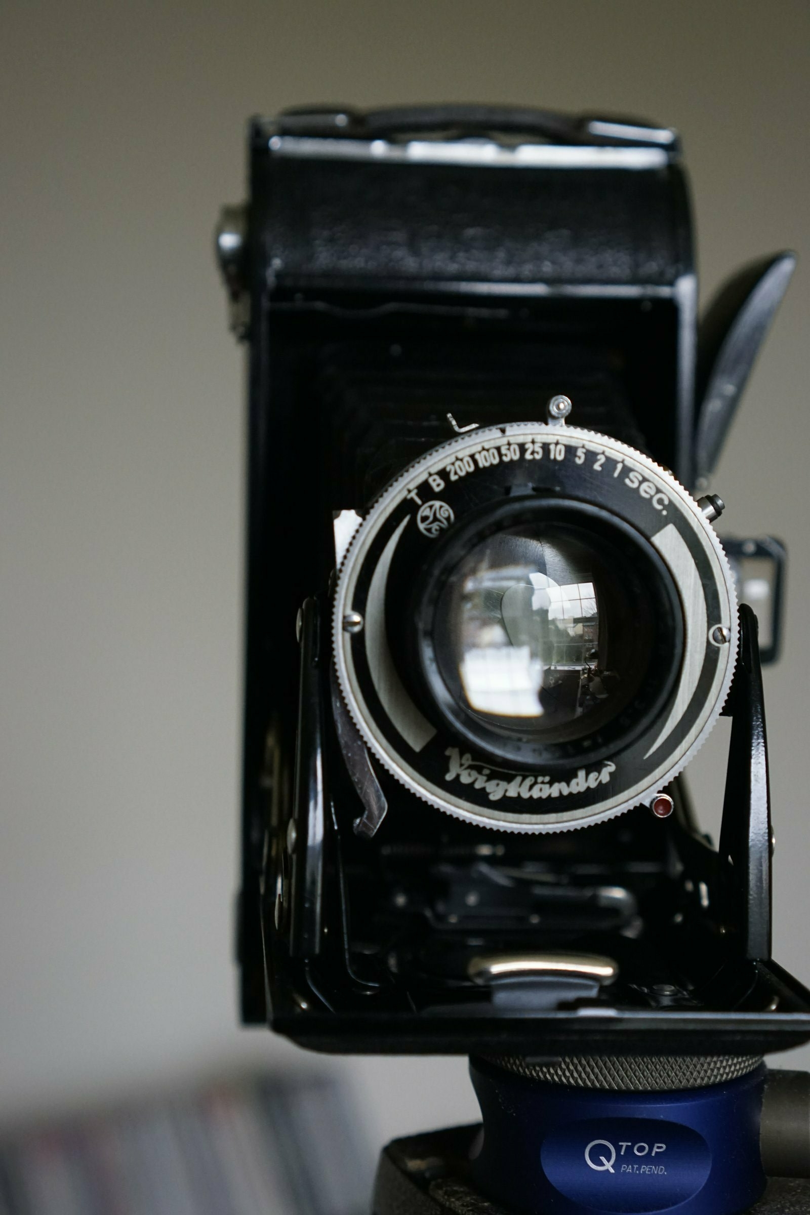

I have a Voigtländer Bessa produced around 1935. This model has the shutter release on the door and the finder without cover. It seems impossible for me to trigger the shutter without causing massive camera shake. I can't use a shutter release cable as the strut gets in the way. My shutter is the simplest model with two speeds: 25 and 75 plus T and B. The lens is Voigtar 1:7.7 F=10.5 cm. The body and the bellows are in a very good condition and it is a shame I can't use the camera. Any ideas?

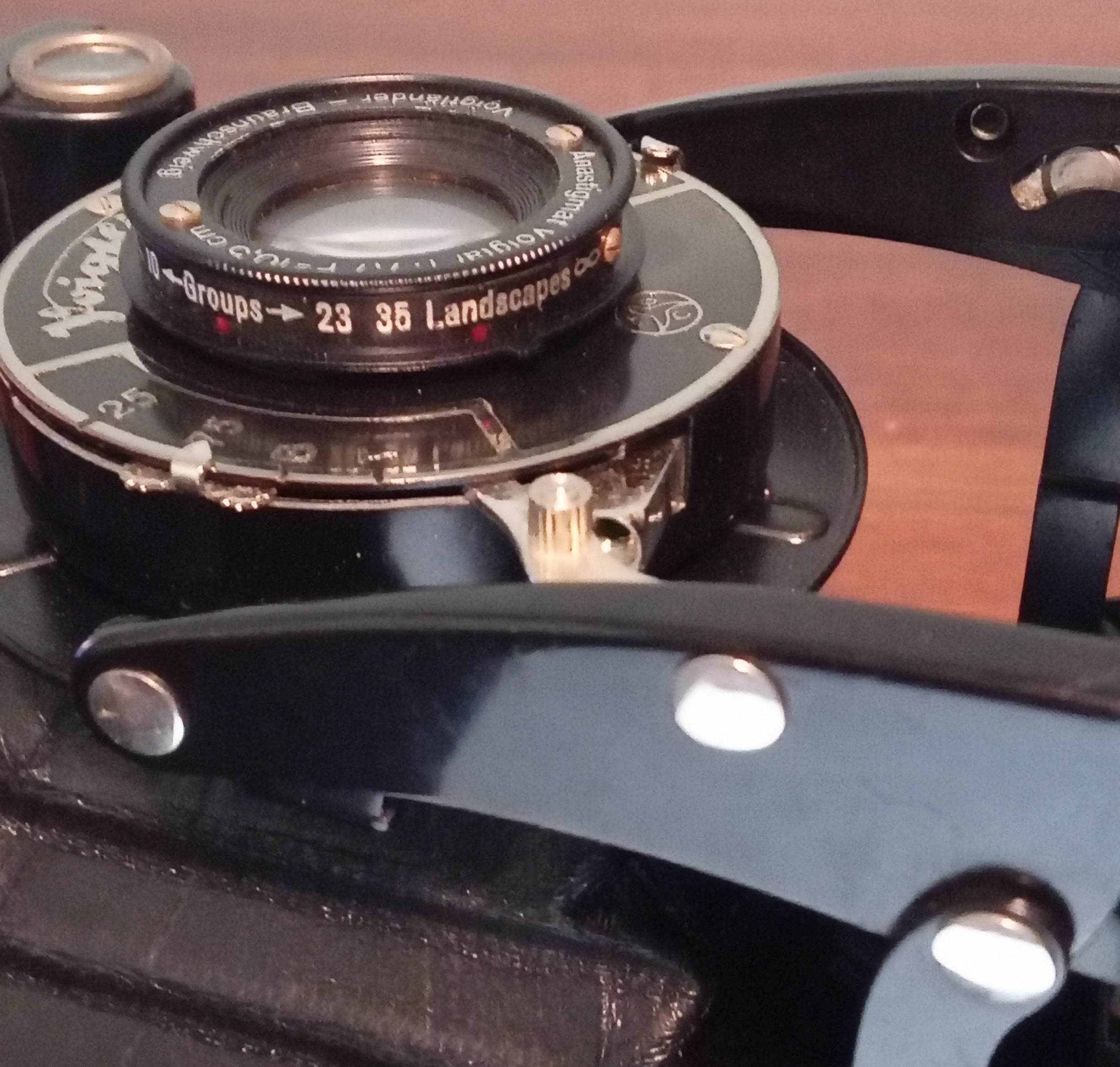

It is hard to see on the photos but the thread for the shutter release cable projects onto the middle of the strut. There is around 13 mm distance between the edge of the strut and the end of the cable mount.
Better shutters have the "Nipple" pointing up rather than into the strut.

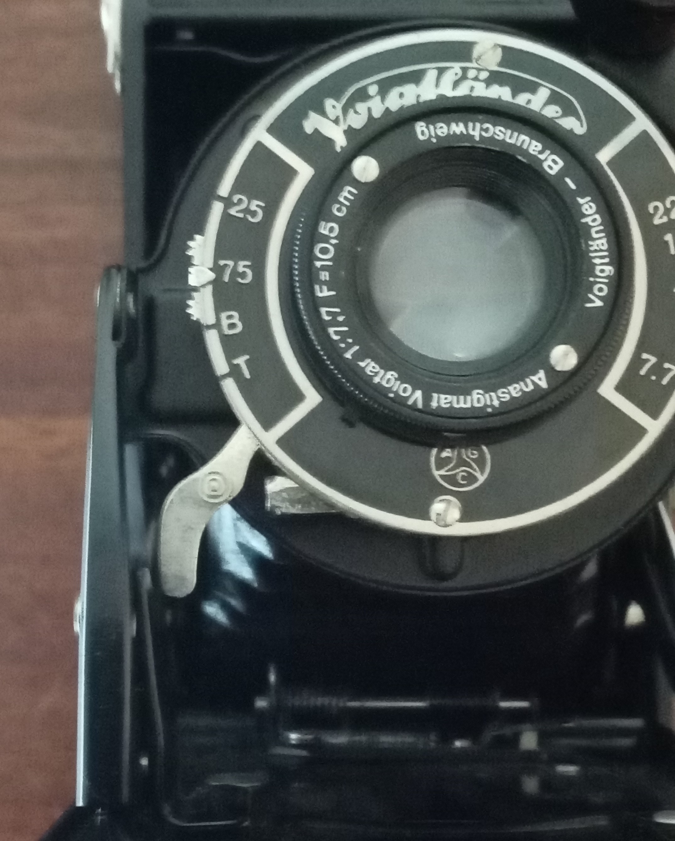

Given that Voigtländer knew what they were doing, I honestly think that the camera is not as it was originally built. My own Bessa is a later model (wartime, I think, as its components are not shown in combination in the catalogues) and the shutter configuration is at 90 degrees from the OP's. My photo proves nothing, of course; but it may be of some help. The lens is a 3.5 Skopar, by the way and the shutter is not a Compur Rapid (no 1/400").

I have the same Bessa as shown in this photo. Note that on Ronamko's example, just like yours, the shutter is oriented to display the Voigtlander name to view as if the camera is sat on a surface using the kickstand, just like yours does. So I doubt that Romanko's camera has been modified or the shutter rotated. It's just that the cable socket is poorly placed.
Romanko, are you absolutely certain that you can't sneak a cable release in behind the strut? It may be awkward, but surely it must be possible, as Voigtlander intended it to be possible!

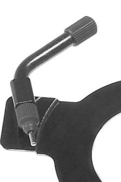

There are photos in the Camera-wiki pool at Flickr by Colonel Blink, showing Bessas with this shutter, one as the OP has it:
Code:
https://www.flickr.com/photos/thorpehamlet/11987706636/
and one with the speeds and the cable socket at the top:
Code:
https://www.flickr.com/photos/thorpehamlet/9263885232/
In both cases, as retina-restoration says, the Voigtländer name is upright, and the manual release lever is kept in the same place.
If it was my camera and I meant to keep it, I'd be tempted to drill a hole in the strut to pass a cable through!

The angled cable release is a great idea but I am afraid it would not fit. I thought I could use a very short (10 cm) cable release and try installing it semi-permanently by removing the shutter, attaching the cable and re-installing the shutter back into the camera.
