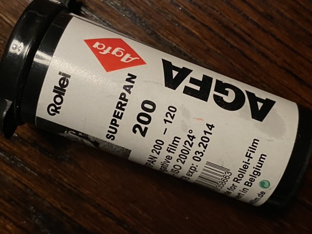

Just found an old canister for SuperPan 200.
Seems Maco had bought the right to use the Agfa name some years ago.
Even then, they still insisted on adding the Rollei moniker.
