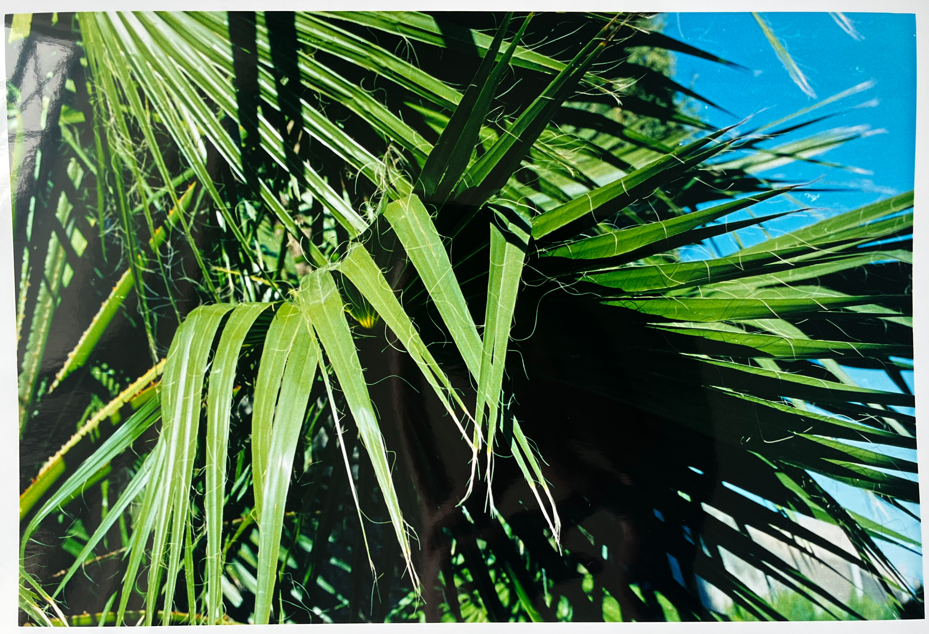

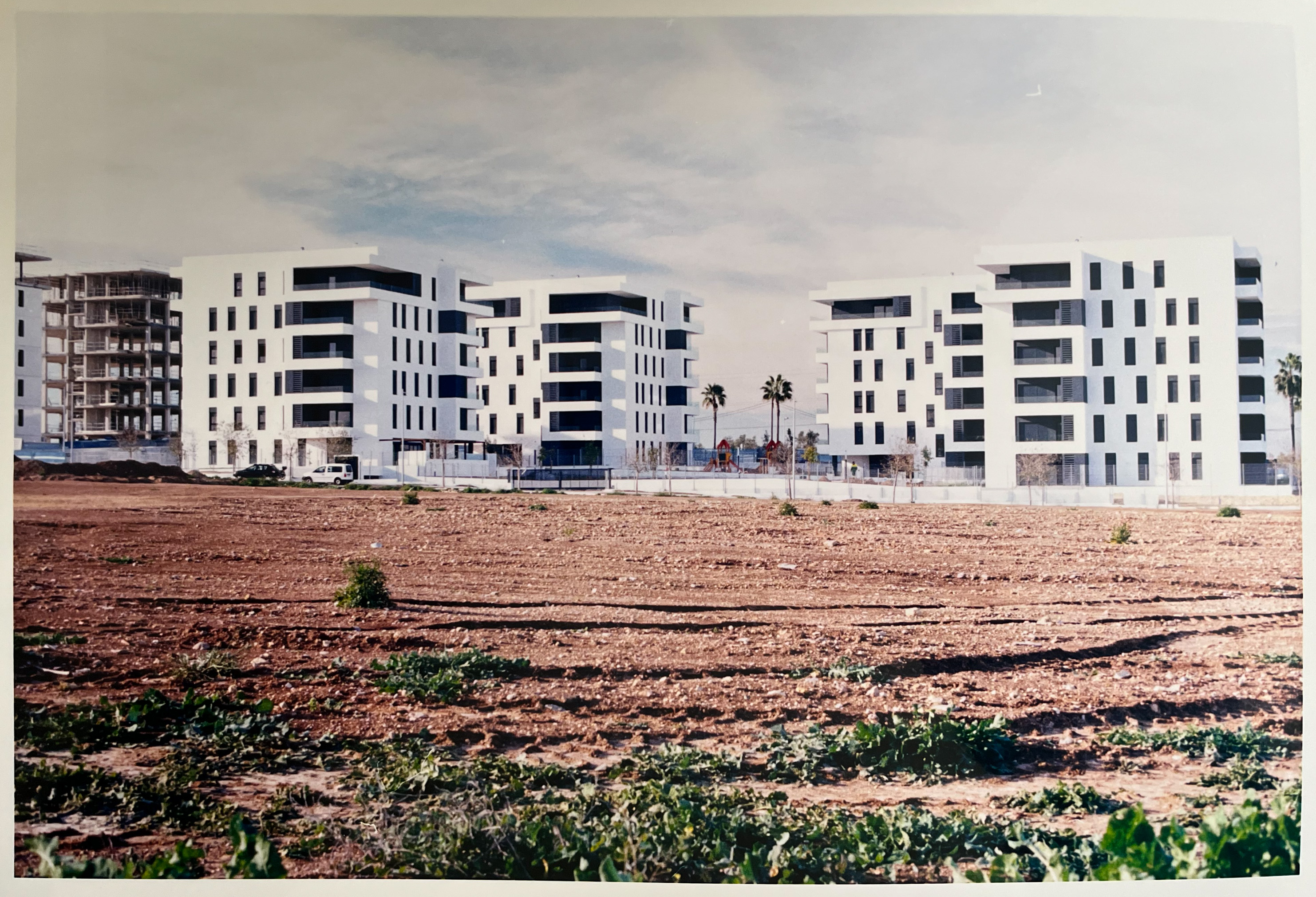

I also use a polarizing filter. The saturation of color increases a lot.
Some examples (made with iPhone 13):

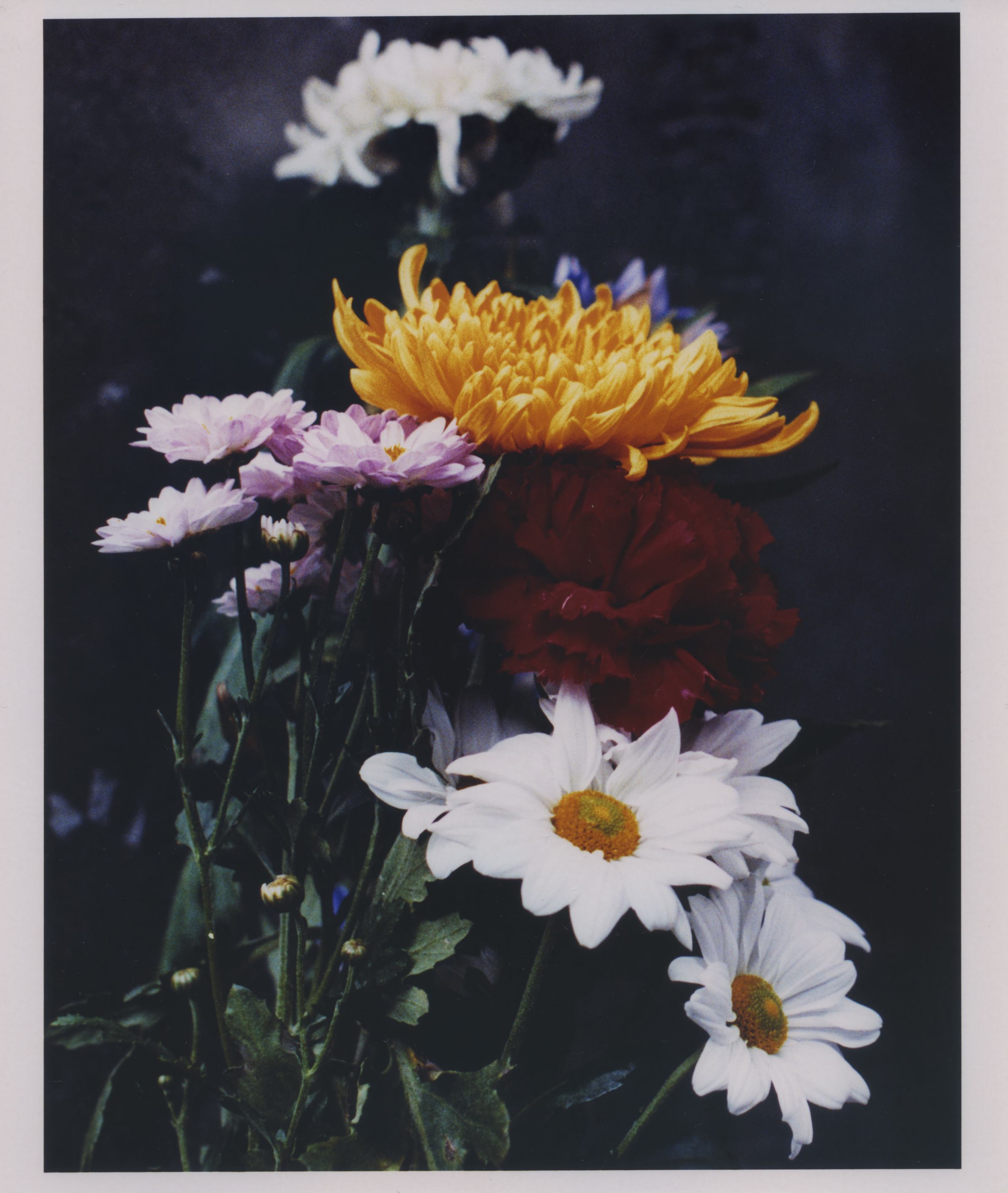

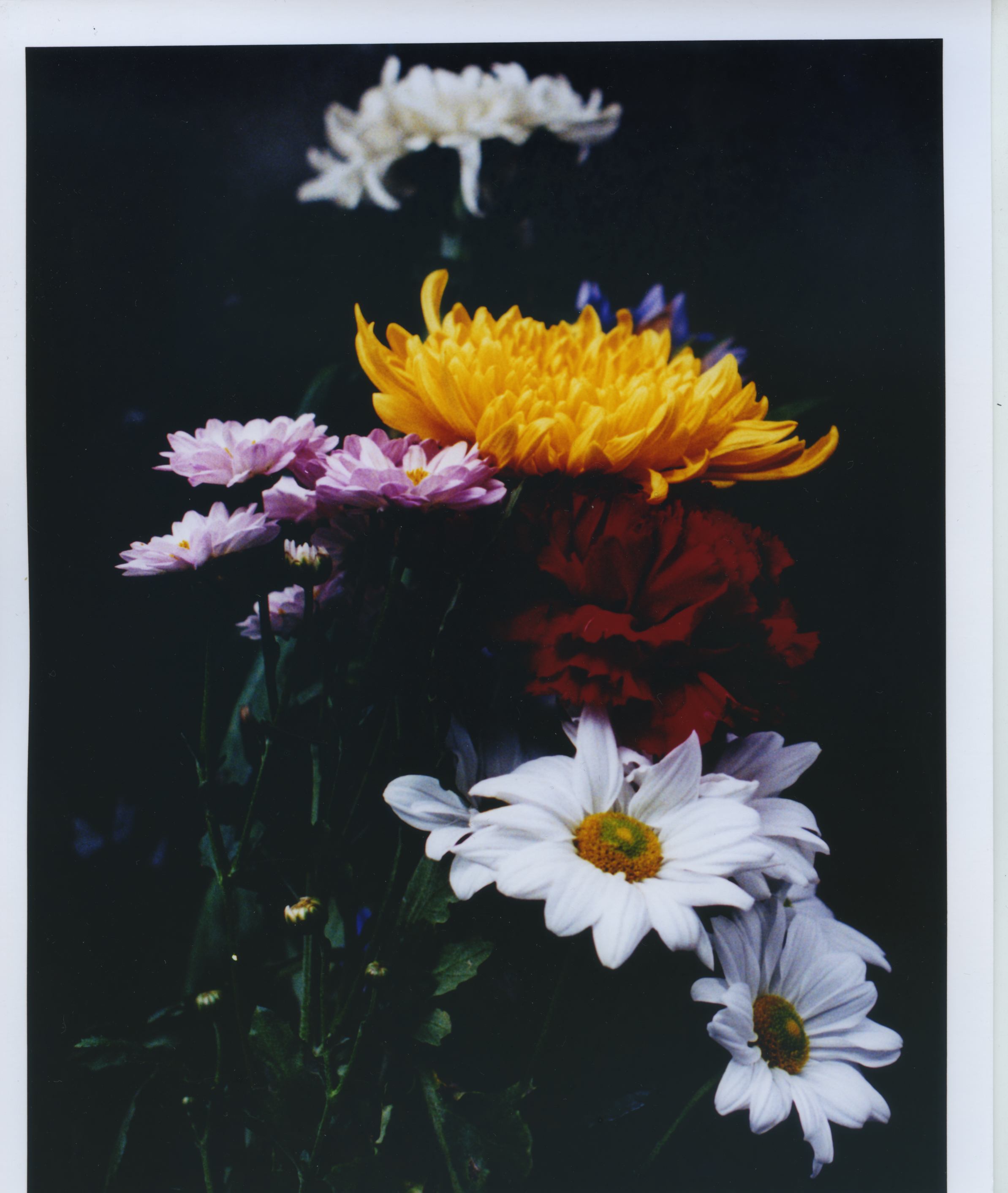

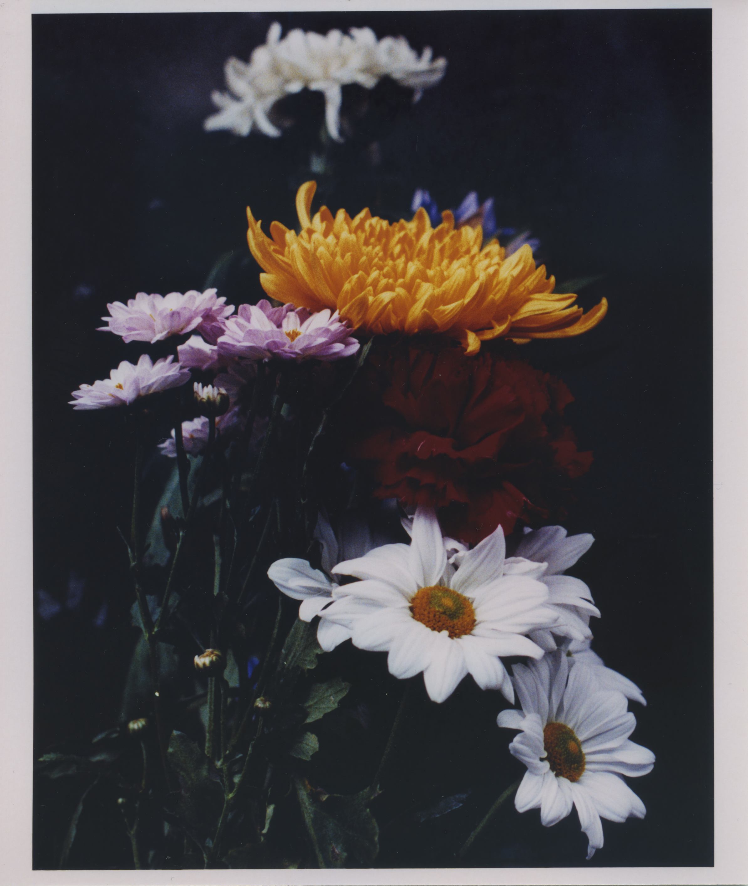

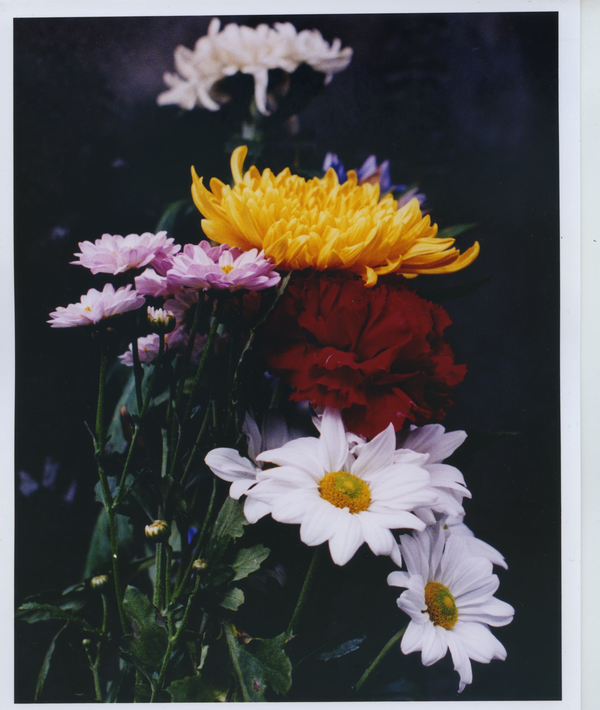

Here are the results of my comparison of fuji crystal archive glossy and fuji maxima matt.
For the tests, I've printed a cropped 135 fuji superia 400 home processed negative I usually take for colour balancing purpose. A little less boring than a colour test pattern, less precise also but enough for what I'm looking for. For those who care, it was taken with a Pentax LX and a 50/1,2 lens.
It was enlarged with a Durst L1200 equipped with a Heiland LED head. So it's RGB additive mixing instead of the more common YMC soustractive filtering. The lens is a 50mm APO rodagon N. The film-paper distance is 68cm (it's a crop so it's a quite high enlargement). The scans of the prints were made with an Epson V750, trying to make them as unprocessed as possible. I'm really not into digital and computers, so it may be another weakness of my tests but at least on my screen the results are quite representative.
To test for paper speed, I've tried to match the white daisy at the bottom of the picture. The white base of the Maxima is much clearer than the CA, so I was looking at the visible details, not the density. The contrast was then evaluated with the shadow details of the upper part of the picture.
For the colour balancing, once again I've tried to match the white daisy's cast (very slightly magenta) and the upper white flower (slightly yellow). I then watch how the other flowers and the green foliage “fall” and the cast of the upper picture shadows.
I have then made another set of test, printing the CA lighter (½ stop less) and trying to match the contrast with a post-flashed Maxima. I have used a simple diffusion glass under the lens and had to alter the colour settings of the flashing (less blue light). There is a faint magenta cast on the maxima. I left it like that, the purpose of that test was just to match the contrast.
Crystal archive 40.3'' at f5.6
Red:390/Green:276/Blue:225
Maxima 30.2"at f5.6
Red:390/Green:285/Blue:240
Crystal archive 30.2" at f5.6
Red: 390/Green: 276/Blue:225
Maxima
18" at f5.6 Red:390/Green:285/Blue:240
followed by a post flash (negative still in place and through a diffusion glass)
9" at f5.6 Red:390/Green:285/Blue:220
My conclusions are :
The Maxima paper is ½ stop faster than the CA. It's also more contrasty (much more obvious on the actual prints than on the scans) I would evaluate it as 1 full grade if it were B&W and it can be quite easily managed with flashing.
The Maxima paper is cooler than the CA. I had to add 9 points green light and 15 blue. that means removing some magenta and yellow on a standard colour head, around 12M and 20Y, but that's only my evaluation, according to the colour head I used before the LEDs.
The Maxima paper base is whiter than the CA. The CA paper looks almost fogged compared to the Maxima
The Maxima paper is heavier and the quality feel is very good. The « texture » of my matt paper is also beautiful.
But what really stands out is the colour saturation. Compared to the Maxima, the CA colours look washed out, almost un-bleached. Obvious on the red flower and the green foliage. On the yellow flower the rendering is also completely different, looking less contrasty on the Maxima. Some dodge/burn could have been made for further adjustment, but it was not the purpose of this test.
The Maxima is really in another class. That's not a surprise, it's advertised as « pro » compared with the consumer grade CA, and it's obviously seen. Nevertheless the CA can be useful in some occasion where a more « calm » rendering is needed. I am going to order some sheets of Fuji velvet to see how it compares.
VoilĂ , hope this can be useful to others !
This, combined with your experiences regarding filtering, suggests your CA paper may be old and indeed a little fogged. CA is as white as Maxima - as long as it's fresh. Once it's a year old or even older, it'll start to shift to yellow and the whites at some point will also start to become yellow.
A further explanation for the different filtration is that the Maxima paper has the same emulsion, but (much) thicker image-forming layers. As a result, there will be some (slight) light loss in the green-sensitive and especially blue-sensitive layers. Maxima also has a heavier top-coat and more effective UV-blocking, which I can imagine will also soak up a little blue light.
You're also spot-on with regards to your remarks about color saturation; I note the same when comparing e.g. Crystal Archive (and CA Supreme & Supreme HD) to DPII, with the DPII paper being significantly more saturated.
