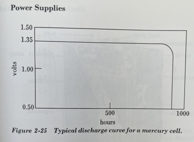

Depends on whether or not the Konica's circuits are voltage dependent. Most are, meaning that alkaline cells aren't very suitable.
No. Not for that camera. The original light meter circuit depended on the mercury battery as a 1.35 voltage constant, so the replacement needs to be a cell like the silver ones with a reasonably stable voltage until close to exhaustion. How will an alkaline cell serve this function? Alkaline voltage decreases as it is used.

I guess the light meter circuit in the Pentax KX must not care a bit. I've used alkaline, silver oxide and lithium...they all work fine. Although some do better in cold, winter weather than the others. Come to think of it, same is true for the Nikon F2 and F3...and Leica M6. Maybe, it's one of those academic issues that exists but doesn't really matter in real life.
I believe some of the earliest Pentax Spotmatics may have been designed for 1.35V mercury batteries. At some point - possibly around the the time of of the Spotmatic II - Pentax started using bridge meter circuitry which allowed later Spotmatic meters to work with 1.5V alkaline/silver oxide batteries. Certainly, by the time your Pentax KX was made, the owner's manuals were recommending 1.5V batteries.
So for you, yes, maybe it is "one of those academic issues that exists but doesn't really matter in real life." But for those of us who have cameras with meters that depend on a steady 1.35V for accuracy, your assumption does not match reality.
I guess I don't understand the angst. Have you analyzed the lightmeter circuit? Have you tried an alkaline cell? I'd try an high quality alkaline, do some tests. it might well be the case that it works fine with negligible to small error for long enough time (a few months maybe?) that you can live with the inconvenience of having to periodically check the meter against a known accurate meter or check the battery voltage periodically. What have you got to loose?
I'm mainly a Pentax and Nikon user but have owned and used Minolta SRT-101 and Nikkormat FTN - both of which use 625 cells. I believe that both were designed to use the mercury cells. I had both modified/calibrated to use 1.5v cells. They both seem to do fine with an alkaline cell. However, I do tend to keep a close eye on the alkaline cells because they bulge with age. I replace them before they bulge - which is long before they're "dead". So...maybe that's why I have not experienced grave inaccuracies. I also do not take what any meter says as the final word but rather as a suggestion....the light meter puts you in the ball park.
I also have owned and used all manner of Spotmatics. Truly, great cameras and fantastic optics. The light meter circuit is designed to use a 1.35 volt mercury cell in all except the Spotmatic-F. All of them work fine as built with alkaline cells.
Thank you. It's hard to break through sometimes.
Sorry, I don't mean to upset anybody. Your point is understood and valid....but neither of us has analyzed the light meter circuit. It might very well be voltage dependent but it might also use so little current that the meter is "accurate enough" for an acceptable duration of use. Of course, this requires the user to be vigilant. One needs to periodically check the battery or the light meter accuracy and likely replace the cell before it is "dead". Take the Minolta SRT-101 for example, the circuit is voltage dependent but it also has extremely low current usage and a built in battery check feature. In my experience with the one SRT-101 that I had modified/calibrated to use a 1.5v cell, it was "good enough" for a few months of regular use. Yeah, I had to keep an eye on the battery...not a big deal in my book.
I think it is, at minimum, worth some experimentation. I might work fine. It might work fine for a while and then be off by a half stop at one end or the other (or both). Certainly, it is going to be accurate enough right out-of-the-box with a fresh alkaline cell and there are no catastrophic consequences...so, the question is, how does the accuracy vary with usage? How sensitive or insensitive is the accuracy of the light meter to supply voltage and how does that voltage change with usage (which is related to current draw)? and can the user live with that?
I certainly wouldn't let the apparent non-availability of a silver oxide cell prevent me from using a camera.
