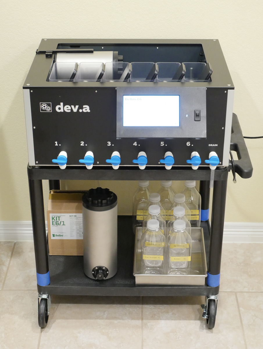

Jeff, I have a Dev.A machine and I’d be glad to share my experiences with it. The biggest appeal to me with the machine is its capabilities and capacities; it has six chemical tanks so it will handle a six bath E-6 process. Not all six tanks have to be used either, if the process only needs two chemicals such as black and white negatives, just two chemical tanks can be used. It will also process films up to 8x10. Primarily I develop 120 and 5x7 sheet, but I have been doing 4x5 and have some 8x10 ready to go. I did purchase my machine to use exclusively for E-6 processing.

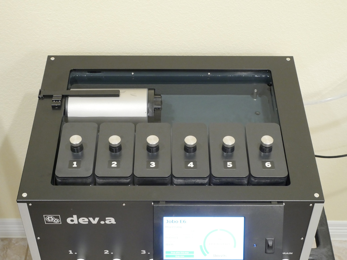

A super nice feature of the Dev.A machine as well is the touch screen. It makes setting up and programming the chemistries, times and steps very easy and quick. The instructions and documentation from the manufacturer explaining the features and parts of the processor is well done too.
I strongly considered the Filmomat and really liked what I saw, but the three chemical tanks meant I’d be stuck to three bath processes. That alone is what led me to the Dev.A.
After many years of hand processing color, I do very much like having an automatic processor simply as it’s precise and far more consistent. Temperature drifts when doing the films by hand always vexed me. I love being able to walk away from the machine and do other tasks while it does the work of processing the film perfectly.
One more thing—while the machines are fantastic and they save me time, there is a little maintenance that gets glossed over. Cleaning. You cannot leave chemistry in these machines. It’ll oxidize, stain, get gummy and that will be terrible for the internal valves, tubes and pumps. Leaving the chemicals in them for days or weeks thinking you can just turn it back on later is a bad, bad idea. At the end of the day when all processing is done, I remove the chemical tank lids, tanks, cores, reels and give them a good wash in the sink. Then all the chemical tanks get emptied and rinsed. Finally the automatic cleaning process of the machine itself, draining any left over water and drying it out with a towel. This takes me about forty five minutes. Do factor in cleaning time for these machines.

Jeff, it's a nice machine and I do enjoy using mine. Just did a couple of E-6 8x10 sheets this afternoon and they came out perfect.
