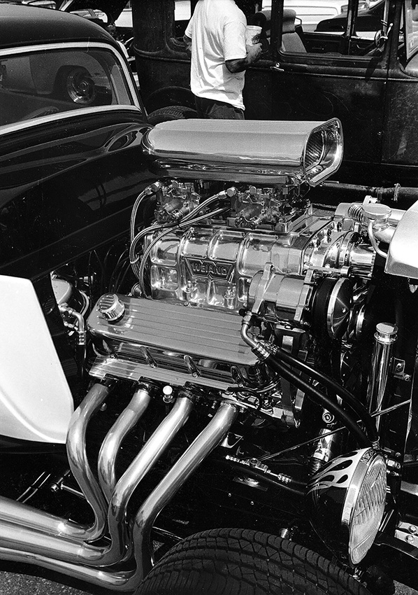

I've been getting an old scanner functioning on a new computer and happened to grab a few old prints. This one had me thinking that I could not only use 35mm more but a P&S can function well for some things. This is an old print from a Konica A4 on FP4+ in some early pyro experiments. I was walking around a large car show at the Minnesota State Fairgrounds and decided to pack just a pocket camera on a sweltering, long day. That little camera constantly amazed me but I actually used it very little as I would take more serious gear on typical outings. These cameras had troublesome electronics and I recall that it began running away on multiple exposures until it reached roll-end and got so I couldn't trust it. Quick scan (learning Vuescan) with no spotting, etc. but it reminded me of what a legitimate tool the little A4 could be.
View attachment 181960 I've been getting an old scanner functioning on a new computer and happened to grab a few old prints. This one had me thinking that I could not only use 35mm more but a P&S can function well for some things. This is an old print from a Konica A4 on FP4+ in some early pyro experiments. I was walking around a large car show at the Minnesota State Fairgrounds and decided to pack just a pocket camera on a sweltering, long day. That little camera constantly amazed me but I actually used it very little as I would take more serious gear on typical outings. These cameras had troublesome electronics and I recall that it began running away on multiple exposures until it reached roll-end and got so I couldn't trust it. Quick scan (learning Vuescan) with no spotting, etc. but it reminded me of what a legitimate tool the little A4 could be.
Very nice!
