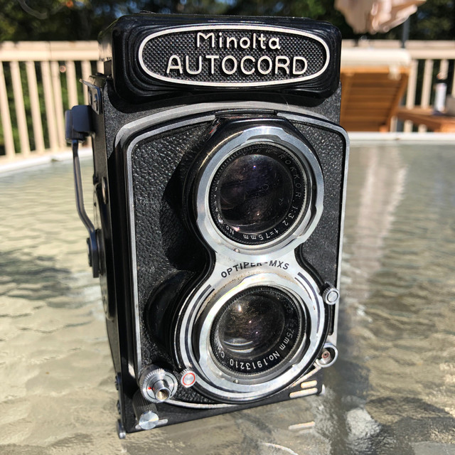

I recently purchased an Autocord off of Etsy. While the ad stated that the camera was being sold "As Is," the only negative item mentioned therein was that a part of the leatherette on the top plate was coming off. Here is the actual description provided by the seller:
"Up for grabs is a vintage Minolta Autocord condition is good there is some of the label on the top of the camera that is peeling. But there are no broken parts from what I can tell."​
No biggy, I thought. Upon arrival, though, both the shutter and aperture controls are stuck. I don't know if this is something internal, but the shutter control looks to be bent outward and is engaged to the metal ring about which it moves.
I'm thinking the repairs on this are going to be a lot more than just a simple CLA. Before contacting the seller, I thought I would come here and see what others thought. Despite it being sold "as is" the seller does have a 30-day return policy. In this case, being that there was no mention of the stuck levers--which even a novice should have noticed--I think I would have a good case for a return.
Thought?

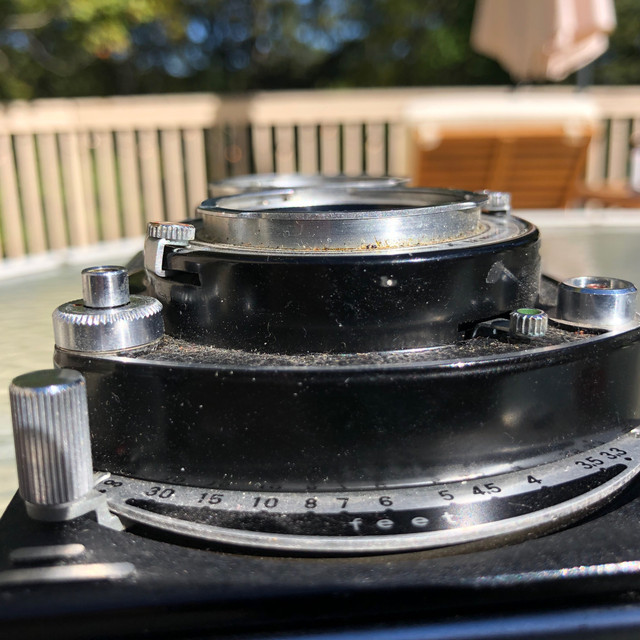

Post some pictures of the controls and lens.

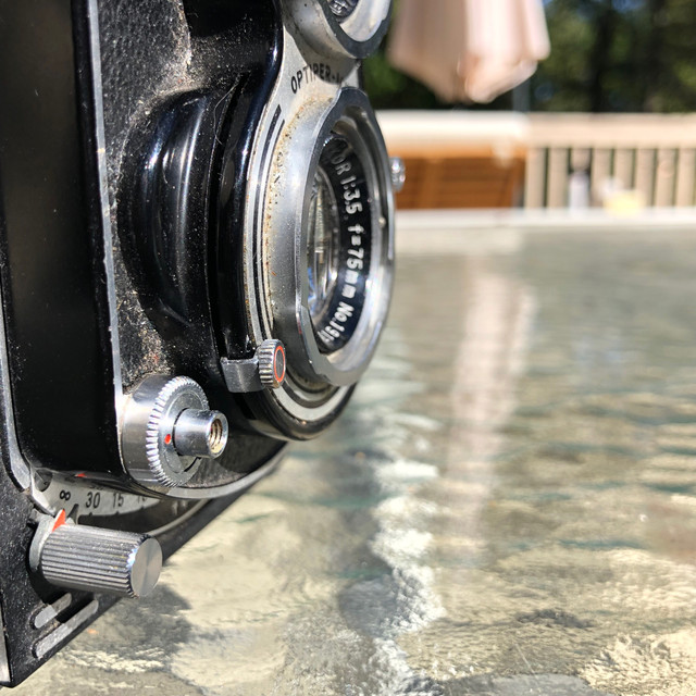

Second, here are the requested photos. The shutter control is the one on the left in the photos with the red circle on its face.
Notice how the shutter control is bent (lever on the left)
Another view...
I've only worked on a few TLR's, Graphic, Rolleicord, Rolleiflex.
The speed and aperture are not directly connected to the shutter. They operate gears and or levers that operate the shutter. The grease in the gearing dries out and makes the speed selection and aperture setting difficult to impossible. The speed selection lever may have been hit from the side bending it over, not a deal killer.
Shutter cocking is accomplished by the film advance, similar to a Rolleiflex.
Look at the shutter blades and aperture blades through the front and rear of the taking lens, rust, moderate to heavy, visible on the blades return the camera. Rust no larger than a pin head in a few spots is not a big deal.
Load a scrap roll of film or backing paper and try to run it through the camera.
https://www.butkus.org/chinon/minolta.htm
Baring rust a full CLA should fix this camera.
