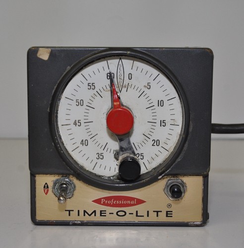

There was also the tiny Time-O-Lite (similar form factor to an old mechanical kitchen timer, settable to one second and self-resetting to the same time after shutoff), but I'm certain the contacts in those won't handle high power fluorescent ballasts (turns out there are multiple Time-O-Lite models newer than the ones I remember). For LED, they'd work -- but they've also been out of production for decades and it's hit or miss if you buy one on eBay, whether it still works.

One outlet is for the safelight the other for the enlarger, just plug into the enlarger outlet and it will do what you need. The Time-O-Lite is self resetting so when it hits 0 and shuts off the hand resets to the preset time. IRC the Time-O-Lite is only good to 60 seconds. The GraLab 300 timers are good up to an hour but lack the self reset and must be manually set every time.

I have two Time-O-Lite timers for sale in Photrio's classifieds here for $5 each. But these only go up to 60 seconds, and the OP needs 90, so he would need to set a Time-O-Lite to 45 seconds and start it twice (two exposures). He's running LEDs, so inductive flyback won't be a problem with any timer.
