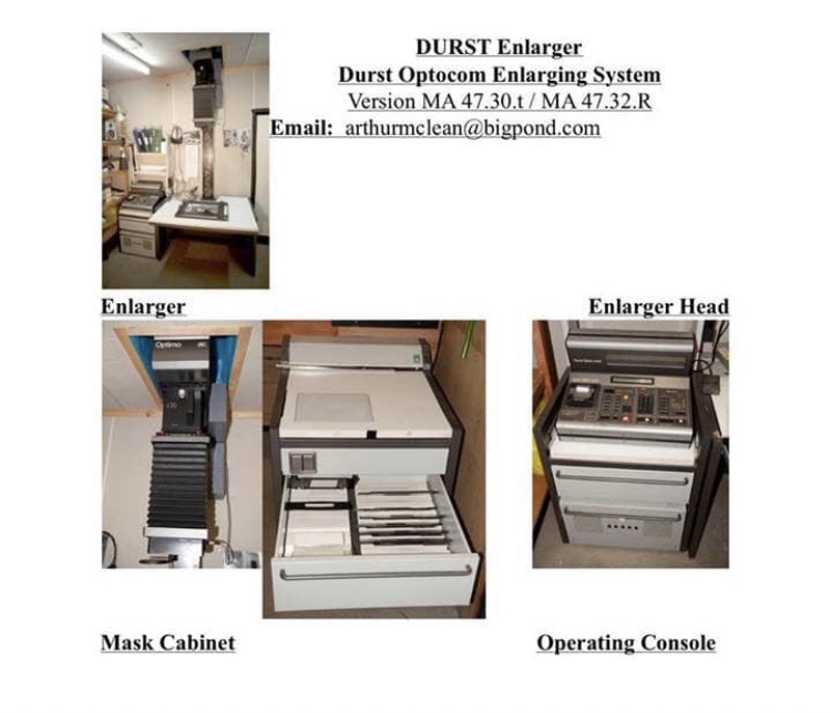

Just seen this one - not sure if it suits in any way?
Hi Anette,
I did see this infact Tom posted it only a few minutes after I put up a WTB. Was gone for a moment but people were already onto it, bit peeved about that...
But I am not sure if he ever got it going anyway, looks much too big and complex for me! Won't have room for all those bits and pieces :cry:
Search continues...
The opticom Durst is a computer controlled enlarger I that was designed around the l1200 frame for auto control.
It is way more complex than my AC800.
The Advertiser News paper had a AC1201 version in their darkroom in the 1990’s here in Adelaide
You don’t want it .......unless you intend to do a lot of custom prints with it and are willing to spend a lot of time programming it

John yes probably too complex for me!
