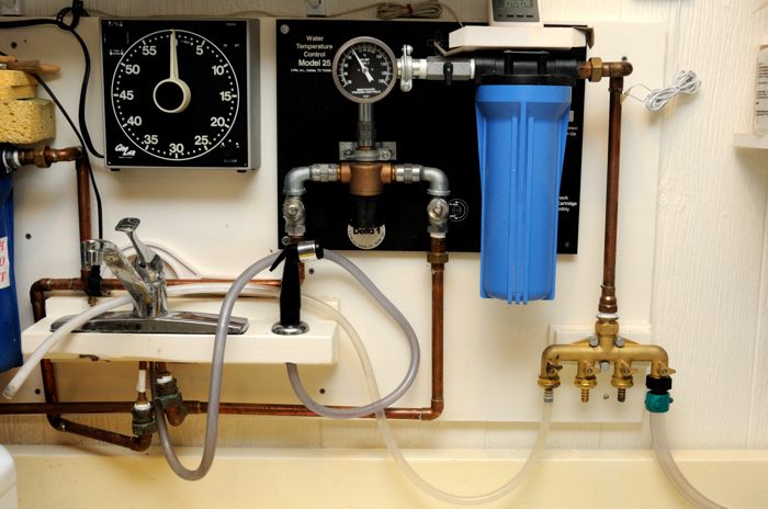

You can get an adapter from a garden hose fitting to standard pipe thread, and from pipe thread to a hose barb for rubber tubing.
I posted a photo in this post. Here I'm going from a shower to a Delta 1 temperature gauge, which ends in a hose fitting, and from that I've got a 4-hose manifold with different sized tubing fittings for different purposes (garden hose for washing trays and filling things, print washer, film washer, and small hose as a rinse for local bleaching and other finer tasks)--

I ended the water pipe (from the filter) with a standard water hose connection, used a adapter (from Harbor Freight) that gives 4 outlets, each with its own valve. Used the adapter from Lowe's that goes from water hose connection to a tubing, by sizing it right (or just luck) it doesn't need a clamp. I use one to go to the print washer, one for when washing film, plus have two spares.

Image of water manifold
Shows water hookups
