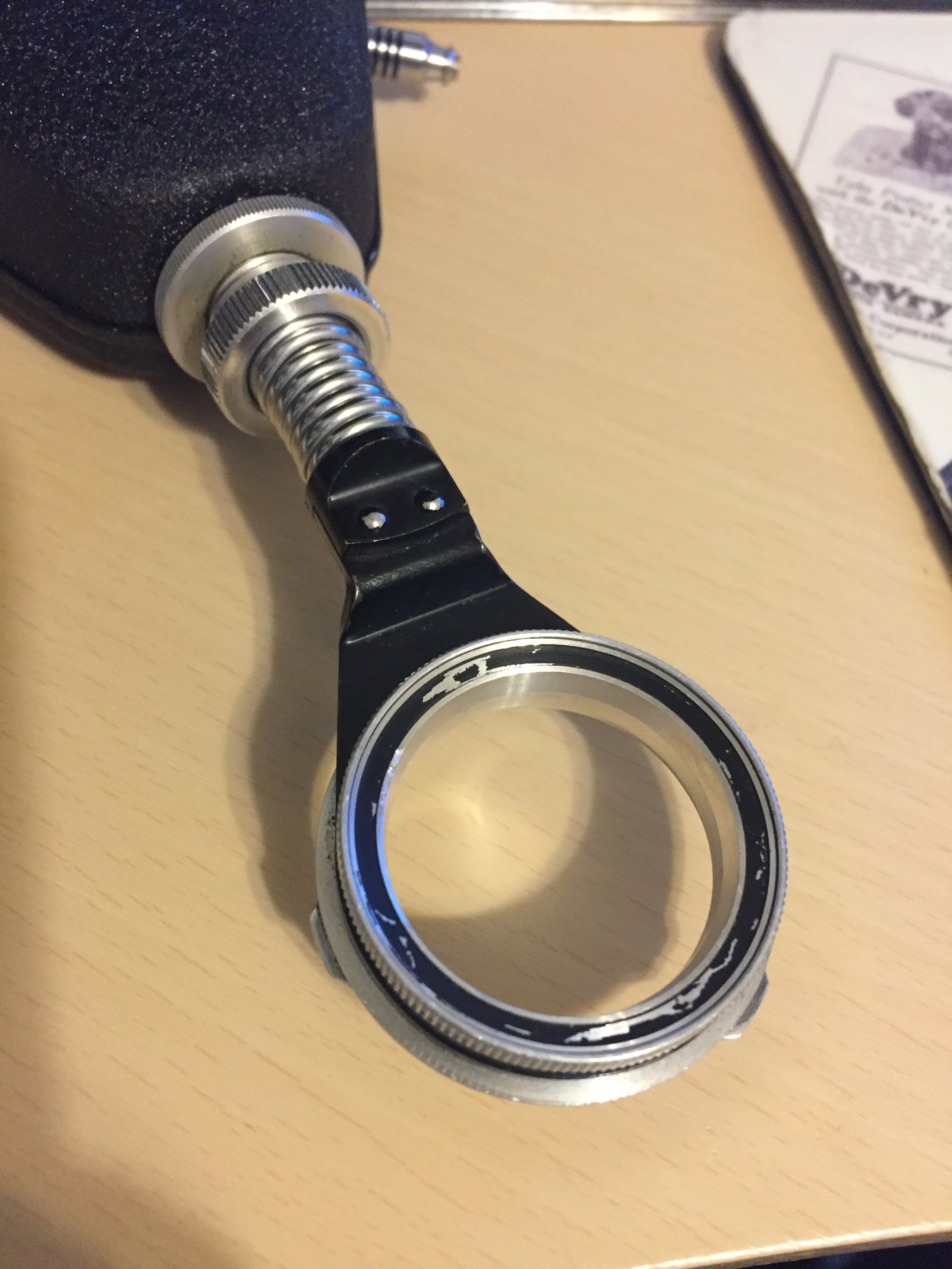

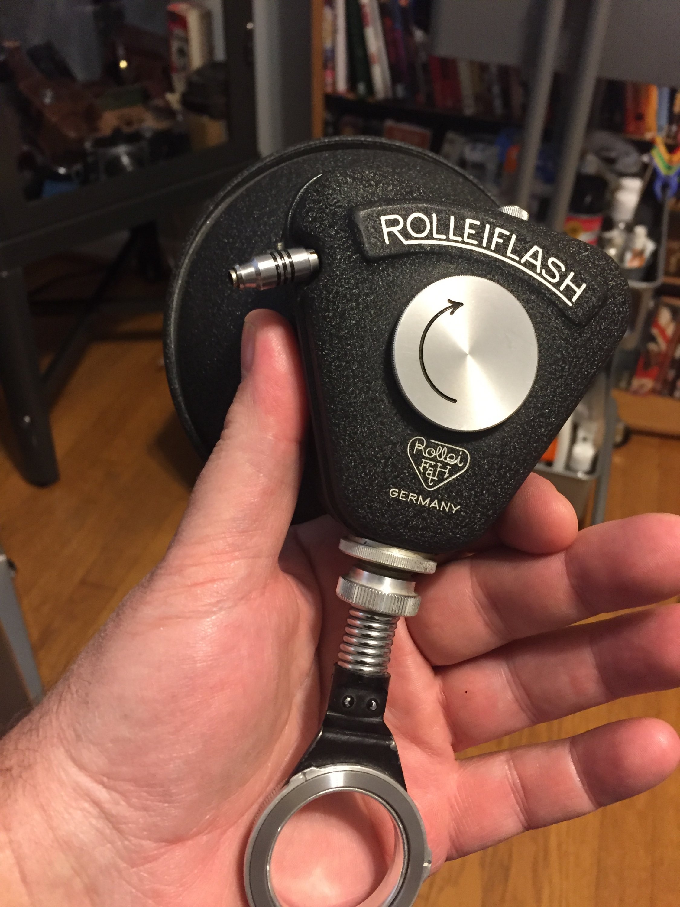

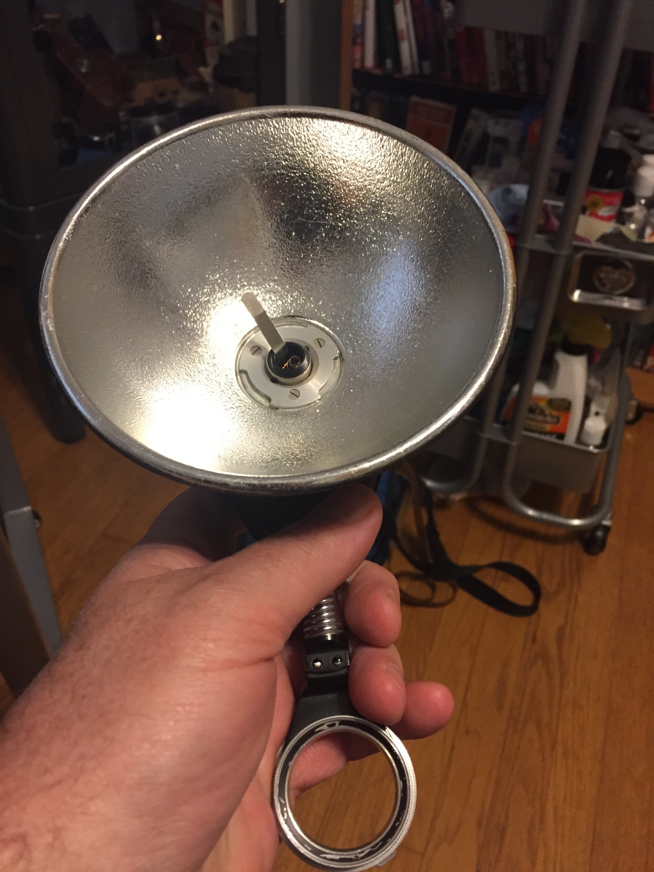

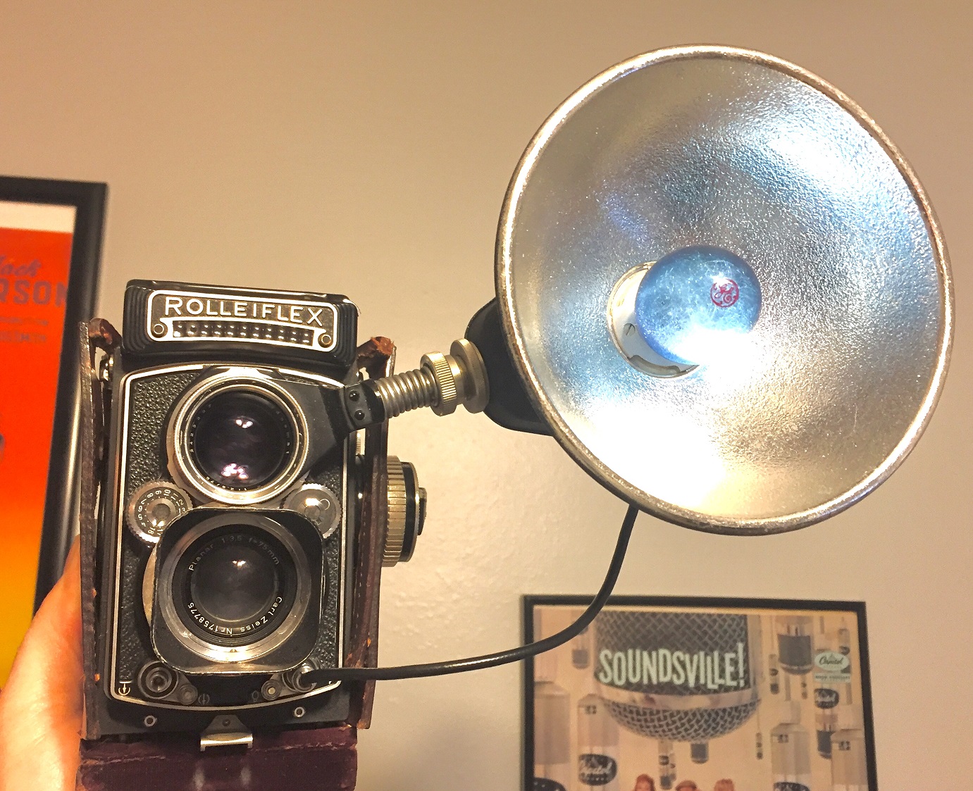

The original flash bulb-type flash attaches to the bayonet mount of either the taking or viewing lens and takes a funky (but still available 22.5 volt battery). I do believe the MX is a Bay 1 size; there is 1, 2 and 3 for Rollei TLR cameras.
Most sellers on Ebay are clueless as to what size they have, so be prepared to be disappointed unless they specify which size attaching arm comes with the flash gun. Of course, the flash head unscrews from the attaching arm, so any size Bay adapter can be used with the flash gun, but finding the right size took me about three purchases. Luckily I have Rolleicords that work with my "failed" attempts.
Rollei did make a strobe version of this unit, but they are harder to find and the electronics are getting quite old, so they can be a gamble for reliability.

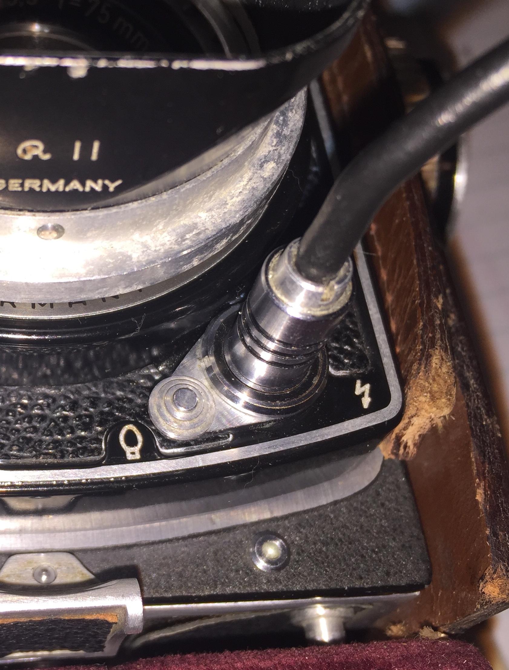

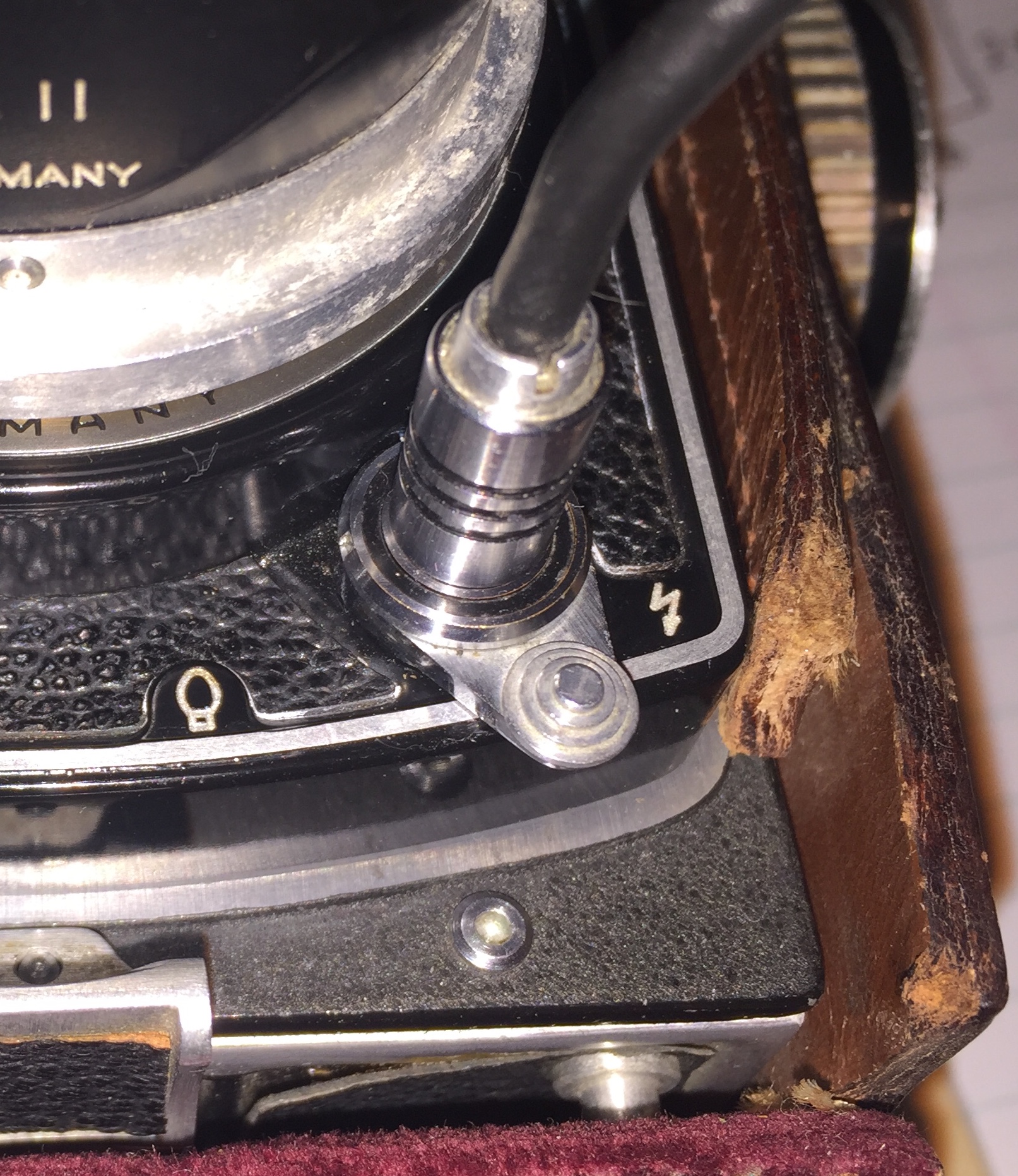

Of course, you can use a common flash bracket in the tripod screw and have the flash "outboard" on a hand grip, but you will have to purchase a Rollei flash terminal adapter as it is not a standard PC connector on the camera.
The easiest option would be to purchase a Rollei flash terminal adapter and use a bracket mount "potato-masher" style press strobe like the Sunpak or Metz variety. The added bonus is auto exposure on some dedicated models of these strobes with the right set-up.
One more thing...
You need to know that when you go to plug the flash cord into the camera, the switch MUST be in the center position to allow the plug to slide in or out.
THEN you turn the switch to the desired position, bulb or electronic flash and two rather fragile looking wires lock the plug onto the camera body.
Failure to place the switch in the center position when you attach or remove the plug can result in a damaged locking mechanism!

Thank you so much for all your information, I cannot believe how helpful you have been! I will look for the bay 1 size on ebay. I have an excess of the bulbs that I need so I'd really like to keep everything analog if possible (which now I feel ready to move forward with a purchase). I couldn't even visualize how to attach the flash so those images are super helpful. But like you said, it has a lot of "pros" lol! I think I may get one just to have in my collection but then look into a Sunpak just for reliability and multiple frames since I only have enough for two rolls of film (I just really love the little burst when the bulb is fired and then the smell afterwards, it's like magic to me haha).
