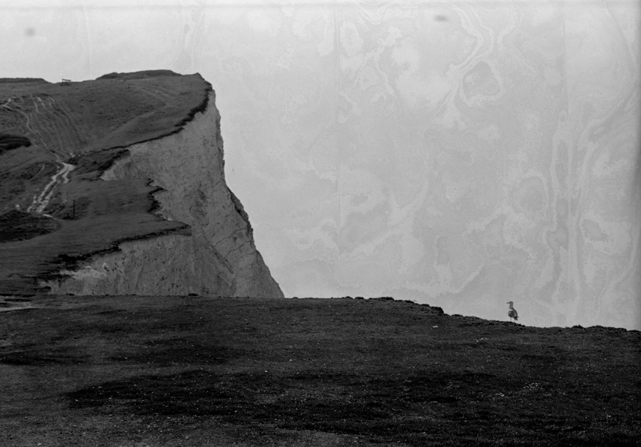

As you might have read in the previous thread I shot some ATP and developed in HC110 and Rollei RLC. Did the same with the Kodak TP.
Something strange happened with the TP and ATP in the RLC developer and I'm not sure what it is. It looks like some sort of liquify-photoshopfilter applied in the unsharp parts but it's in the negative for sure. I first thought with the TP that it had something to do with its too short development but then I noticed the same thing to occur with the ATP as well... I really can't explain it.
First batch:
ATP & TP developed for 6 minutes in Rollei RLC. ATP treated as a 40 asa, TP treated as a 25 asa. TP really underdeveloped so the contrast has been a bit enhanced in photoshop. I think it will be quite printable though as the "effect" looks pretty cool to me so I'll definitely will give that a go.
ATP has not been photoshopped except for dust removal and I made the landscape photo a little darker.
Second batch:
ATP and TP developed for 5 minutes in HC110. Same asa values. ATP a tad overdeveloped as I lost some detail in the highlights. No changes in photoshop except for dust removal.
The grain seems with both films a lot less when developed in HC110 then in the RLC but maybe I did something wrong...and I'm looking at scans...
I will post some impression pics:
ATP in HC110:
TP in HC110:
ATP in RLC:
TP in RLC:

Looks almost like some kind of funky reticulation.

It might be a lack of agitation effect.How did you agitate the film?
The pyrazolidone type developers are subject to this, it is mentioned in the Film Developing Cookbook.
5 seconds every 30 as with every other film I process.. Have to check about the pyrazoli-something developer you mentioned...have never heard of that...
Yes Terry, I have seen the photos from Fotohuis, that's why I got even more surprised... have to try a second batch and then maybe..well...I don't know. I first would like to know where this comes from. I just bought 9 films to take to Berlin and I woudn't want each of them to end up like this. I mean, it's pretty fun for a time but not with all films.
The images are posterized.
I would take a guess that you have drastically underdeveloped the negatives, scanned them so that only a few levels exist in the scans and then expanded in PhotoShop. The scanner you are using probably, like most scanners, doesn't deal well with very limited dynamic range source material. So yes, you have in effect put the images through a PhotoShop filter.
What do prints - real analog ones made in an enlarger - look like?
For scanning problems you might want to take the thread to http://www.hybridphoto.com/forums/home.php.

The Kodak yes, has been underdeveloped but the ATP for sure not.
Believe me, this IS in the negative itself. I really couldn't believe what I saw and blamed the scanner at first, which I couldn't really believe either as I've literally seen thousands of negatives scanned with it and not just mine and have never seen anything like this before, so took a closer look at the negatives and to my surprise it's really in them. My boyfriend took a look as well as he couldn't believe it himself.
"What do prints - real analog ones made in an enlarger - look like?"
Sorry... :confused:
You mean like, what do they look when being printed through an analogue process..? I don't know, I haven't tried just yet but when I have I certainly will post them.

I like Bob F.'s answer. I'm not sure what causes it either as a chemical effect. Solarol is a print developer designed to produce this effect chemically.
Did you develop the two films together in RLC or reuse the developer? Maybe there is something in these two films that combines to form a fogging agent that is effective in RLC but not HC110.

It looks like a phenidone problem. They had the same problem with POTA but overcame most of that with brush development, so I've read.
When I first used H&W with Agfa Copex Rapid I got this
http://www.flickr.com/photos/11040255@N04/2203188844/
Further reading of the instruction sheet said that if you had this problem then instead of 60 secs you should give an intitial 90 sec agitation.
They specifically mentioned skies and broad areas of single tone.
A possibility, if there's phenidone in the Rollie developer.

Thanx for your visible input although it's hard to see on the image if it's really what I have. I can't find anything about Phenidone being in the Rollei developer so can't rule that out.
The mentioned broad areas of singletones..in my photos it also happens when there's actually more tone as well, it's just visible in the unsharp parts so I'm not sure.
I just emailed RoVo and got back a list from what's in the RLC:
Dangerous components:
Name: - % - CAS-No. EINECS-No. -Symbols
Hydroquione - 3 - 123-31-9-204-617-8 - Xn, N;
R 22-40-41-43, 50
Sodium Hydroxide - 1 - 1310-73-2-215-185-5 - C;
R35
Sodium Carbonate - 8 - 497-19-8-207-838-8 - Xi;
R36
Other Informations: Main component = water
It looks as though it has been solarized. My collegue mentioned the same thing. I developed the 2 films together and used no stop as recommended in another thread. I fixed for 2 minutes, maybe this was too short..?
Funny thing is that somehwere else on a spec-sheet I read that stop was needed and water in between was not sufficient. Maybe something went wrong there?
Still merely speculating as I'm still kind of clueless.
I'll try one more batch soon and use stop, use demi-water for the developer and see if the problem goes away.
Thanx to all for your input so far :smile:

Another phenidone example.Here's ATP in H&W Control wrongly agitated only once per minute:
Thanx. That does seem to look like it...too bad I can't seem to find a conclusive answer to whether this Phenidone is in the RLC or not.
I read it's advised to continuously agitate the first 30 seconds and than 5 seconds every 30. I'll give that a try next time. Maybe that'll solve it...

I think they would have said so if phenidone was in the mix. Avoiding a direct question like that would be a poor PR move.
In that case it really does look like solarisation, I must admit. Pity we don't know why, as it could be a tool for somebody wanting the effect. (which is not unpleasant, unless you 'don't' want it!)

Thanx! If the RLC contains the same ingredients as the DC than most likely I'm dealing with the Phenidone issue here. That would be nice because than at least I know where it came from and it should not be too hard to reproduce when desired. Next batch will be the conclusive answer I guess.

I talked to Rovo a bit about the development and he said skipping the stop bath is not necessary.
The dillution as mentioned on the bottle of developer is 1+4. I thought this was a little too heavy and later on found out that I wasn't the only one with this assumption. Therfore they advised a dillution of 1+5 or even 1+6, depending on personal preferences of course and desired results.
Agitating, the first 30 seconds continuously and after that 5 every 30 seconds.
This is the way I'm gonna do my second batch of ATP in RLC. I'll report back when I have finished it (will not be today but hopefully somewhere this week).

Well, finished the second batch and the problem is still there. I'm really dissapointed as to I don't know what to change with the next session. Berlin is in one and a half week and I'm not really looking forward "screwing up" the rest of the films too.
I'll post an example pic, don't take the photo seriously as the negs are underexposed due to a failed experiment....
I dilluted the developer with demi-water this time. Treated them in a room with hardly any light. Agitated continuously the entire first minute as I forget the first 10 seconds and after that 5 every 30. Kept the dillution 1+4 as I expected my negs to be underexposed in order to compensate a little.
No stop used again as advised on the datasheet, which I'm gonna do next time as that's the only thing I normally do and didn't do now.
Dilluted the fixer 2x more than normal.
I'm really clueless and sad my experiment failed.
I just sent Rollei an email to see if they can help me out. I really hope so. I would like to get this film to work properly as it does look really promising.

It's strange,you seem to be following the instructions and these are pretty similar to tech pan in technidol,see under processing here:
www.kodak.com/global/en/professional/support/techPubs/p255/p255.jhtml
All I can suggest while waiting to hear from Rollei is to try continuous agitation for the entire time,inverting the tank every 10s. Works for me with Copex Rapid in H&W Control.

I'm like WTF??? Is my letter that unclear?? If they can't provide me with a decent answer I'm really clueless...
I already emailed them back telling them that the negatives that I sent them are developed in the RLC developer and the ONLY reason I mentioned the HC110 was that the OTHER ATP's developed in it came out fine. I'm really not sure what information is missing at this point..
