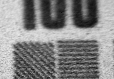

My first result with ATP,exposures of a sun/shade contrasty subject.
EI 8 Rodinal 1:200 15 min 68F Agitate 30s then every 2 min.(2.5ml rodinal->500ml).
A proof print shows no defects.
Microscopic examination of test chart negative shows 100 line-pairs/mm.

100 lp/mm with what contrast of test chart? 1:1000? 1:1.6? or some other?
-j
My test charts are ordinary black print on white card.I used the Canon 50mm 1.8 EF. This type of film outresolves the lens.The attached photomicrograph made earlier gets the same 100lp/mm result with Copex Rapid.It shows a photomicrograph of the negative of the test chart round the 100 lp/mm section.
