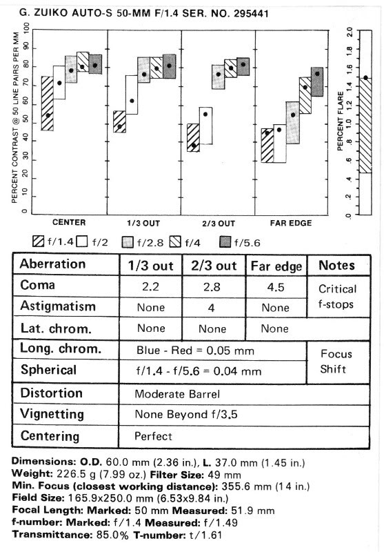

Can you help me reading the graph?
The vertical bars represent the range of all the 35mm format lenses tested of that focal length (50mm). The black dot is the Zuiko. So as you see, the Zuiko is about average resolution in the center of the frame but better than most of the others near the corners.
Thanks!
The dots in this graph (post #6) indicate the value yielded by the very lens.
The collumns indicate the range of values of all tested lenses.
Likely the most common believe is that there is one certain aperture for a certain lens where reduction of lens abberations and rise of diffraction are at equlibrium concerning their effect on imge quality. And that this aperture yields best results at center and samewhat lesser results off center, though there still being the best.
This way of making a graphic though shows well, that this not necessarily so. As for this lens for most subjects one rather would close the aperture one stop more then being the optimum for the center.
But things can be driven even further and not even incliuded in that graphic. As one not only may differenciate between center and off-center, but also between radial and saggital structures..
Whether this fine differantiation is academic or yields significant improvements is to you. But I think it is at least good to know about this, when doing own testing.
