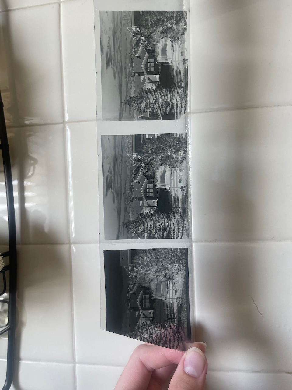

This was a test I did to see if striping the antihal off the film does anything (it doesn’t), the bottom shot is EI 100 without an IR filter developed in D-76 stock.

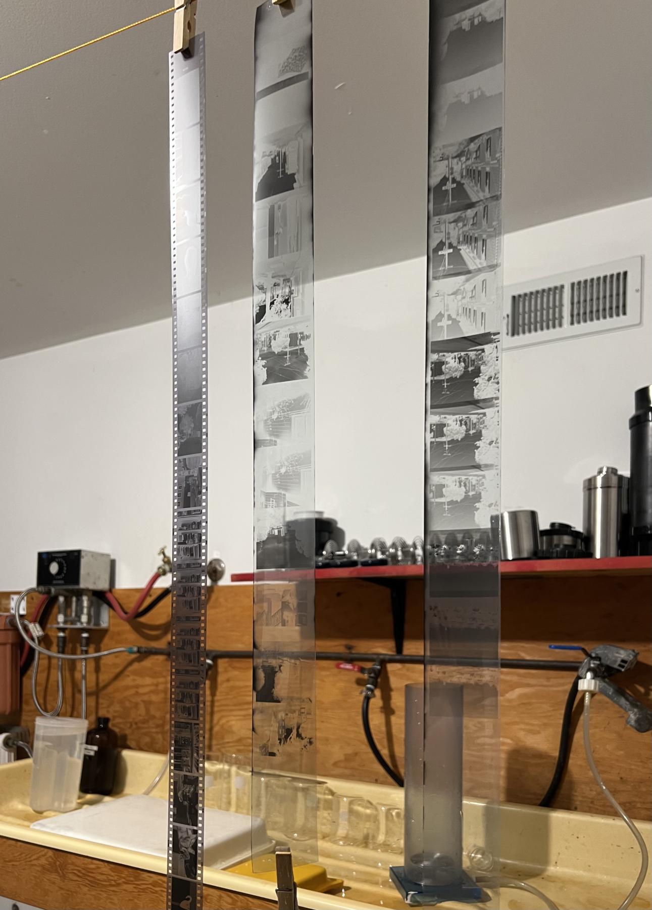

Middle roll here is at EI 100, D76 1+1, 12 min (the HC110b roll looks the same). The fogged edges have substantial density but almost nothing else does except overexposed sky. No filters used.
Rightmost roll (D76 stock 7 min 20C as suggested) is bracketed at EI 25, 50, and 100 - you can see the 50 is just getting past the toe and the 25 is probably pretty usable.
I wonder if the 46mm bulk film that was used for the 127 rolls was from a different supply than the rest of the film from Astrum. Looking at this I feel like it must either be a different film, or very old, but I don't see other signs of age like changes toward the edges, or mottling.
