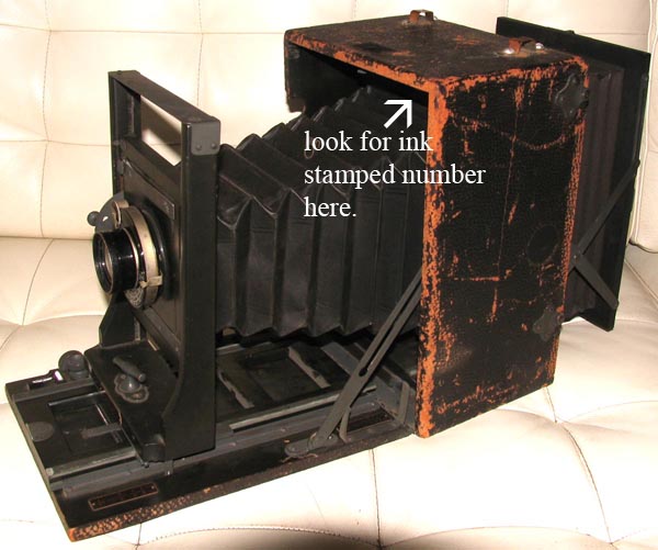

Serial number on Speed Graphics was under the top of the camera. Graflex corp. used this position on their cameras that had a bed.
attachment.php
