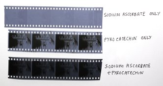

I made up 3 developers as given in the following formula,except that as developing agent one had sodium ascorbate only,the second had pyrocatechin only and the third was as given.All had 5g Carbonate.
Sodium Ascorbate.......................10g
Pyrocatechin...............................0.2g
Sodium Carbonate anh...................5g
Water to.....................................1L
Fomapan 400 was developed 12m 21C ag 10s/min.Resulting negatives are shown in fig 1 attached.
With sodium ascorbate alone there was insignificant development.
Pyrocatechin alone gave a contrasty image with tanning of the emulsion (verified by bleaching in ferricyanide/bromide and fixing to give the relief image).
Pyrocatechin plus ascorbate gave the densest image.There was no tanning.

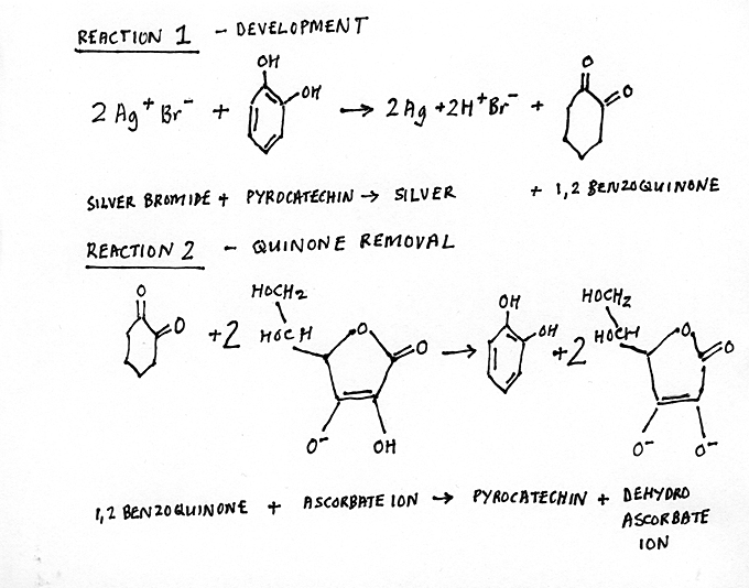

Referring to fig 2,reaction 1 explains development by pyrocatechin.It is the quinone that causes tanning.
How to explain the greater density and lack of tanning with pyrocatechin plus ascorbate?
My explanation is that lack of tanning is due to absence of quinone.This also increases the density by driving reaction 1 to the right.Absence of quinone is attributed to its reaction with ascorbate .It is regenerated to pyrocatechin.Ascorbate is converted to dehydroascorbate.This is shown as reaction 2,fig 2.

It seems to me that your reasoning is correct. From old data, Ascorbate did decrease oxidation and did react superadditively with other developing agents.
However, your equation as drawn in figure 2 is just an ionization when it must involve a redox reaction to be drawn correctly. To go from the quinone to the hydroquinone is a reduction, but to go to the dehydro ascorbate as drawn, there is only an ionization step.

In fig 2 my ascorbate ion has an H attached to its bottom right foot which it loses to react with an O from benzoquinone,hope that will do.
I don't think Photo researchers got around to investigating regeneration of quinones by ascorbate but others have reported some near misses.The link (need to register to read the full free paper) refers to the production of hydroquinone at pH up to 4.87 (I used 10.6) by the reaction of 1,4 benzoquinone with ascorbic acid.

You are correct in theory, but in practice, a covalent bond ph=O is not reduced by H+. H+ is already oxidized and so Asc-OH cannot go to Asc-O- and H- and reduce the ph=O to ph-OH. Hydrogen gas, a strong reducing agent, will do that trick nicely but H" is in the wrong oxidation state.

Thank you for noting this.I think it is needed to register and download the paper in the link to get what is probably the correct version of fig 2, given in the paper as scheme 1, and of course it has to be altered from production of hydroquinone to production of pyrocatechin.It's still reduction of quinone by ascorbate ion though,so my other comments are not changed.

Oh, I agree. Your comments are undoubtedly correct, but the schematic diagram is off a bit. The reaction needs 2e + 2H+ but your scheme has only supplied 2H+.
