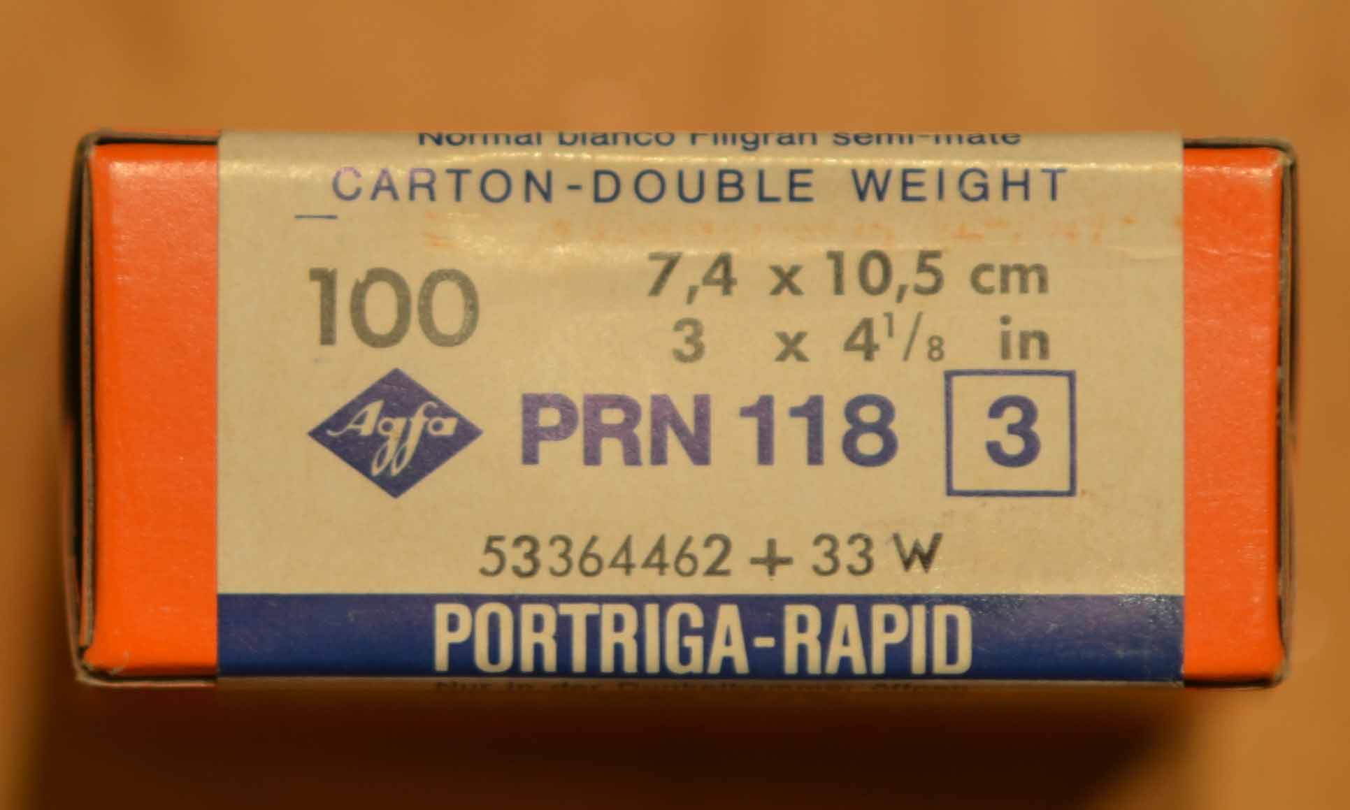

Hi Everyone,
I've got two unopened 100 sheet boxes of AGFA Portriga -Rapid paper PRN 118 [3] that were included as part of a darkroom equipment purchase (no idea when the paper was purchased originally). The kicker is that the sheets are 3 x 4 1/8 (74 x 105 mm) in size. In other words, TINY! The only use I can think of is maybe contact printing 6x6 negatives for small desktop/ mantle piece framed photos but I'm open to any/all other suggestions.
Why did the old time manufacturers make paper this small? Who used this size and why?
Im guessing that its grade 3 paper but could anyone tell me if its FB or RC?
Regards
Adam
why "so small"? - not everyone had an enlarger, and there were many more different sizes of negative materials to print from.
FB or RC? - FB
For contact printing 6x9 negs maybe ? My grandfather used to shoot an old Kodak 6x9 folder, and contact printed everything. There are a pile of quite lovely prints of probably the size above sitting in drawers, or framed, or filed. 74x105 gives you enough space to contact print and a generous border to mount with.

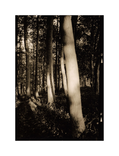

The paper is likely to be age fogged and difficult to work with using normal developers. My suggestion would be to us it for lith printing as Portriga works well in lith. If you are unfamiliar with lith printing there are some great examples of what portriga does in lith developer here https://www.flickr.com/search/?text=Portriga lith and you may want to check out an introductory article like this http://unblinkingeye.com/Articles/Lith/lith.html by Tim Rudman who is one of the best exponents and practitioners of lith printing. He has also written a couple of excellent books on the subject.
Alas possibly true the other option is to add oodles of anti fog ie KBr to get a warm tone.
It's FB. Try a sheet out. I was amazed some years ago when I was given some boxes of similar sized paper that were at least 40 years old to find it all worked perfectly. I used them up making a couple of hundred contact prints from a negative for one of my (larger) prints in an exhibition in York. On the opening night each attendee was given one of the contact prints gratis. Made everyone very happy...
RR
I have some very old (50-60 years?) Kodak Velox paper in a similar size. It still prints very well, and contact prints this size have their own charms (Size, as we gentlemen like to believe, isn't everything).
Simonh82's suggestion is a good one - here's a little lith (contact) print I made from a 6x9 negative (not a "fine" print as you can see, but that's the printer's fault not the paper :D)

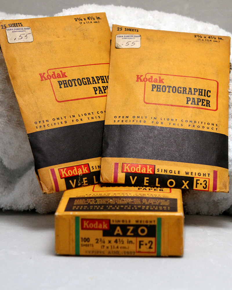

Open 'em up and make some contact prints, have some fun. I picked these up last week and plan on doing the same.
