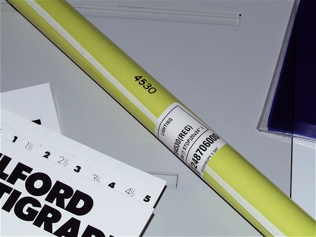

CC40Y filter in large enough size can be difficult to find. I've "modified" an Aristo head with a Rosco 30Y gel and seems to work fine. More discussion here, including stacking a 30Y and 15Y.
30ccY is easy to find and only cost a few bucks for a very large sheet. Rosco #4530

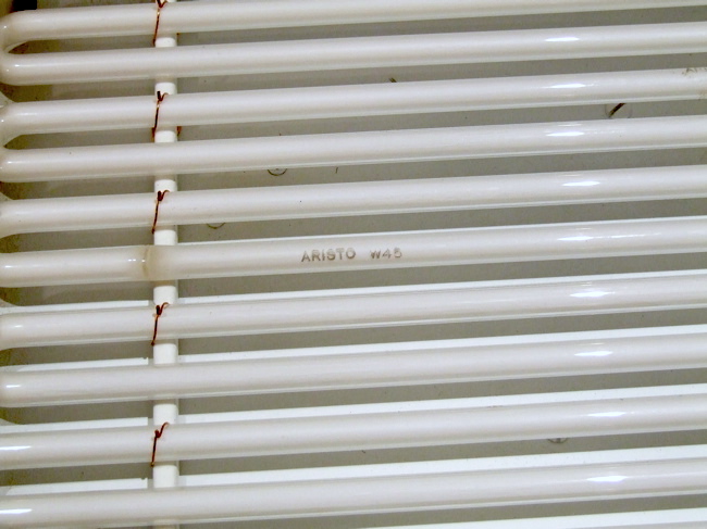

chip which aristo do you have?
they made 2 different bulbs for their cold light heads
the older ones were a w45 bulb and the newer ones were
v54 ... the v54 ones work better with multi grade filters
than the older ones ..

I think it's the older one--there is no mention of any model or wattage number on the original packaging or the instructions--just that it will last a lifetime. It says "H.I. 23, Pre "B", 8x8, & SP25.
The older Aristo W45 tubes give a distinct cyan-colored light. If your tube gives "white" light, it's the newer one and works just fine with VC filtration. The older one will too, just the contrast grades will be spaced differently. VC paper just needs a spectral range from green to blue.

Not only that but just to make matters more confused, I thought the one that looked "cyan" was the V54 and the one that looks whiter was the old kind.
I think it's actually the increased green in the light that makes it look different from white.

No markings on tube--just a single white bulb. Actually, the white diffusing disc is not attached--does it press on?
I've seen / handled 4 or 5 of these. The white disc just sits is the housing ring below the light.
The V-54 lamp should look more green. Here is some info on the lamps:
