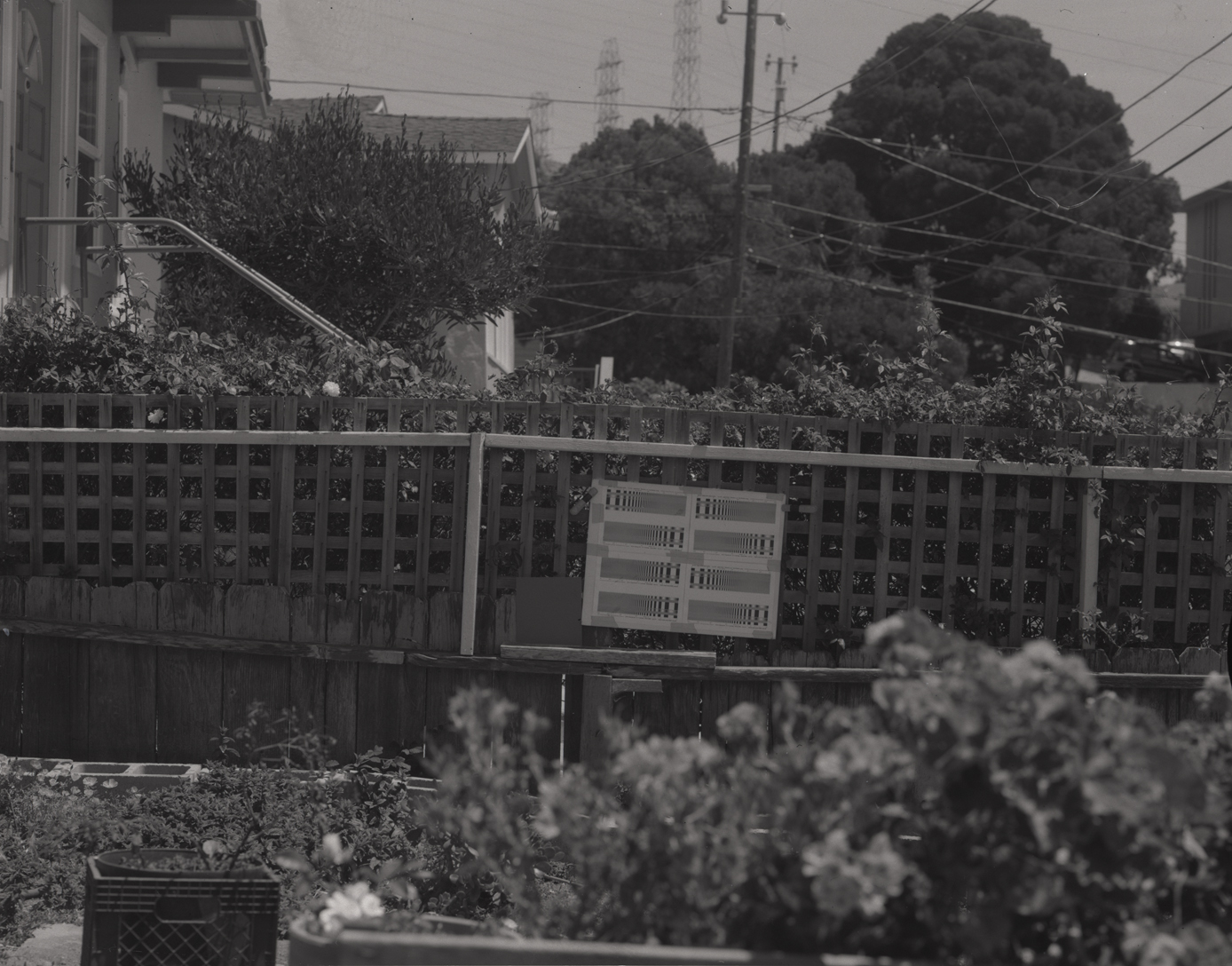

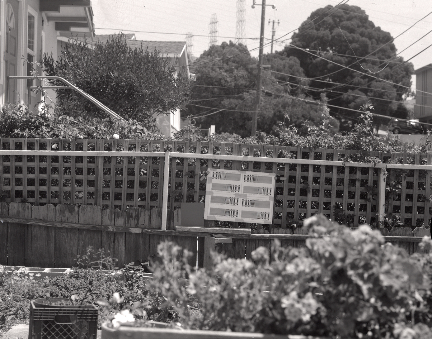

Test photo from a Speed Graphic with 135 f4.7 Optar, scanned on a V500 at 3200dpi with color controls off, stitched in PS7, reduced to 8 bits and 600dpi
A.jpg levels show blacks start at 20 and end at 160,
B.jpg levels adjusted to 0-255. 18% gray card at lower left corner of the lens test chart in the center of the photo.
Arista EDU 100 4x5.
