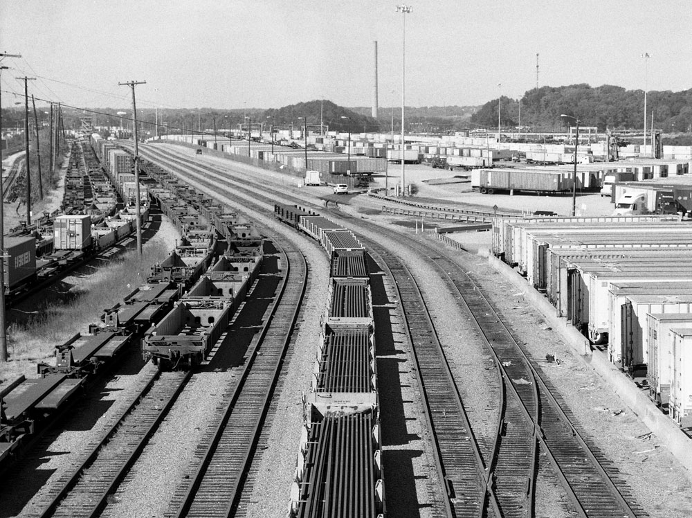

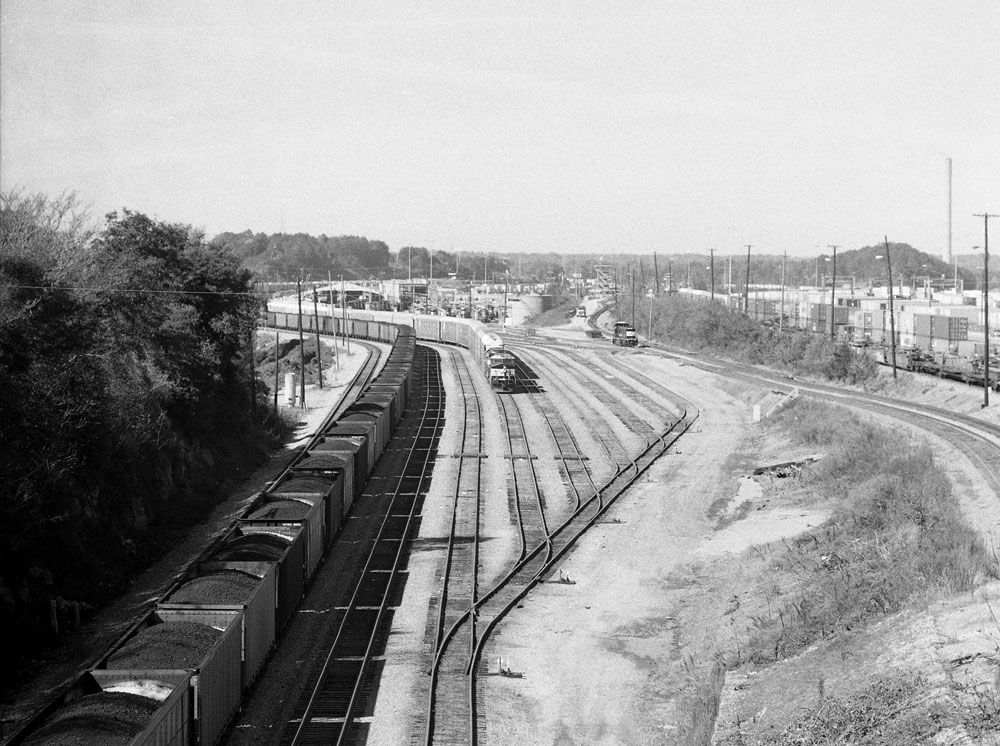

I started another thread about accidentally shoot AristaEDU 400 @ 100. Here are a couple of the shots.
I developed this in HC110 1+50 for 7 min @20C.

Would your intentionally shoot at at ASA 100 again?

I love Arista EDU 400 and 100 and I use HC-110 to soup it too. Would you Arista 400 at ASA 100 again?
