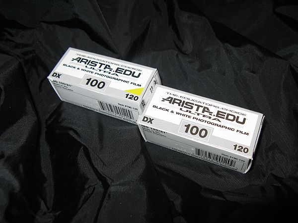

Has anyone else noticed this small change to the packaging?
attachment.php
For casual street shooting, the Arista.EDU Ultra is fine for me.
I'd agree with in all aspects.
Except for the scratches. That is the killer for me. The scratching. If I find a camera that doesn't cause scratching, I will probably use the Arista EDU Ultra 400 for fun street shooting just as you say.
No idea what the yellow triangle means on the new boxes.
