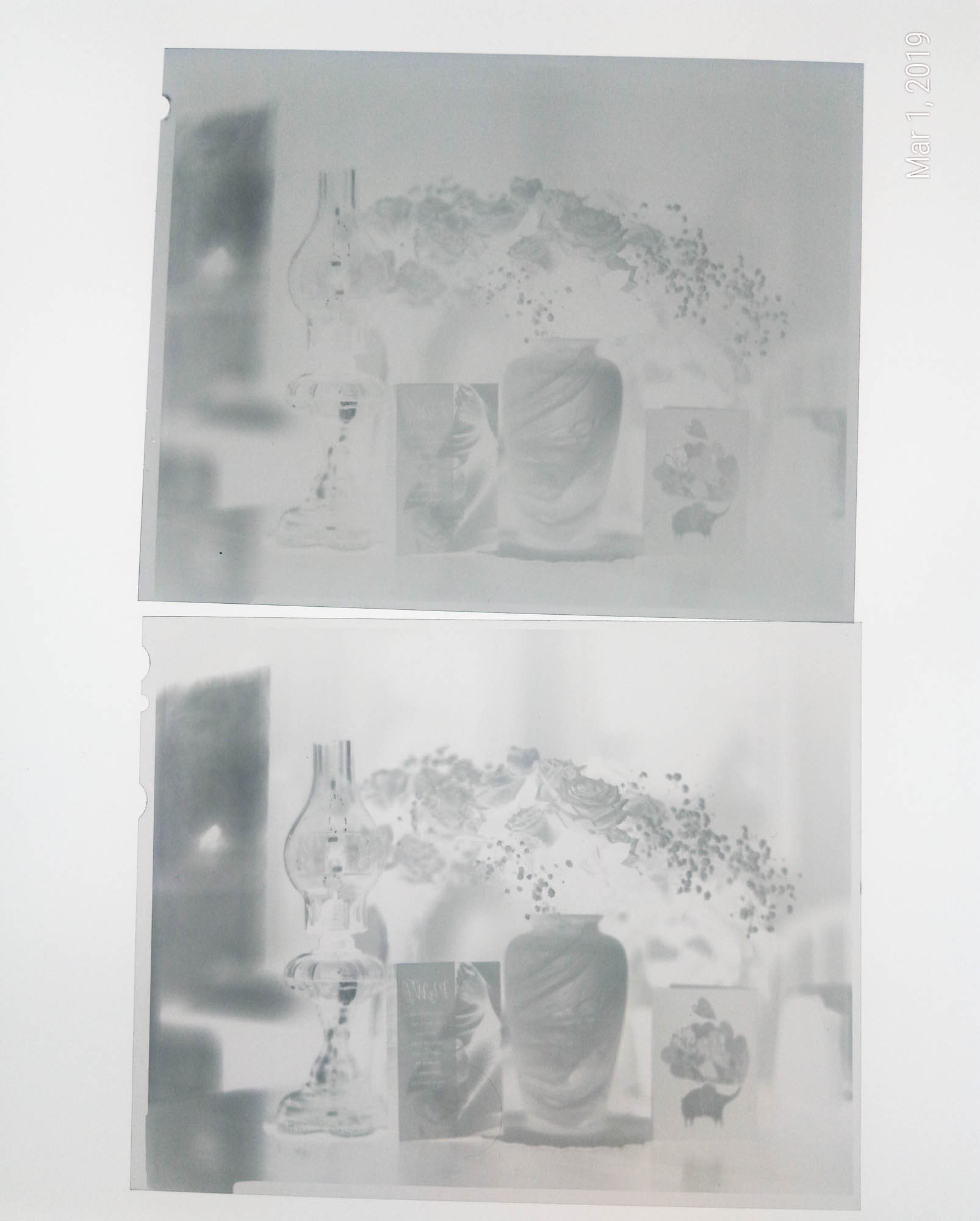

This is an example the top negative is Arista EDU 400 and the bottom negative is HP5, taken consecutively with the same camera, same exposure, developed with hangers in a tank with Xtol (the HP5 longer than the EDU400).
The base of the EDU is much grayer and the scans look worse than the HP5 (It also seems to have about half the effective speed as the HP5).
If this is typical of the film, I don't find it very useful.
Ed

What were your development times? The foma/edu looks underdeveloped. Would also recommend a presoke with this film.
Since this was the first time using the EDU 400, I used the time listed on the info sheet with the film along with a presoak. I've experimented a bit to see if it is my technique and used HC-110 and Diafine also, with similar results. An EI of 200 seems more reasonable than 400. I have not tried to make a darkroom print.

The two negs you are showing are underdeveloped, underexposed or both.
Give it a try with more exposure and more dev time.

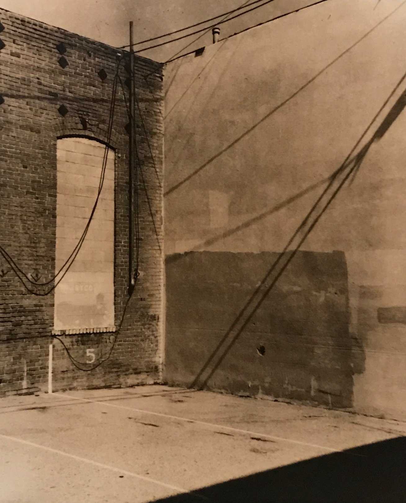

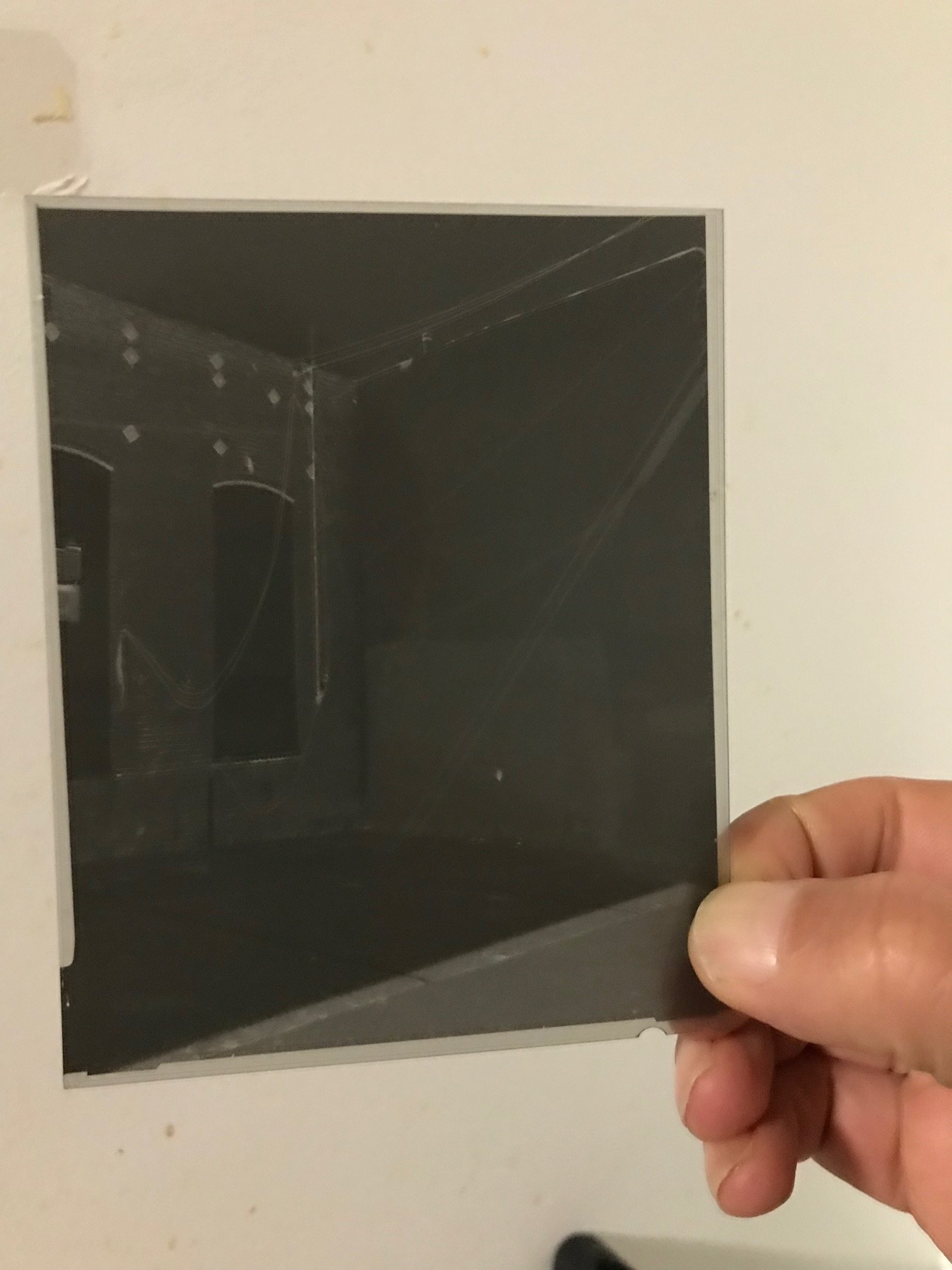

This is an example, developed and printed yesterday, of how dense my neg are. Processed in Rodinal.
And the resulting test lith print.
Best,
G.
Guillaume,
Thanks for the example. It does look like a good negative and print. The base material is not fogged like the box I have.
