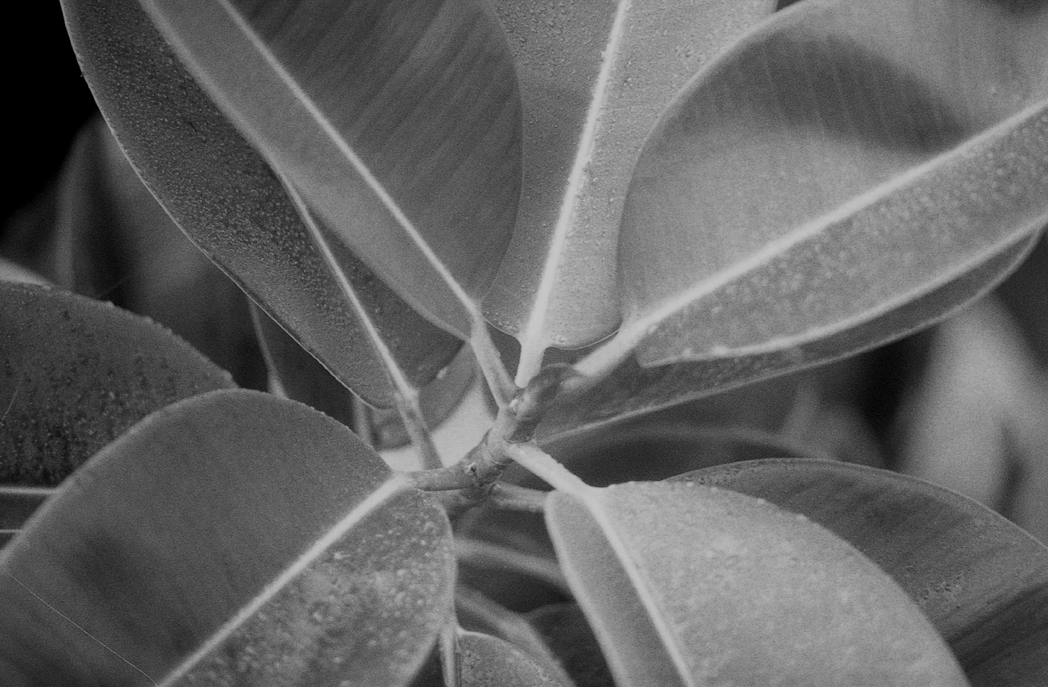

My first experiment w/ Legacy Pro L110 went so-so w/ Shanghai GP3 100, so I tried it today in 35mm w/ Arista EDU Ultra 100. This did not work. Any ideas? I went w/ Dilution B again, and followed the times from Digital Truth of 6 minutes at 68 degrees. This film usually works better in many developers if shot at ISO 50, and I shot it at ISO 125, but still.... I did use the times for HC110, which I assume are the same for the L110, since its a Freestyle clone.

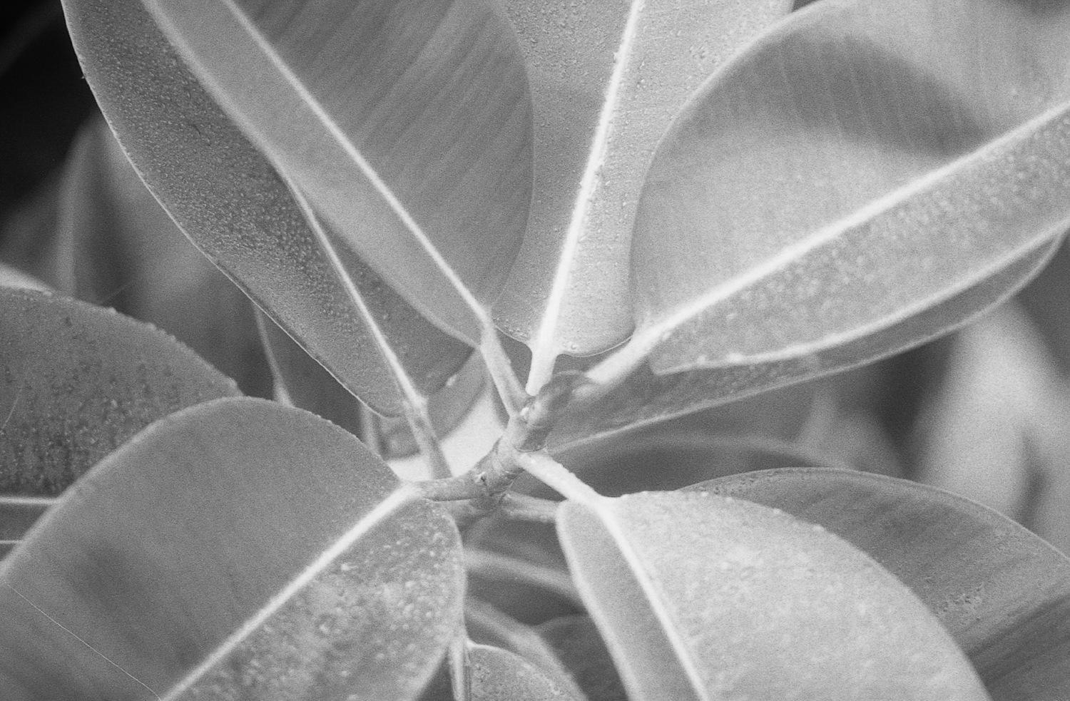

One thing I should mention is that the website said to give it constant, slow agitation. I had agitated the Shanghai film like most films - 30 seconds initially, then 2 inversions every 30 seconds. Might the constant agitation be the problem here? The first photo is a straight scan of the neg, the second has the brightness brought way down. All the shots look like the first one. Soft, fuzzy, and way too light.

That's a good system M Carter. Usually 2 rolls and I have it pretty close, but this roll is way off for some reason. I've shot this film at this ISO before w/o this happening (although it looked like lith film w/ D76, and was perfect w/ Mic-X full strength). It's the constant agitation I'm suspicious about.
This person says they agitate just ONCE w/ this developer. The aggravating thing is that Freestyle's website gives no info on agitation or times and temps w/ this developer, nor can I find it on the web anywhere.

Well, you could try the Massive Dev Chart, but I'm beginning to think agitation gets really overdone sometimes (and of course the dev chart doesn't address agitation, now that I think of it!)
I tell ya though - I may get a wild hair, find my favorite dev. time for a particular film, make a test setup, and do an agitation test. With the above setup, I could do 4 to 6 agitation mods, from minimal to lots - really the only way to really suss it all out, right?
