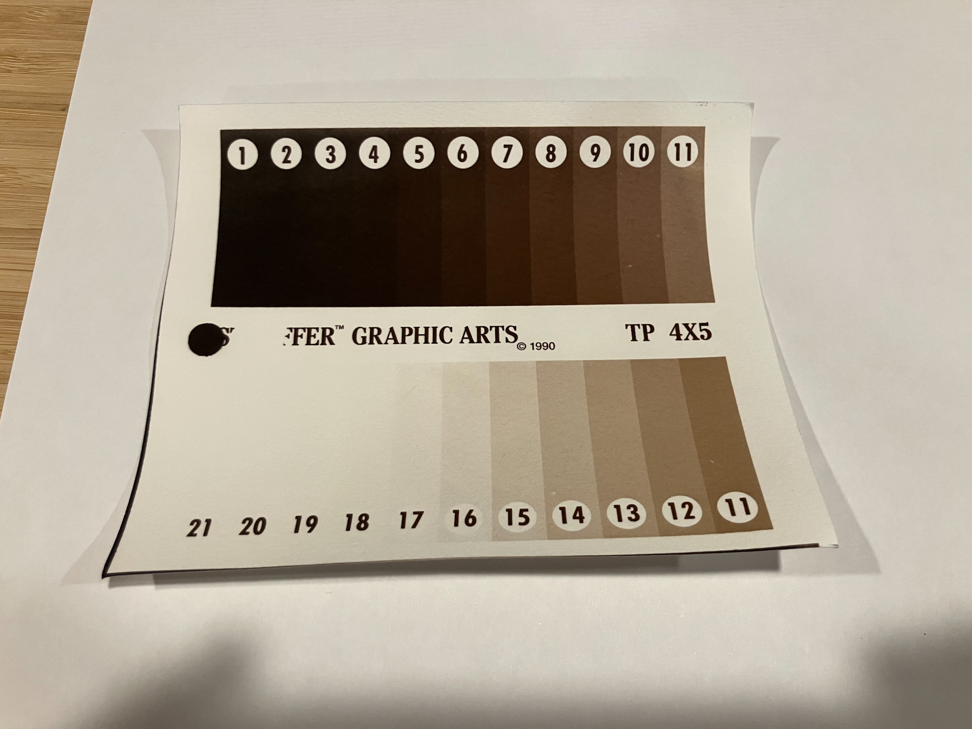

Hey all,
I’ve been having issues getting argyrotypes dialed in. My first couple were beautiful, high dmax, kind of reddish tone out to the highlights. But every print after that has been kind of grey / silver, often mottled, low dmax. I tried various things (acidify my paper, different amounts of tween, varying exposure time), nothing helped.
Today I thought I’d try filtering sediment, and there was a couple mm of black sludge at the bottom. I’m thinking something went wrong making the sensitizer.
One post here suggests it could have been contamination from my everyday coffee filters.
1: Is my bad sensitizer theory solid?
2: If so what other sources should I consider?
3: If it’s filters, what filters do folks suggest I try?

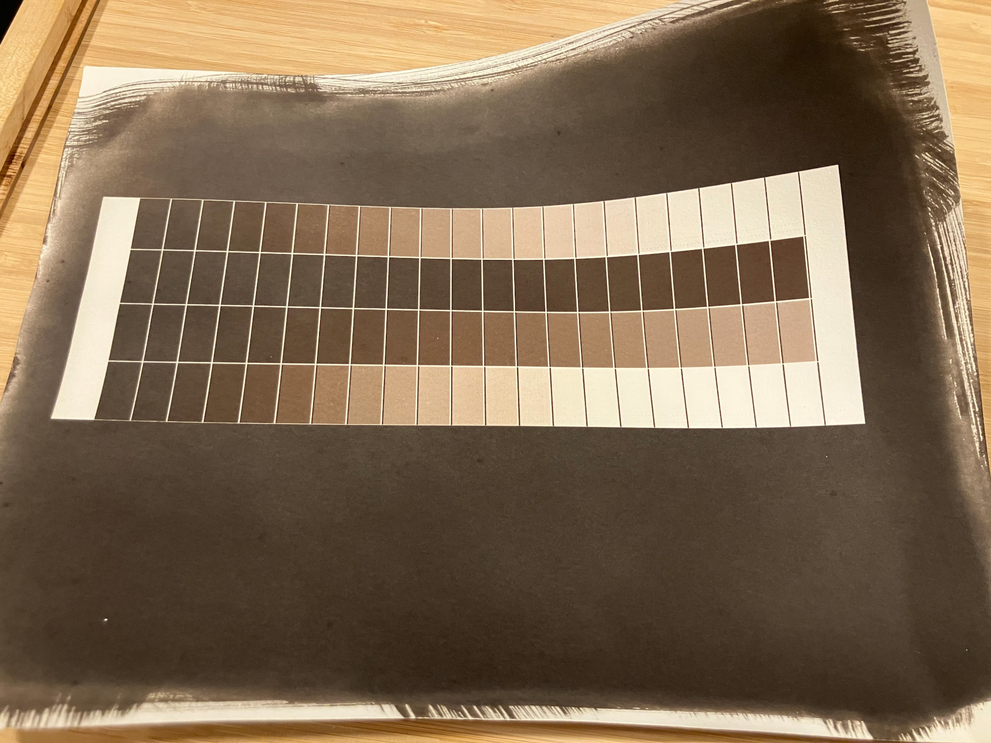

I have the book but haven’t found the sections on these issues illuminating.
For reduced D-Max they suggest that the sensitizer could be past its shelf life, but it doesn’t help explain how that could have happened so quickly (order of days).
For mottled blacks the suggestion is just “get better at coating”, but coating technique hasn’t been an issue in any other methods I’ve used (and I’ve been trying different strategies with only small improvements!).
My suspicion is that the sensitizer /has/ deteriorated, but the question is “why”. My thinking is that it’s possible that my coffee filters have increased the PH of the sensitizer causing silver citrate to predicate out reducing the effectiveness of the sensitizer. [1]
Buuuut i’m curious if folks had other theories before I run head long into buying some lab grade filters and making a new batch :smile:

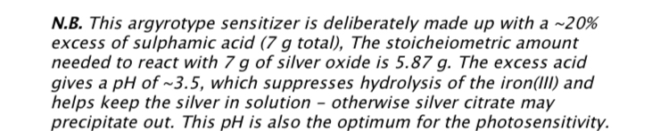

If you overheat sulfamic acid solution it will hydrolyze giving ammonium bisulfate. For this to happen at a relevant speed it needs to get above ~90°C.
This might have happened locally in case you did not stir the solution enough while heating it?
Hmmm it’s on a hot plate stirrer with stirring enabled. But certainly on a second attempt I plan to be a bit more gentle.
Could it be that some of the sulfamic acid got hydrolyzed and as a result there was less (or no) excess sulfamic acid in the mixture which then resulted in formation of silver citrate over time.
