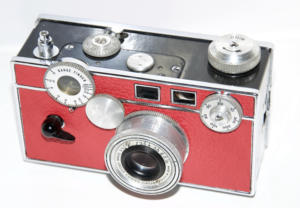

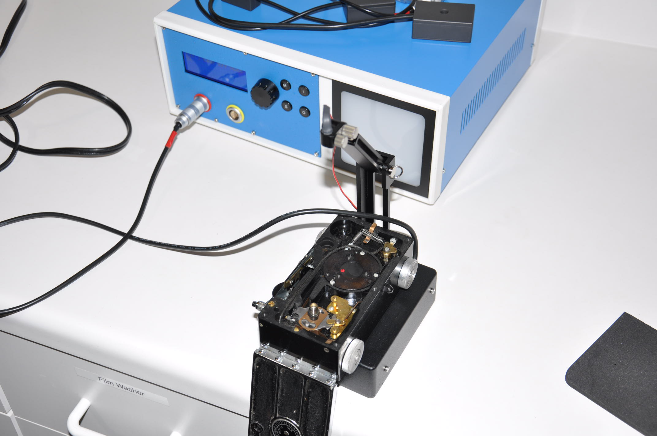

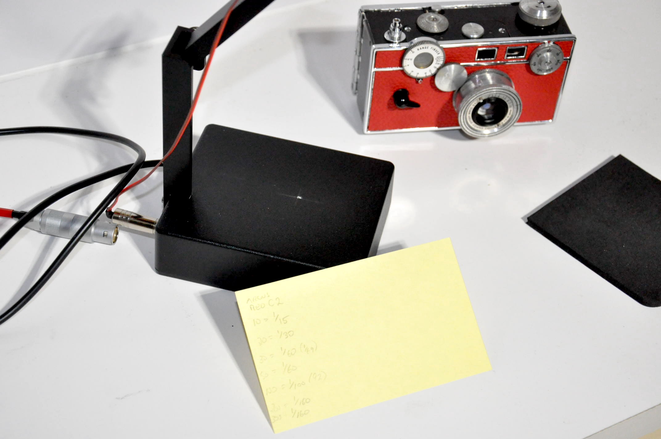

Finally got around to making a decent leaf shutter tester that calculates effective shutter speed based on ISO 516:2019 definition.
There are plenty of resources out there on repairing and maintaining these cameras. I don't have much new to add, other than the fancy red covering from "Camera Leather."
Maybe not so easy to make out, but the speeds I got (after a lot of fiddling with the mechanism) are as follows:
1/10 = 1/15
1/20 = 1/30
1/30 = 1/70
1/50 = 1/70
1/100 = 1/90
1/200 = 1/160
1/300 = 1/160
What am planning is a little conversion chart for the back of the camera to fit over the "Weston" speed dial.

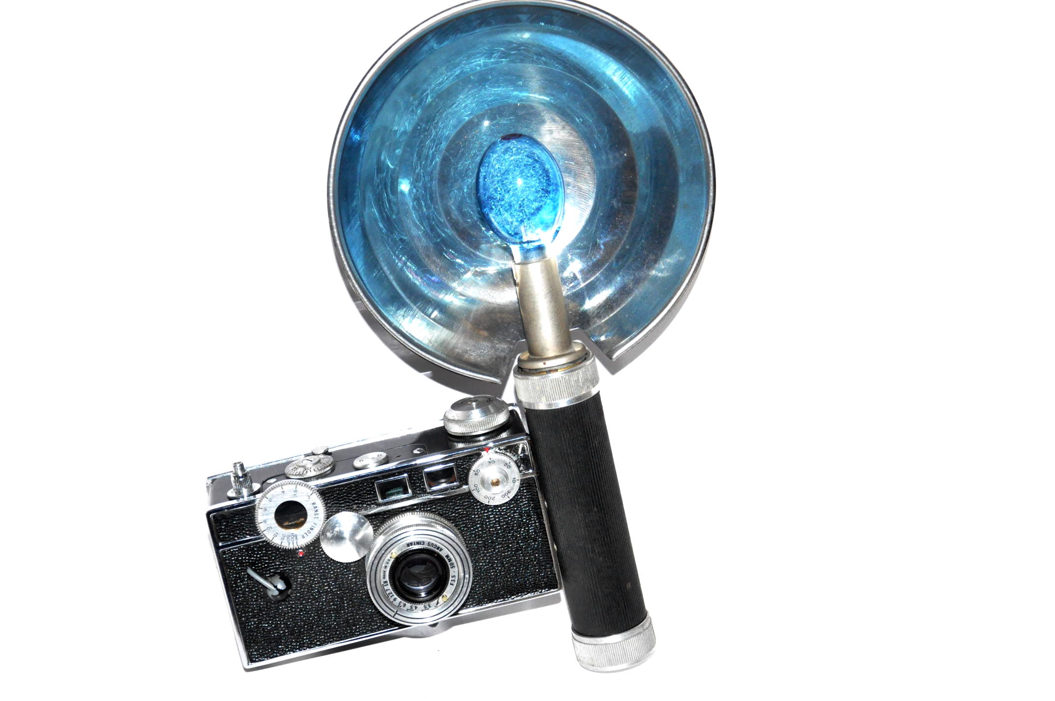

I think the main change was the addition of flash contacts.

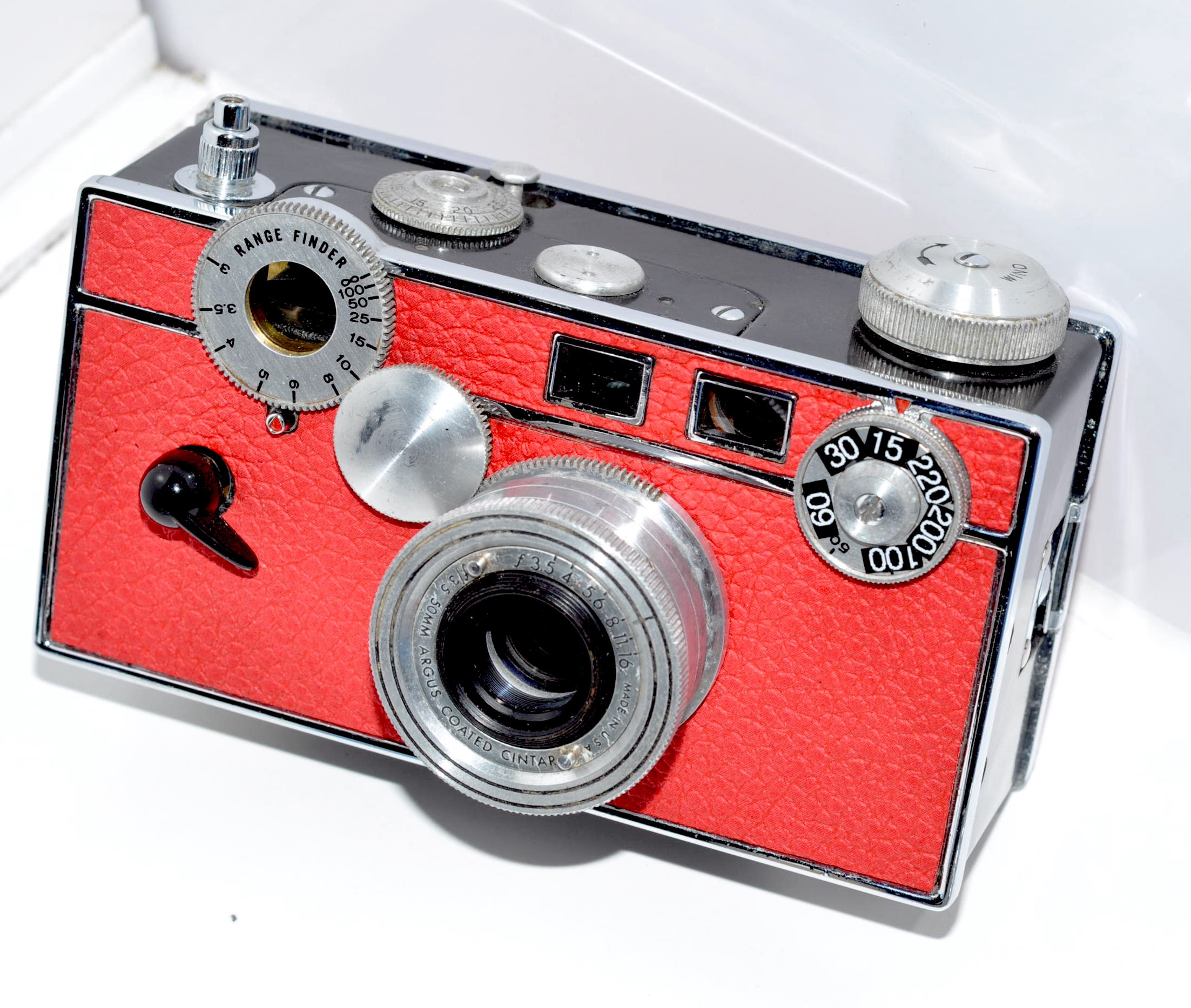

I actually changed the thread from "C2" to "C3." I had thought the now-red one was the C2 and my black one with flash C3, and even ordered the red as C2 leather. But I think you are correct in that they are both C3.

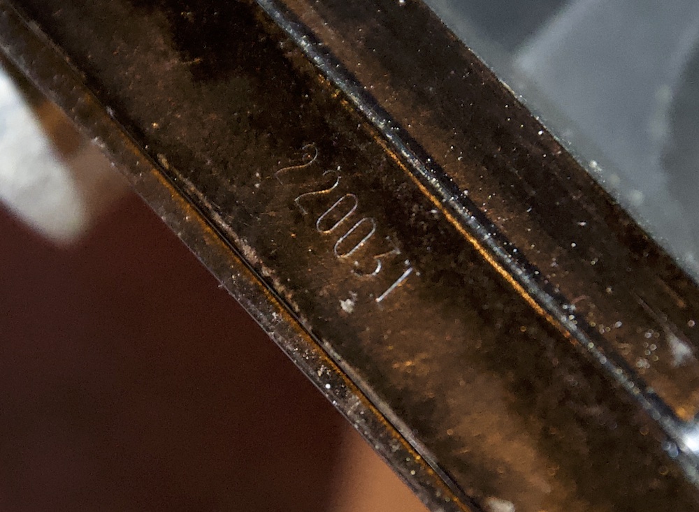

Some confusion because the serial number on the red one I thought was "20031" but after close examination with a magnifier I think it is "220031." I'll try and post a picture.
56395 for the black one.

Then came the C-3 with flash contacts.
