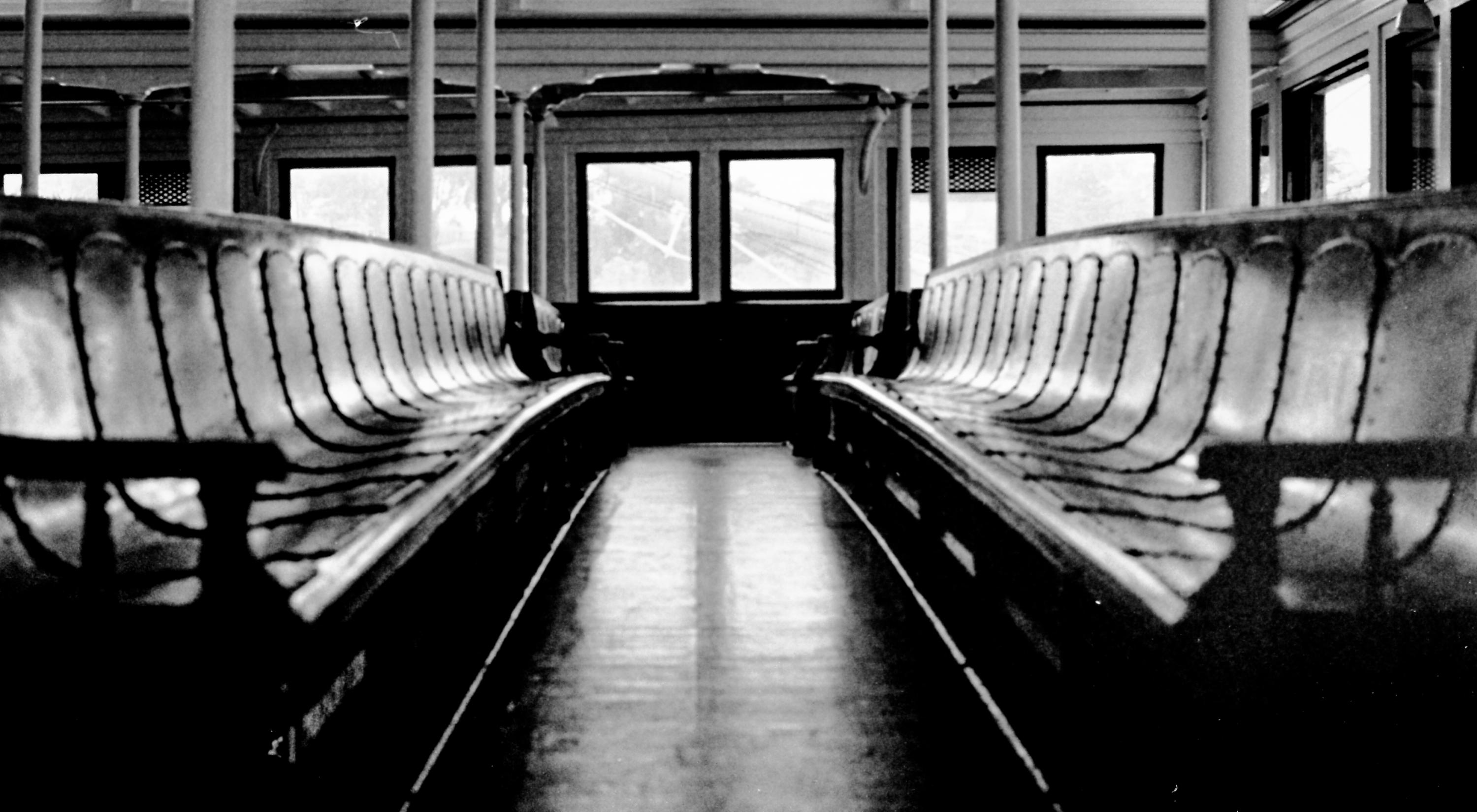

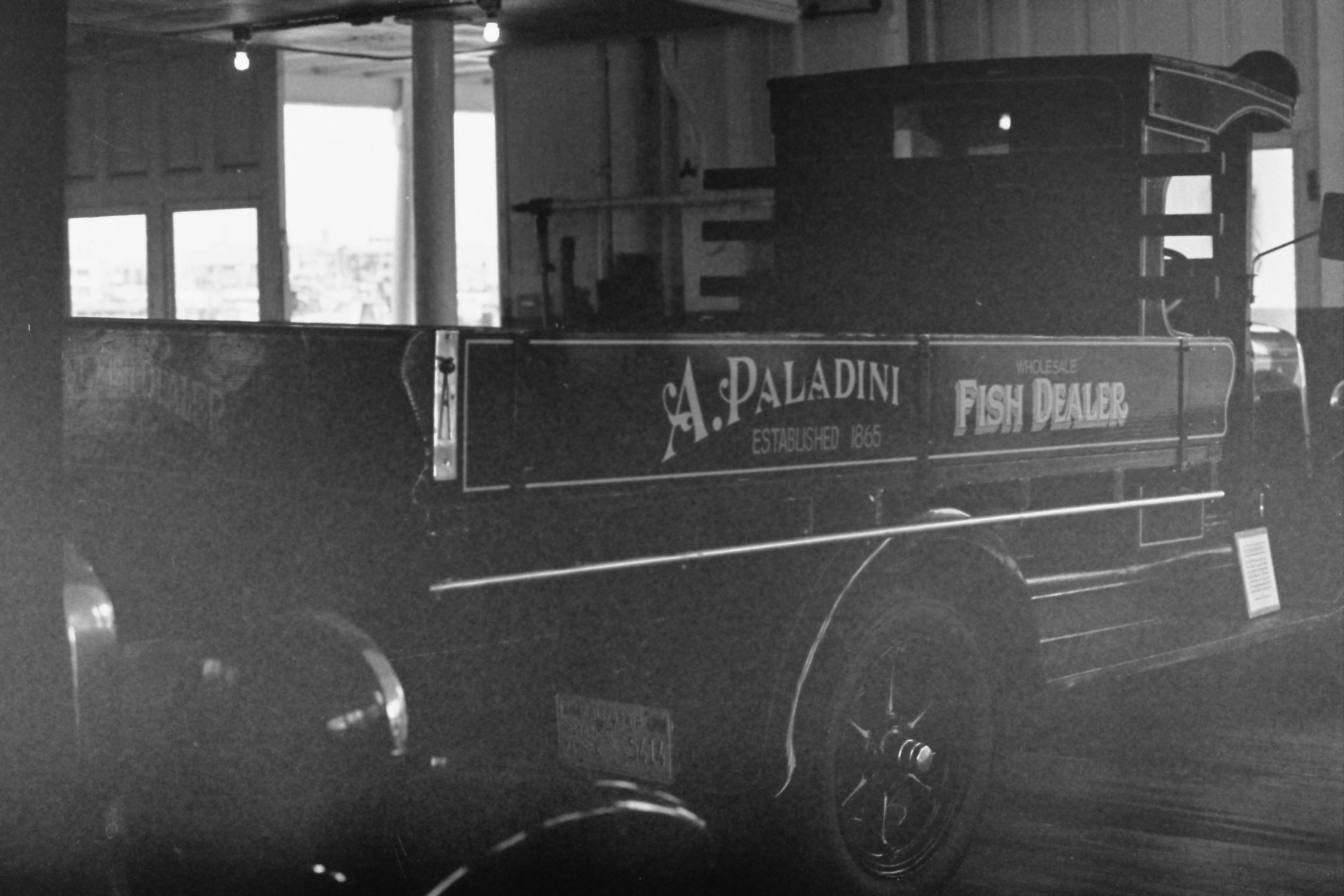

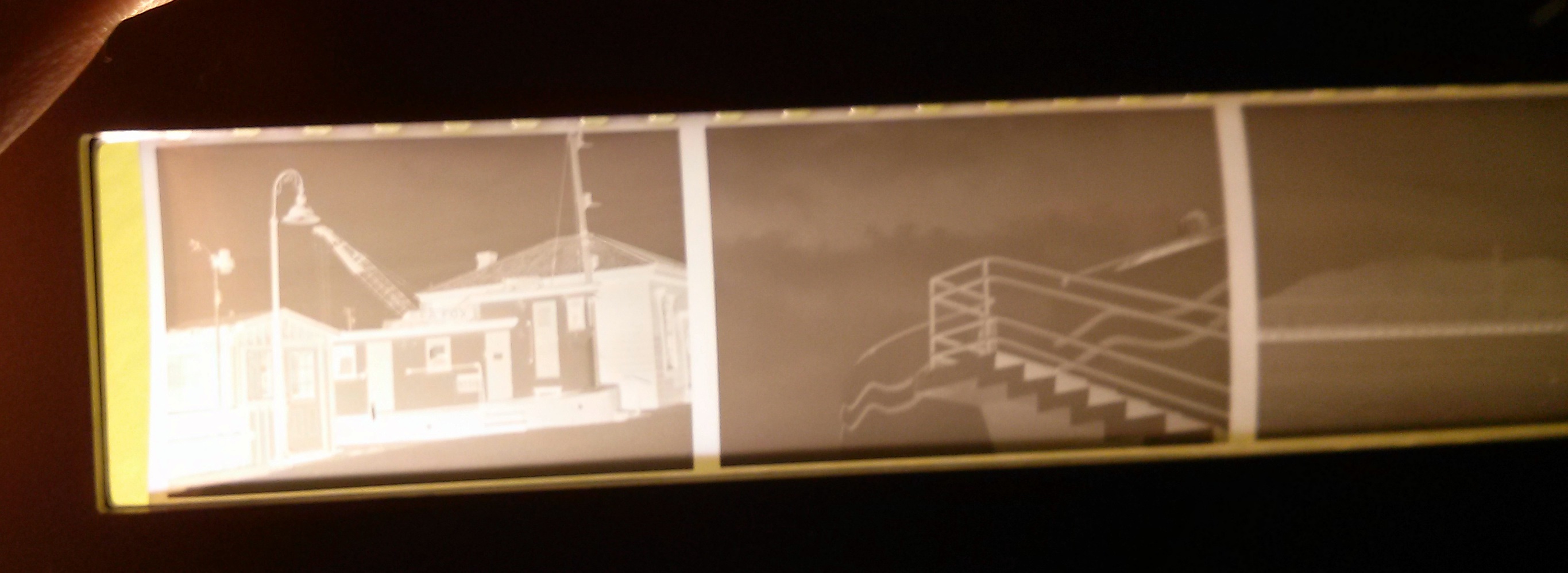

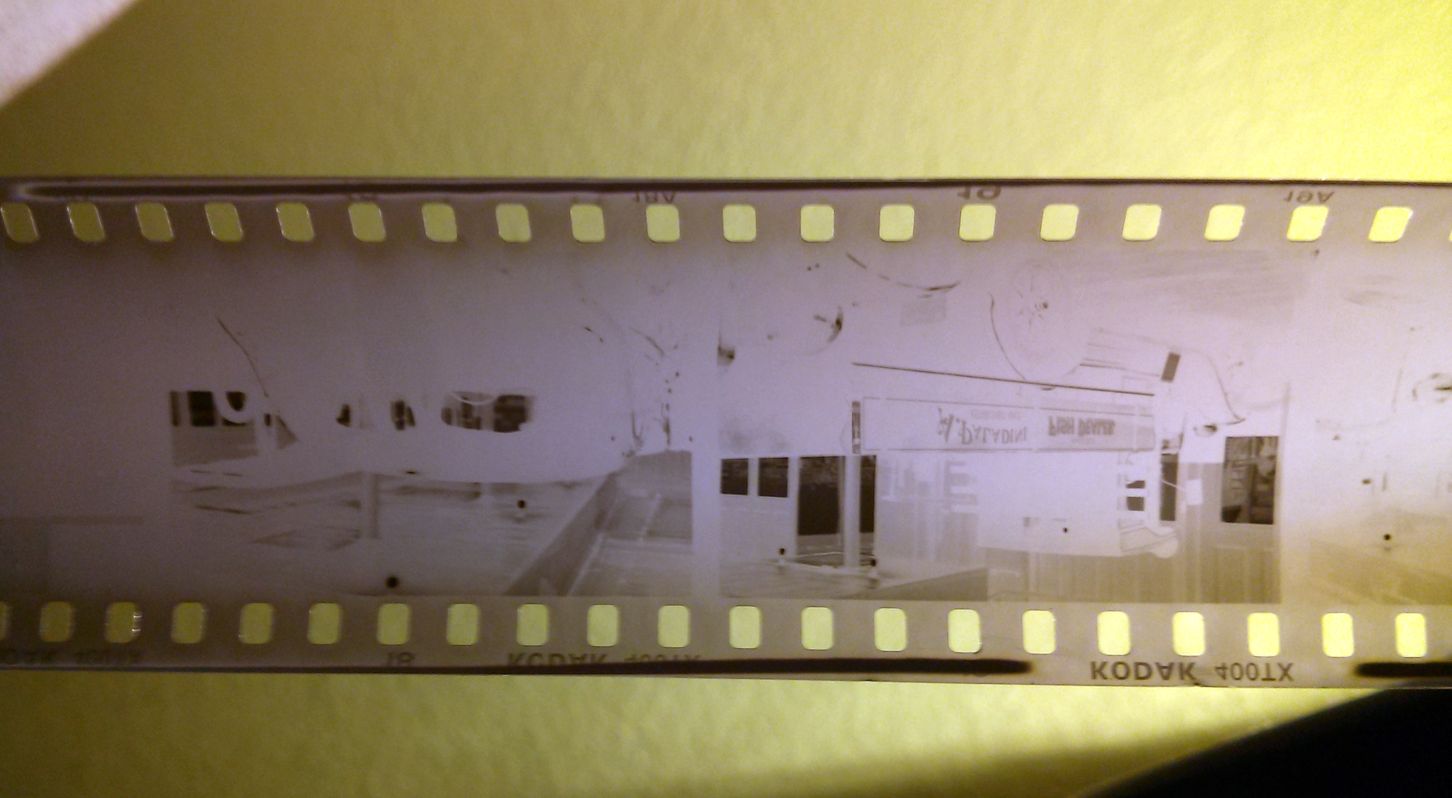

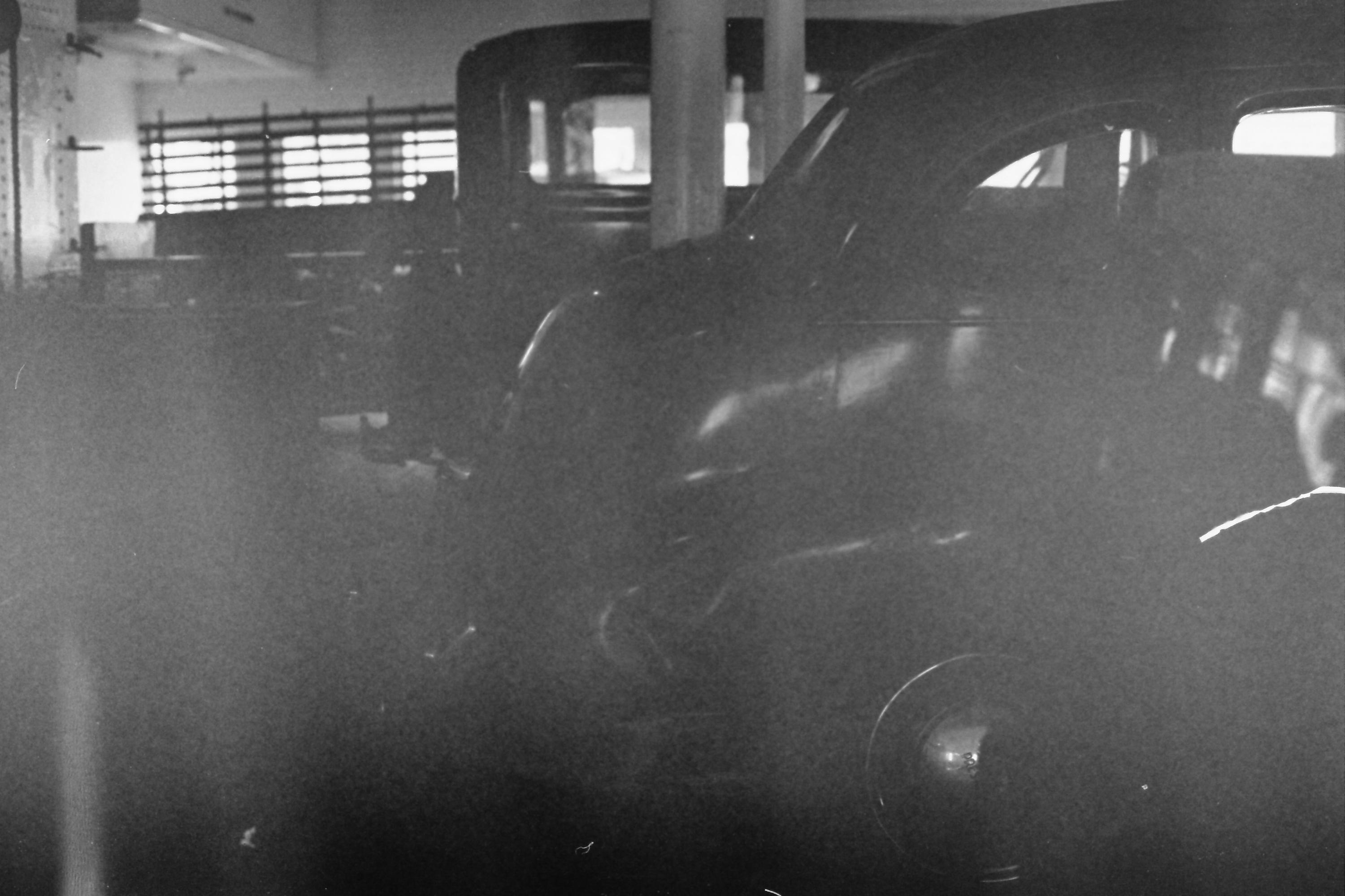

Hi Guys,
pics taken inside the boat looks like these
is it underexposed?
used film -Kodak 400
camera -f2.8 - 4, 1/1000, light meter broken
which settings should I use?
outside all ok
thanks!

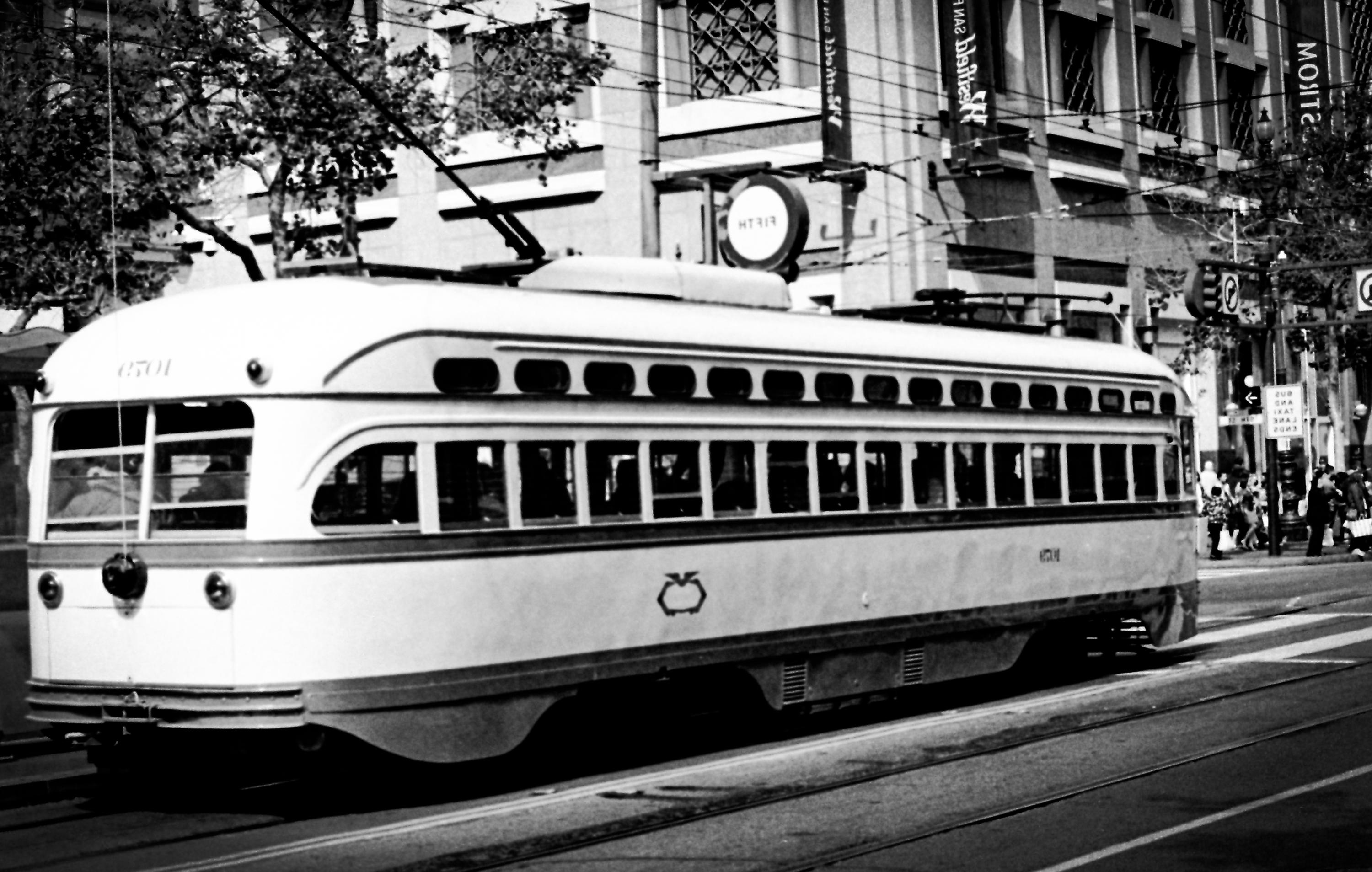

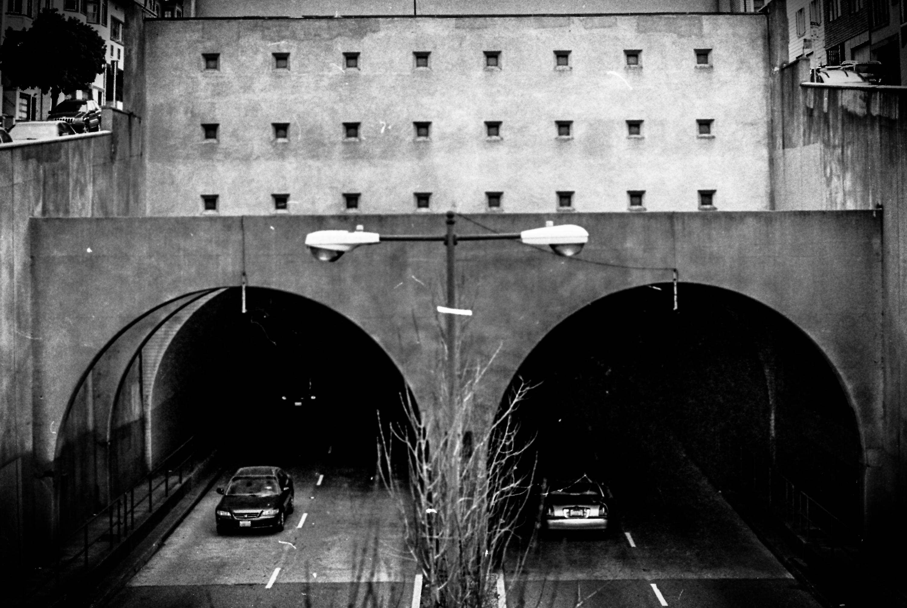

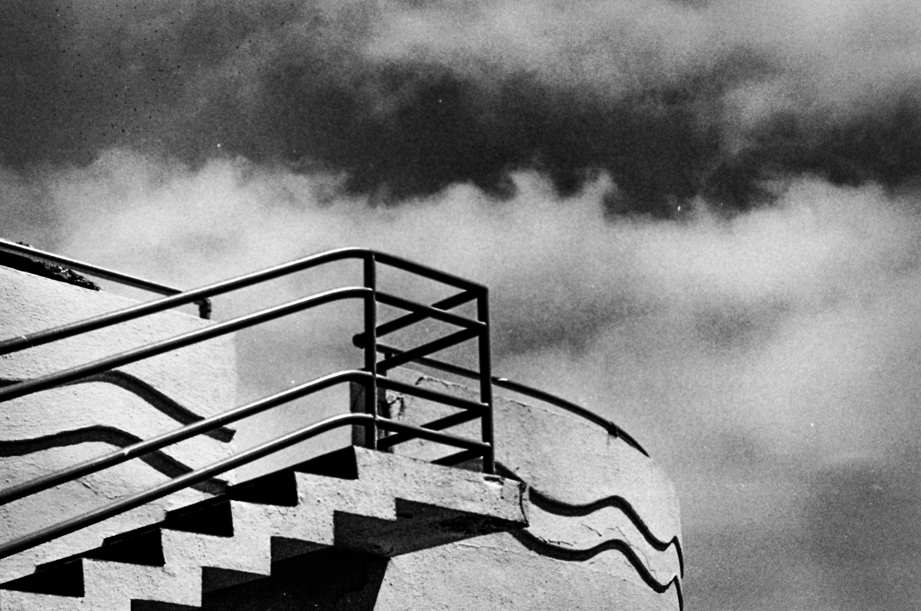

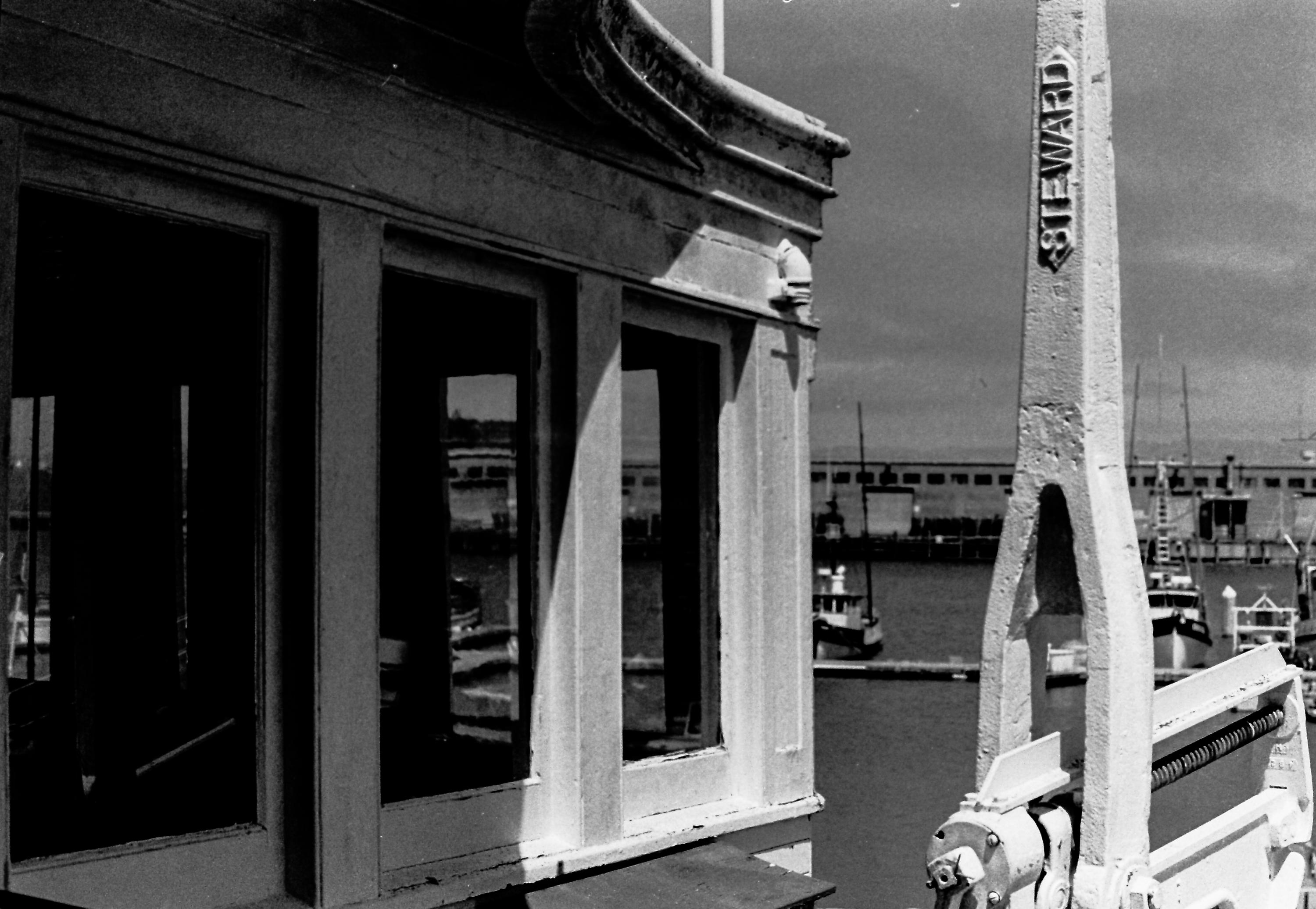

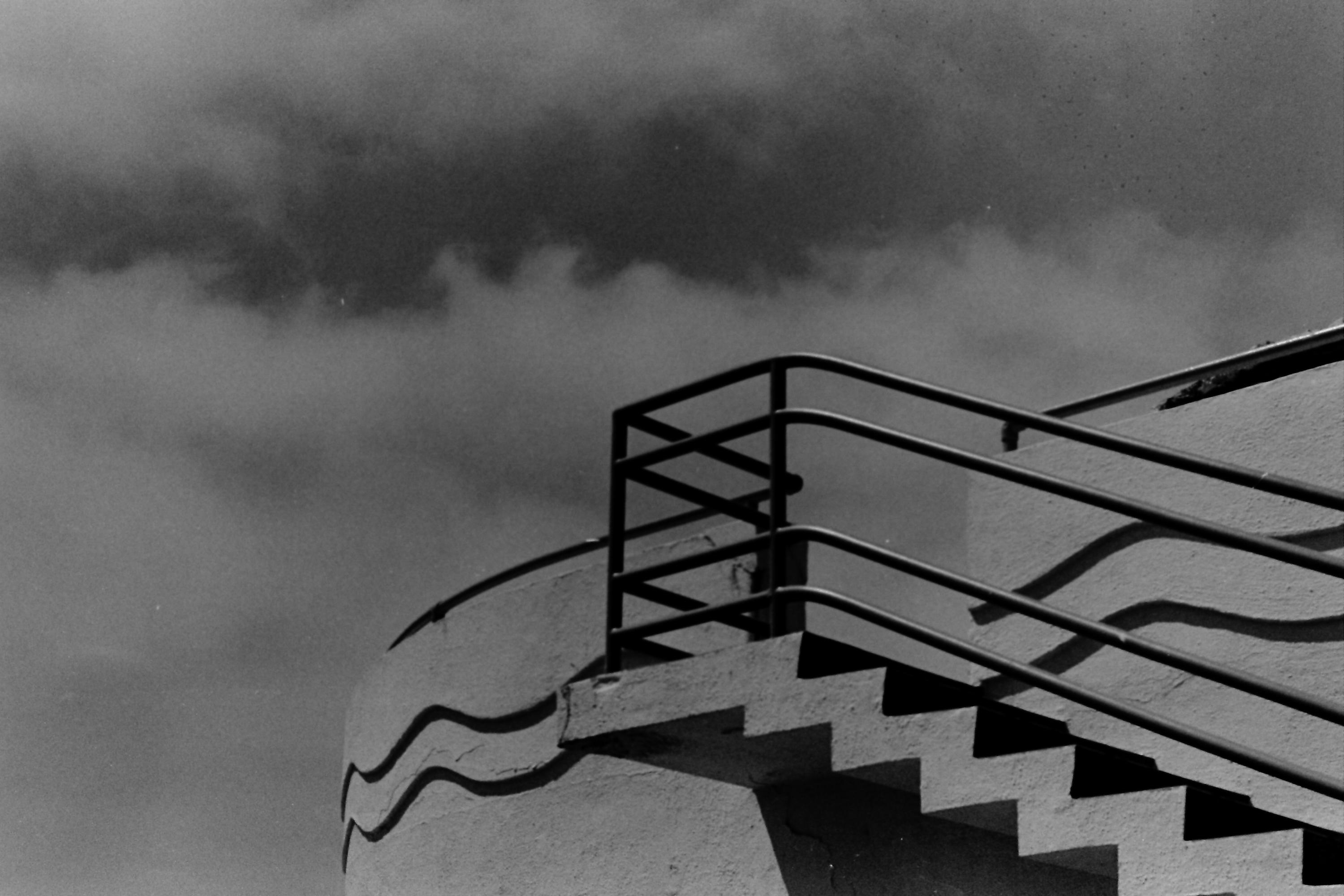

these ones taken outside
f5.6 -8, 1/1000
looks ok? :confused:

The first batch of film is underexposed. There's no way I can tell you, from my viewpoint in the California desert, what your exposure should be. You need a light meter. Hand held ones don't cost that much. The ones taken outdoors look okay. The shot of the negative seems to indicate you're not fixing the negs long enough as well, or your fixer is shot. Good luck.
LJH
Nov 25, 2008
724
Australia
ULarge Format
Sunny 16 says you should shoot this film at 1/400 (1/500 camera speak) at f16. At 1/1000th, you're down to about f9 in sunny daylight.
To shoot at 1/1000th at f4, you're only 2.5 stops less than a sunny day exposure. Without knowing the exact lighting you were in, it is still fair to say that you were well short of that amount of light, so, yes, underexposed.
Why were you shooting at 1/1000th? You could safely shoot at 1/125th if you're using a 50mm lens (slower if wider, or if you practice your technique).

From what I can see from your scans these images appear to be severely underexposed and over-developed.
There are just too many variables to consider to give you any really meaningful advice.
However, depending upon where you live and whether the sun is behind you or to one side, you would need to give an absolute minimum of 1/125 @ f16 with an ISO 400 film to achieve a decent level of shadow detail - if that is important to you.
Best idea is to get a hand-held meter and learn to use it.

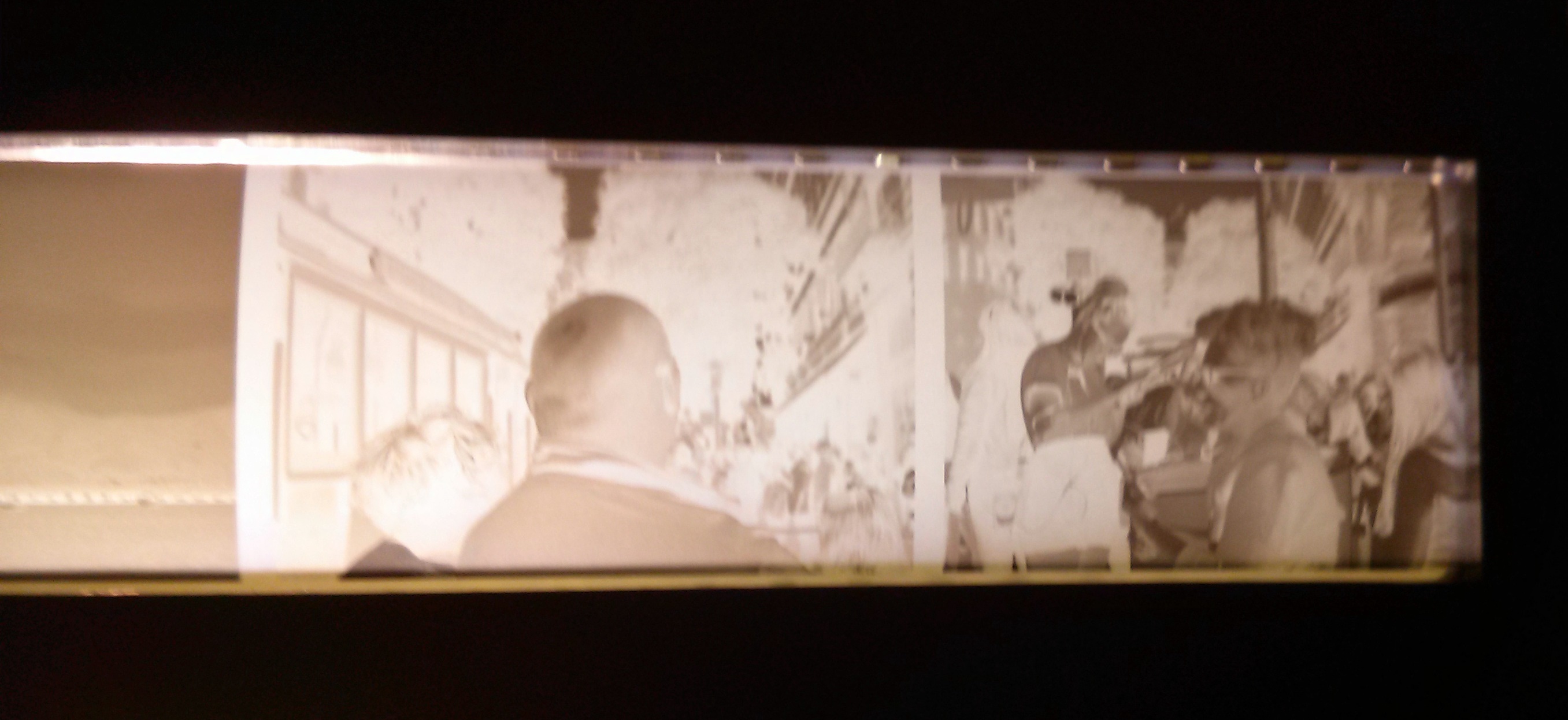

little confused as developing time = fixing time
and over-developed - but outdoor images don't look over-developed? (it is the same film roll), so problem only in underexpose?

The outdoor images have a range from black to white BUT there is absolutely no shadow detail.
This means that you have underexposed the film and also overdeveloped it. Why? - well if a film is underexposed but you have tones from black to white you have processed too much. This is in effect what people refer to as 'pushing' film which actually means 'I will except a loss of shadows to use a higher ISO for the film but I still want a full range of tones' and to achieve this you overdevelop the film to stretch the tonal range back to what a properly exposed and developed film would look like.

Indoor pics are clearly underexposed, which can be inferred both from the lack of shadow detail in the pics and, even better, from the direct view of the negative. And, even without looking at the pics 1/000 f/4 is way too little exposure for indoors.
As concerns the outside pics. 1/1000 f/5.6-f/8 is equivalent to 1/250 f/11-f/16 which should be OK as long as open shadow areas are not too significant. Lack of shadow detail inside the tunnel is not too surprising; rendering both the sunlit outside and the tunnel interior is a challenge beyond basic exposure learning. Ditto for the room interior seen on the left of the second pic in the second series; sometimes ons should "let shadows fall where they may".
Overdeveloped? Hard to tell for sure without having the actual negative in hand. The highlights on the streetcar look like they are blocked, but how to tell if it's not the result of poor s******g technique or settings?

You need to fix properly the rebates the sprocket hole area should be as clear film as the gaps between frames, you have gross underfixing...
After three minutes in plain hypo it is safe to open the tank and lift the reel out and if it is not clear of milky effect put it back for another minute lift it out and repeat until clear, of milky effect. Then leave it in the tank for the same time again. Don't try and stretch the life out of fixer.

From the negs I would guess the inside pics are about 3 stops under-exposed. So in similar light, try 1/125 or so rather than 1/1000, with the same film speed and aperture. That should give printable negatives. You could go one stop slower to be safe (1/60") since moderate overexposure isn't a problem with print film. Of course a light meter (even a phone app) would be most useful!

The indoor photographs are underexposed and they may have a flare issue.
The 1/1000 second exposure is way too short.

can you post a shot of the negatives from the outdoor shots? people are saying they are overdeveloped but it could very well be the way they are scanned. only way to know for sure is to see the negatives
Bobkins
Aug 11, 2014
58

I developed and fixed for 4 min
Don't worry about the development time you have not fixed for long enough.
Your text should have read
I developed for x minutes in y
and fixed for z minutes in t at 78F.
Put the film back in fix solution it won't keep otherwise.
Alternatively your camera is leaking light but looks like fixing.

because there is a chance you might not be fixing your film enough ( does it look kind of milky ? )
you can determine your fix time by taking your film leader that you trimmed off
before loading the film on the reel. with the lights on agitating it in your fixer to see how long it takes to "clear" ( be see through )
to film base DOUBLE that time for your total film fix time. ( so if it took 20 seconds, fix totally for 40 seconds ).
and make sure when the fixer is in your tank you agitate it like you did your developer ...
