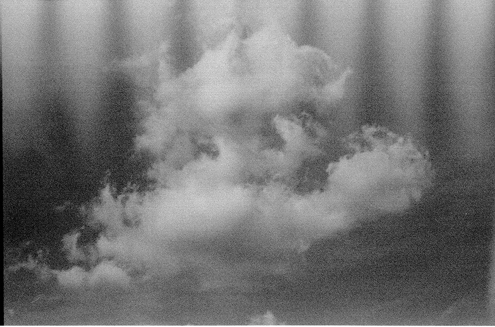

I've just developed a test roll to try out a homemade developer based on tea+ascorbic+carbonate, at pH 10.35. (aiming to a Caffenol C-M alternative, which doesn't smell bad). It seems to be strong enough to develop more than one 35 mm roll per 300 ml.
But, I overdeveloped too much. I did a clip test and the drop test, and guessed a developing time of 25 minutes (25ºC).
It seemed a slow developer, maybe to weak, and I decided to go semi stand, for one and a half hours (three invertions after 2,4,8,16,32,... minutes). Obviously, the development was faster than initially guessed. Base+fog is 1.9 (!!)
Also, there're streaks that seem to be due to light. I never saw these before. I was very carefull while loading the film (in complete darkness, from a 30 m roll to a plastic canister I've used other times with perfect results).
The light area of the streaks fall between the perforations of the film, and, with varying intensity, cover the full length (17 exposures). The most obvious (attached) is not at the beginning or the end, but in the exposures near the middle of the film length.
I'll be doing some more test.
Any idea? Thanks in advance.

My first guess would be bromide drag from the stand process. Try again with much less time and more agitation.
Apr 2, 2017
639
Sprocket marks. How did you agitate? Generally the sprocket marks happen when inversion agitation is too vigorous or frequent. In your example, the lighter areas (higher density on the negative) are the holes. The darker (thinner density on the negative) are the film support. Locally higher developer velocity from vigorous inversion is the explanation.
Yes, after searching for bromide drag, this seems the explanation.
Strange,... I did the most invertions at the beginning, where I've read it is more important.
I'll try much sorter time and not let it stand for more than 10 minutes.
Three gentle invertions, with some rotation of the tank between and before each of them.
Definitely not vigorous.

I have had similar with fogged film. I had a film jam in a camera while away camping and used a dark duffel bag and blanket as makeshift changing bag to get the film out and load another. I ended up with most of the exposures like yours above from mild light fogging. I used standard ID11 inversion processing for this roll.
Equally it could be bromide drag.
Is there any chance the film could have been fogged?

This time it came out well enough. No streaks. The longest period without agitation was 8 minutes.
I cut development time down to 22 minutes (invertions at minutes 1,2,4,8 and 16)
This time the negatives are a bit thin, but look good.
Seems that I got around EI 50 (using Foma 100), so 25-30 minutes will be probaly better.
Or try to do invertion every minute and cut to 15 minutes. But this is another story.
