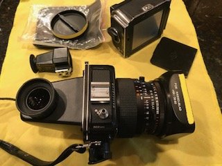

The SWC finder has a built in bubble leveler. In the later views finders the bubble leveler shows up in the view finder. If I need to see the exact coverage I mount the camera on a tripod, remove the film back and the view finder, attach an adapter and put on a 45 degree viewfinder to look at the image. Once set up, I remove all the added equipment, replace the view finder and film back, take the photograph, and remove the camera from the tripod. I usually take the tripod with me when I walk away.:wink:

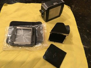

My SWC came with a groundglass frame I can attach in place of the A12 back, though Sirius' adapter+finder is a much better solution.

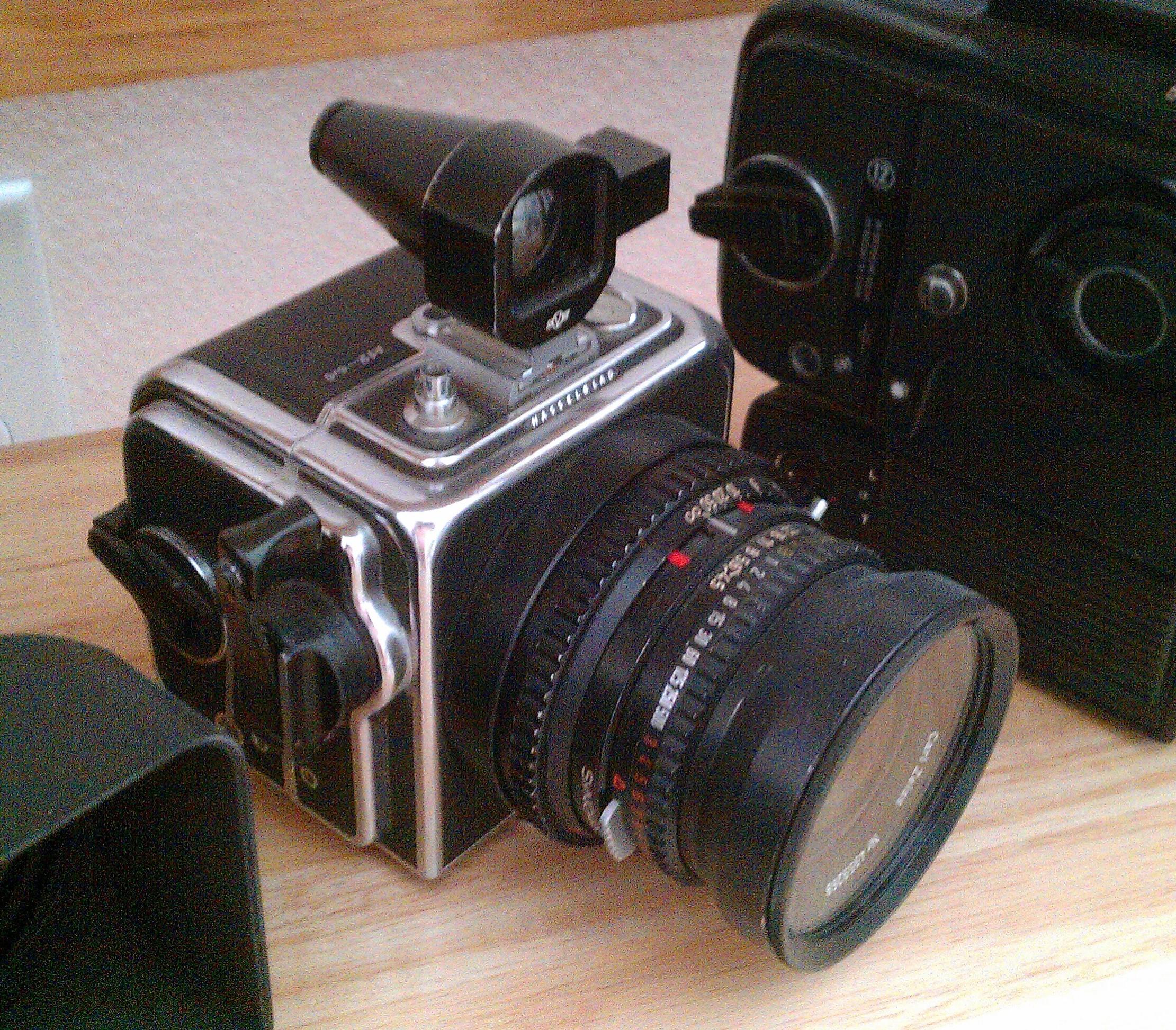

This is my SWC, an older one. Looking through the finder, it does show both the bubble level and the lens settings.
Those are such beautiful cameras. I've wanted one for 40 years. Maybe I should take the plunge.
That is so cool. Widest Hasselblad lens I have is a 50.
I don't think you'd regret getting a SWC. Although I am not fond of anything wider than 28mm (in 35mm format), the SWC's 38mm Biogon (24mm equivalent) is just magical. It is better than Hasselblad's 40mm lens because of its optical corrections. I've done architectural photography with my SWC and can attest that it gives perfectly straight vertical lines right out to the edges. I'm certain I've used my SWC more than all the other lenses on my 500-series put together.
