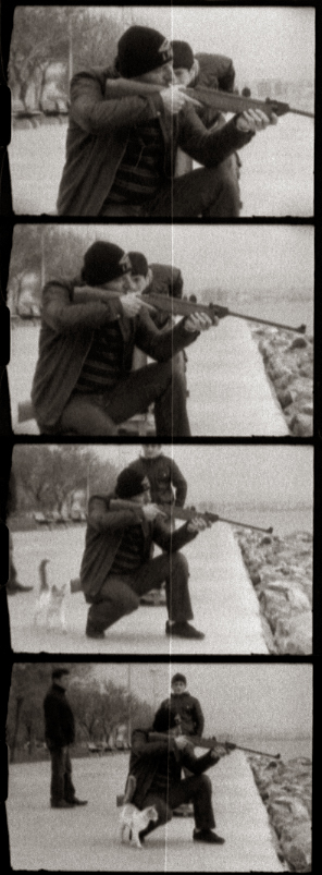

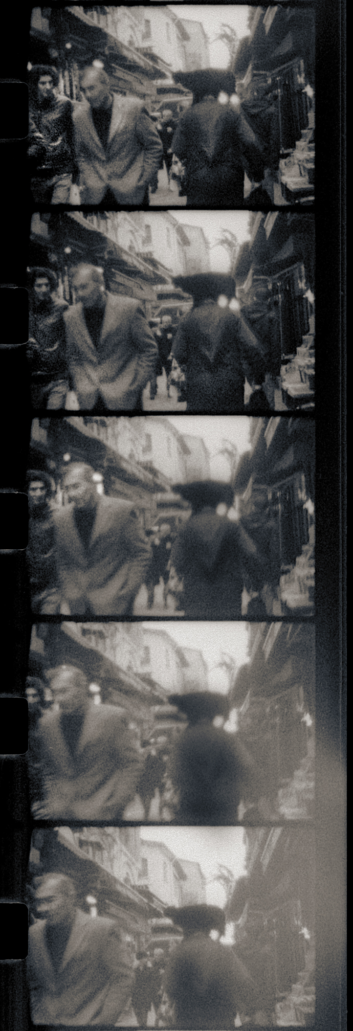

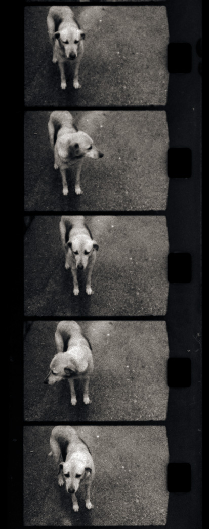

Hello,I was wondering if there are people who use their
8mm cam as a still film cam, (with a possibility to shoot with a motordrive of (in my case) 54frames a sec.
I own a leicina RT-1 and when I go on holiday I take this magical camera with me,
with a bulk roll of 3660 frames, an extreme telelens and a real fast motordrive for action photography. I like it
is there a low fi thread for it? (Istanbul 2011 cats and dogs)
