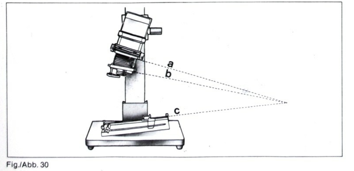

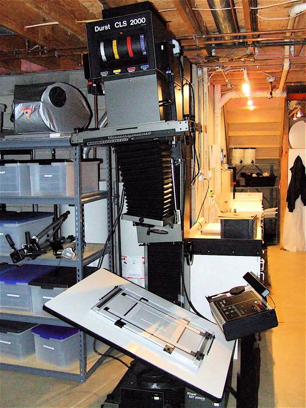

Full movements would include swing of the lensboard and swing of the table. Since the lensboard does not swing on the lens axis, the Durst also has shift at the lensboard, to bring the image circle back to the center.

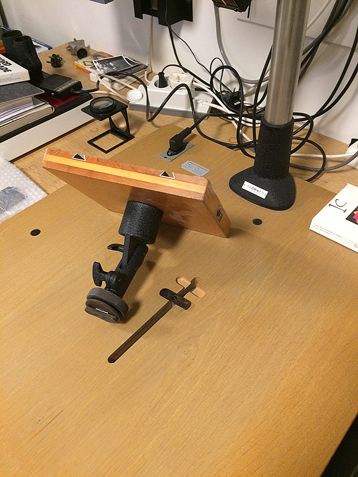

The Leitz Focomats Ic and IIc (35mm, and up to 6X9) made up to the early seventies have wooden baseboards with clamping systems, mostly to fix easels to the baseboard. These easels have corresponding slots underneath.
But there also exists a tilting device that one can fix an easel to. This device turns in pretty much any direction. I have had this piece for ages and never used it. See pictures . . .
Michael
Saunders also made something pretty similar, but with a vacuum clamp for baseboard attachment. Is the second easel in your images the Leitz borderless easel?
Lachlan, I don't know. Until now I figured it was just a small easel, to use for small sizes. But you could be right: I need to check, but I think those largest sizes are 10X15cm and I assume you are able to cut the prints to that size . . . The paper size to use is probably 13X18cm.
This small black metal easel came with the tilting device . . . also never used.
Michael
