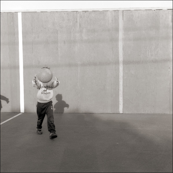

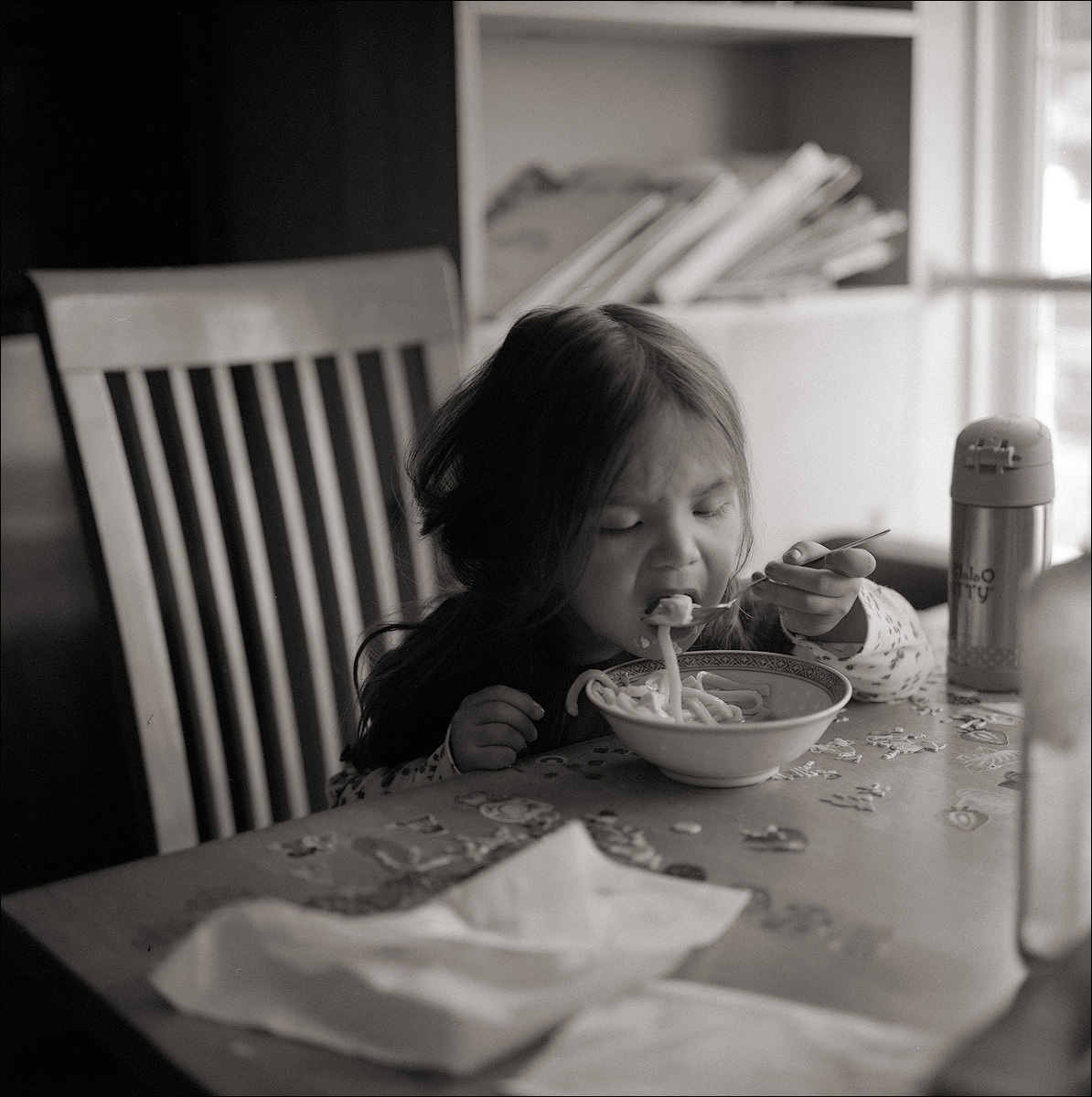

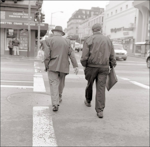

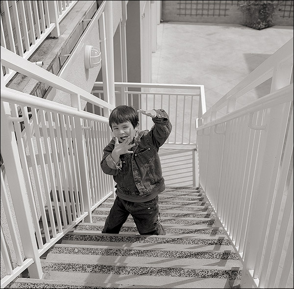

Oh, yeah, sorry. Yes, 80/2.8 and and also 75/3.5. Planars and Xenotars. I have a lot of Rolleiflexes I've collected over the years. Also own and shoot the Tele- and the -wide but I'm fairly certain none of those above are either of those cameras.
Correction. The one with my son and the ball covering his face was the Tele-Rolleiflex. That's a 135/4 Sonnar lens. Also the one with my son on the stairs was a SL66, 80/2.8 Planar lens.

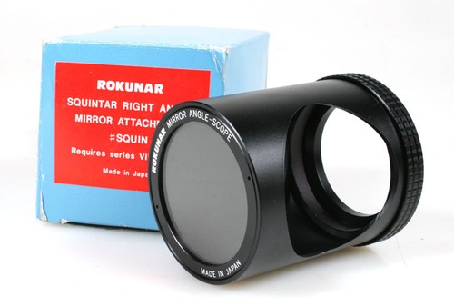

How about using a right angle lens adapter? They even called them "spy" lenses as I guess people don't see you pointing the lens directly at them. Never owned one so I don't know if this will work with the autofocus.
