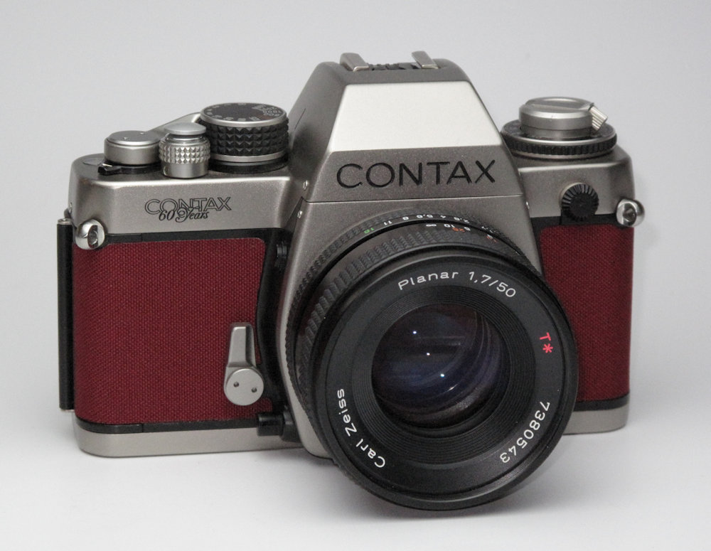

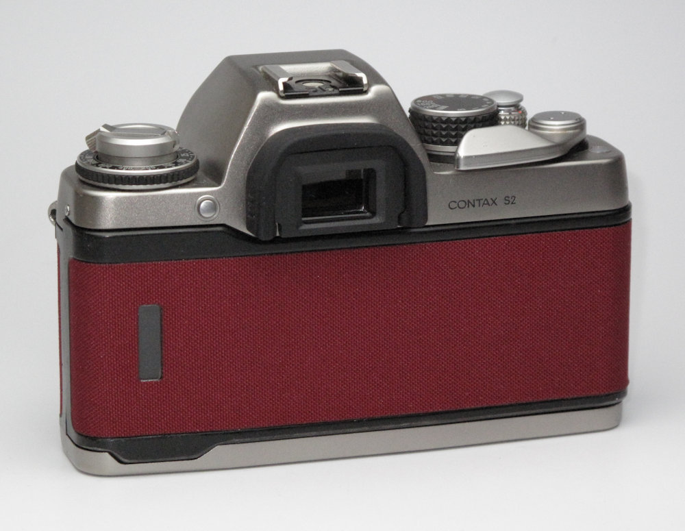

Well if you find a source please let us know. I've started to cut my own and making templates is not so easy, even if you have a complete one to scan. That will give you a starting point but it never fits perfectly straight away. I've found it almost as quick to measure up and start from scratch. I use a laser cutter so can't help with the Cricut. I did look at them but decided to go with the laser.
