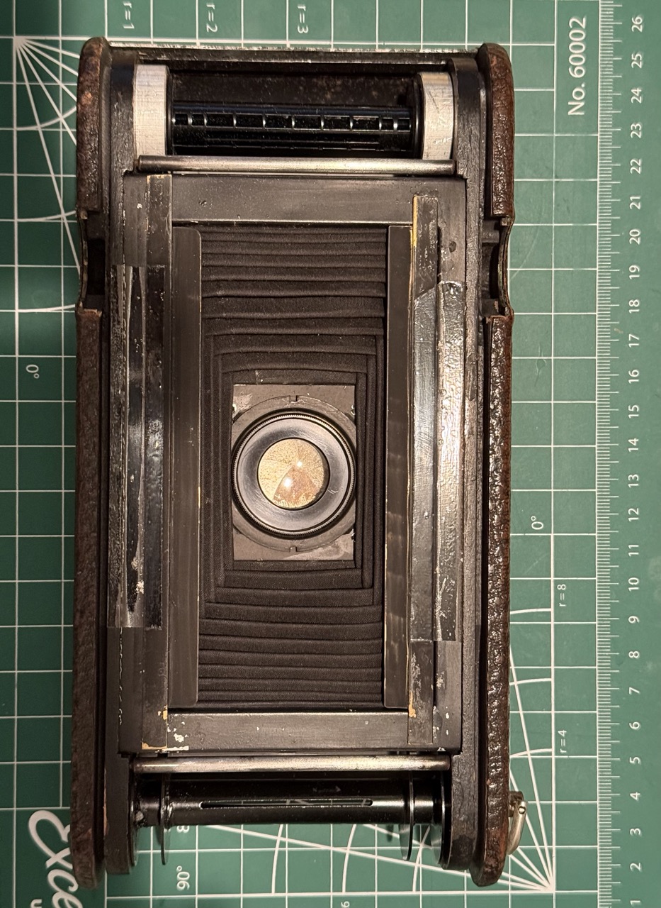

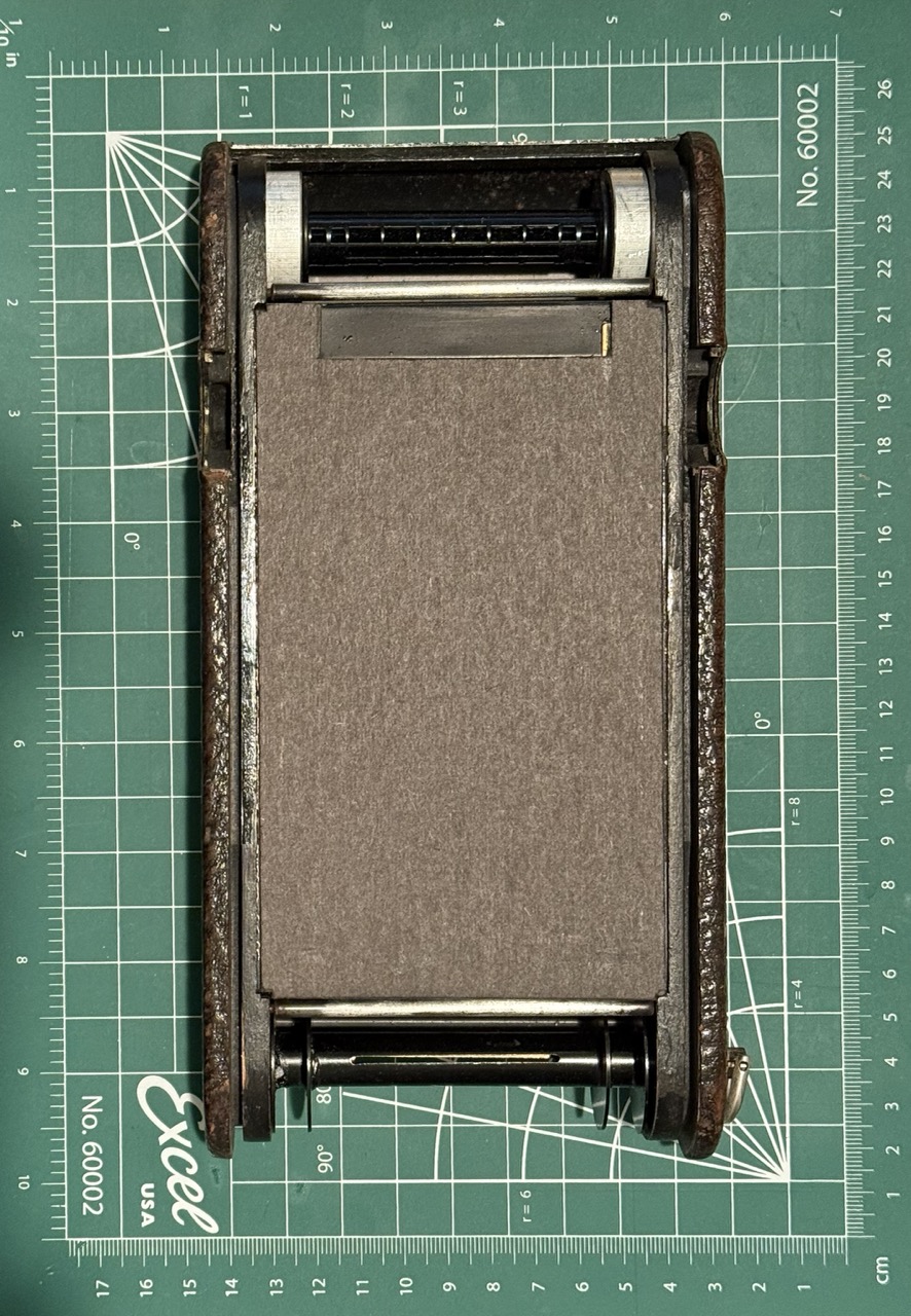

Here's a picture of the film guide rails I made from brass sheet, and a card "pressure plate that I used on my Kodak 2C. The top and bottom guide rails are made from two pieces (each), so that the bottom rail is the same level as the original film gate.
Hope this helps.

@P C Headland That is very much like what prototyped using cardboard for a Kodak 122-120 camera conversation. It worked well even using the camera’s native “pressure” plate. On my camera it seems that film flatness, such as it is, was controlled as much by film tension as it was by pressure; maybe more so by tension.

Looks like nice work. Someone else mentioned being able to use the 6x4.5 frame track if you can see it through the red window. A hole in that "pressure plate" would allow that.
I used the autographic window and made a new red window on the 6x6 track. I taped off the original window. IIRC I use 1,3,5,7,9,11 (it's a while since I've shot with it).
