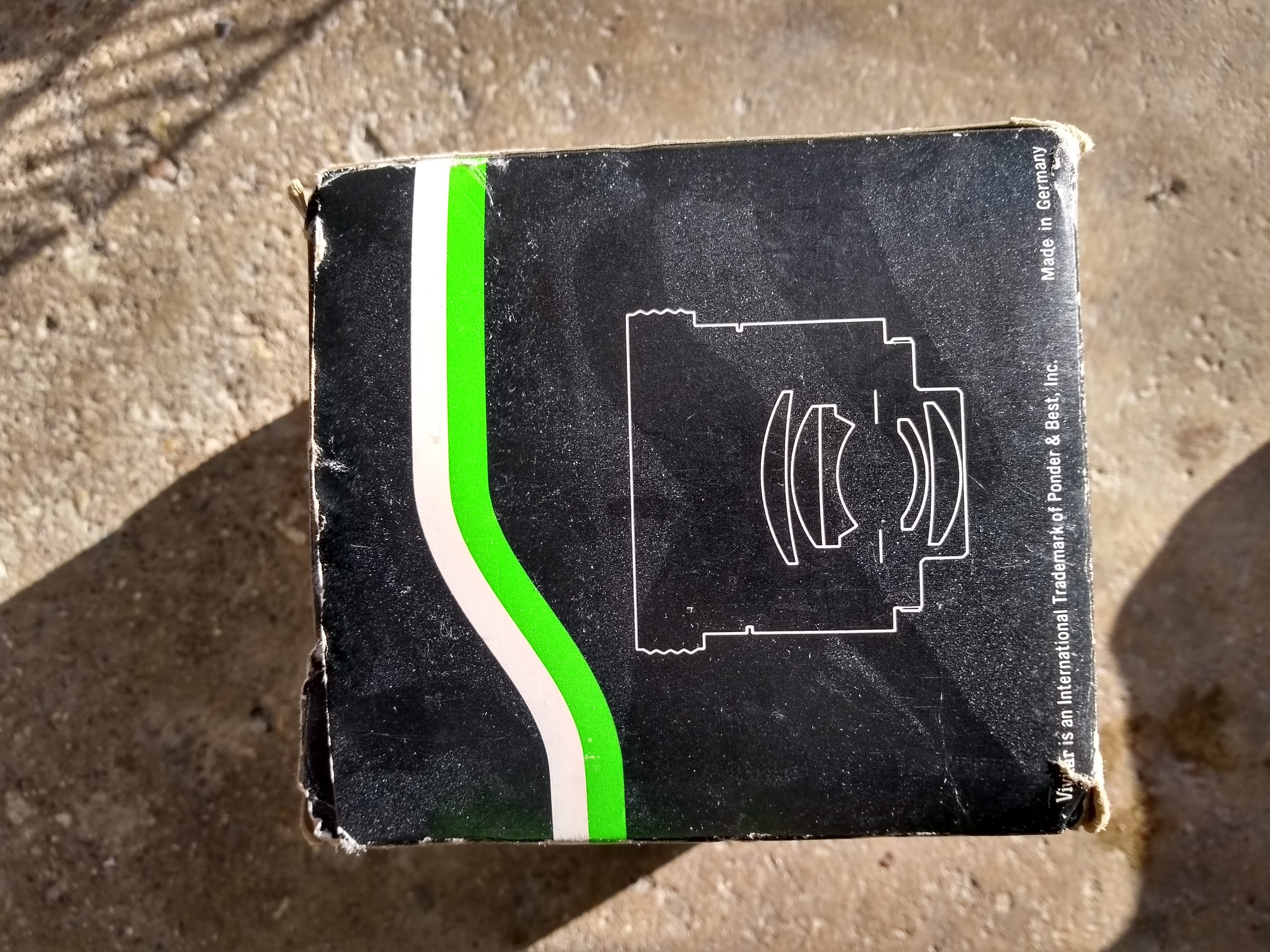

However, during the early 1980s, Vivitar brokered a deal with Schneider to buy the last production of the Generation 3 Componon (pre-S) lenses and sold them under the Vivitar VHE brand. These are all 6-element lenses and have typical Schneider 8-digit serials.
This is not so. Here is a photo from the side of the box for the VHE 50/2.8.

Have you tested Vivitar VHE lenses? hoojammyflip above shows us that the VHE 50/2.8 has 5 elements, not 6. But by the 1970's and 1980's, lenses were designed by computer, so later-model 5-element designs might be worthwhile. Do you know from your testing?
Mark Overton
The VHE 50/2.8 is the same lens design as the Focotar 2. This would make sense if they were both made by Schneider. To me it looks like a Xenotar. Anyway, its not 6 lens elements, its 5. The internet is full of misleading anecdotes which then get repeated, until the source is forgotten. Hopefully, the image of the VHE box above is sufficient evidence that this is a 5 element lens. In testing, the Nikon 50/2.8N looks just as sharp to me, so there is no need to go lusting after one, in my opinion.
