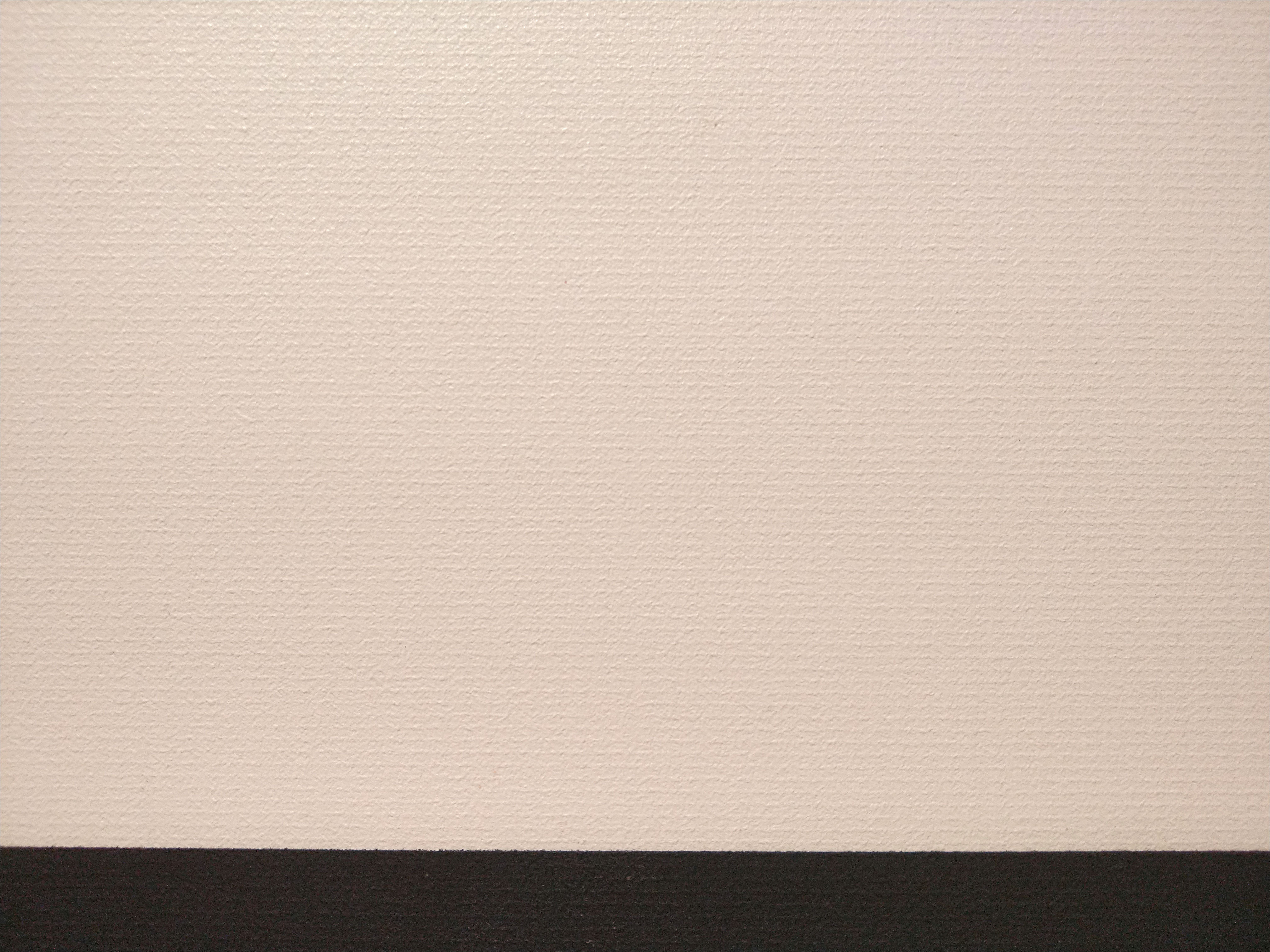

But a projection screen is not a smooth surface. There are those little sand-like elements stuck on the surface to help reflect light back brighter and to help people watching from the side see the picture better. How do those sand elements affect resolution?
They're rather fabric-like relief pattern/impressions against glare, to help with even reflection (scattering?) - someone way smarter than me could answer this. You don't want smooth plastic as a projection surface - glaring horror. But again - use case is a tad different: details are inflated, visible and larger than the said fabric-like pattern.
Grain of HR-50 is visible no problems, AN pattern too if AN glass frames are used: "Resolution" is good enough for me to perceive these from 2.5m viewing distance. But to compare apples to apples - we should evaluate the same stock projected and on the same size paper - as impractical as it sounds. Or do a detail shot/enlargement on smaller paper to compare.

"Resolution" because screen is not a paper, containing a finite, measurable amount of known size light recording particles, but is a reflective surface, no number predefined.
