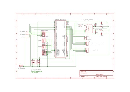

- Several drawings are available on your site only as low-res images, not usable, e.g.:
- I'm confused about the versions; if I embark into this project, I must make sure that the Arduino, the PCB, the code, and the user manual all match together, and match with what I hope/expect to obtain.
In: /monkito-schematics/ you refer to the schematic as "latest version". That is confusing: someday there may be a revision and it will no longer be "latest version". Why not give numbers like PCB_1.5, or whatever, and provide a compatibility table between software revisions and PCB versions, to take care of issues such as: "Relay pin is now 7 instead of 11. The schematics has not been updated accordingly." An up-to-date schematic is needed to wire the components properly.
