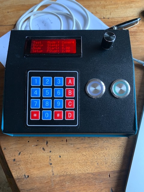

OK - Finally got the rotary encoder and can confirm that the changes Koraks suggested to the original code (above) work perfectly and without any issues I have seen so far. Photo of finished device attached. Thanks so much Koraks!

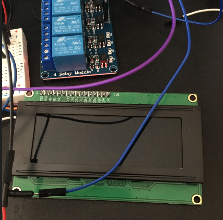

But my problem is my LCD, no menu display, LCD flashe every one second.
I tried with an example to display "Hello World" on the LCD and it's working, but when i put the code in arduino, LCD flashe
I don't understand...

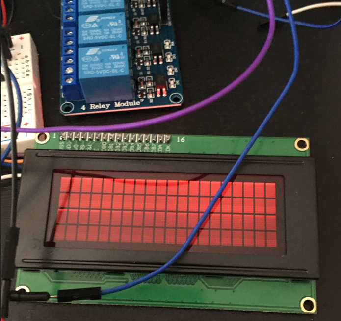

Thanks Koraks for your help and answer.
No letter appears on the LCD, all blocks blynk every second
in below two photos.

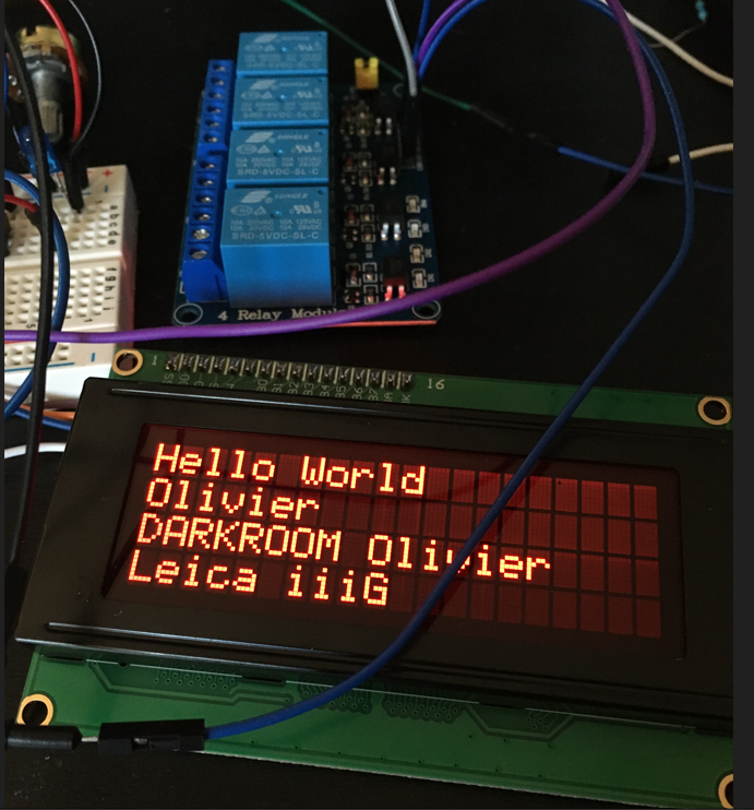

And if load the following program it's working:
#include <Math.h>
#include <LiquidCrystal_I2C.h>
LiquidCrystal_I2C lcd(0x27,20,4);
void setup() {
lcd.init();
lcd.setBacklight(HIGH);
lcd.home();
void loop() {
lcd.setCursor(0,0);
lcd.print("Hello World");
lcd.setCursor(0,1);
lcd.print("Olivier");
lcd.setCursor(0,2);
lcd.print("DARKROOM Olivier");
lcd.setCursor(0,3);
lcd.print("Leica iiiG");
