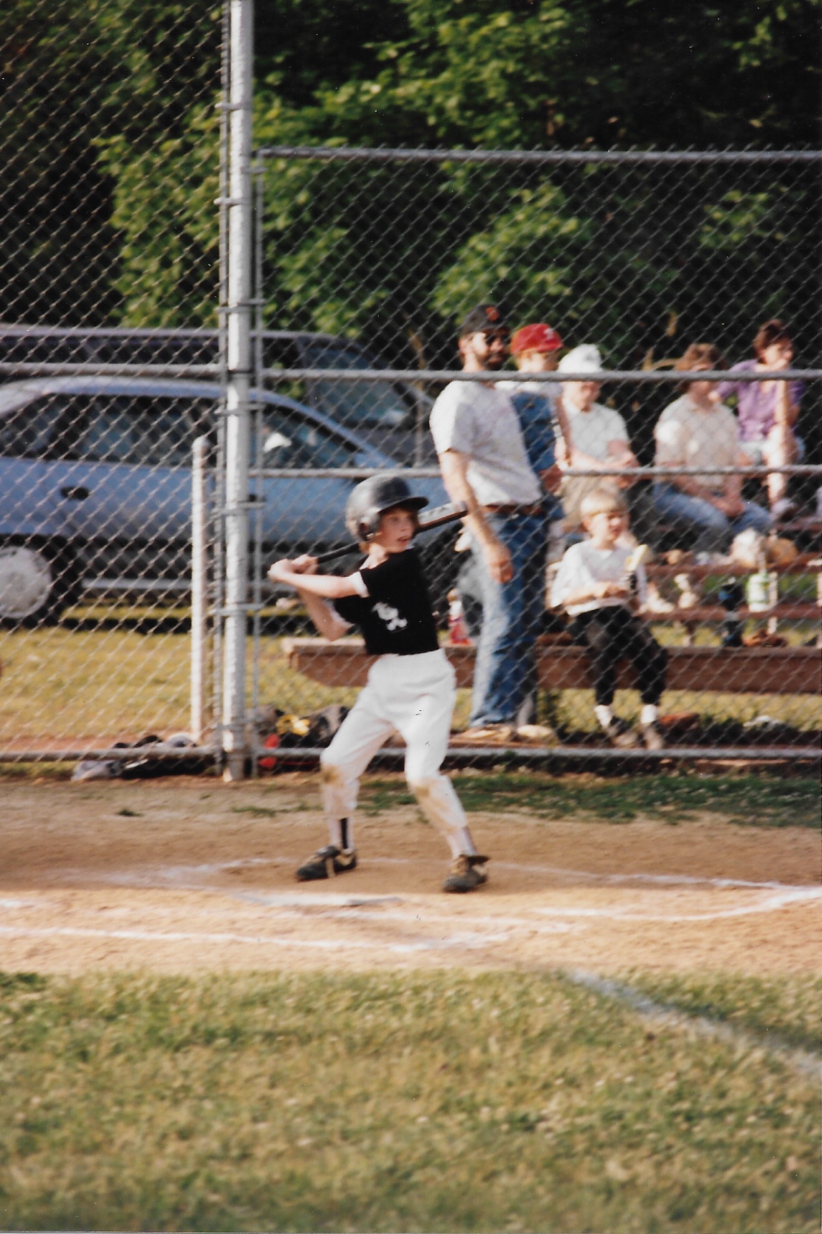

Hi!
First-time poster, longtime photographer, new-ish to the forum. Thank you for having me!
I'm in the early stages of digitizing my 14,000+ photos from the last 30 years. I have been saddened/shocked to find more than an acceptable amount of negatives showing major and uneven shifts towards blue (resulting in a heavy yellow cast when scanned). I cannot attest to the full extent of the damage, as I've only cherry-picked a few rolls to scan so far, but this has shown up enough for me to consider it an issue. The initial rolls in question are 25, 23, and 20 years old.
Three main questions:
1) is it reversible, chemically? (sadly, I'm afraid I already know the answer)
2) what's causing it?
3) can I stop it?
The facts:
1) All negatives 35mm and stored in Printfile sleeves since they were returned from the lab
2) The sleeves have been in archival binders **(or so they were advertised--but the shift seems to be in different branded binders, not just one)
3) The binders have been stored in smoke-free climate control their entire life, not perfectly archival, and I do live in the south (some humidity, and sometimes I stored the binders in a cardboard box), but they were never stored in the attic or basement, and many of the rolls in the neighboring sleeves are in great shape
4) The samples here span 5 years, so I'm fairly certain it wasn't just one bad lab
5) The shift only affects some rolls, even from the same vacation/trip/lab
6) The shifts show up identical on my Pakon, as well as the Noritsu my lab uses
Below are the examples including the dates and stocks used, alongside the original prints for comparison.
**these are not my favorite or best frames, they are the most concise representation of what's happening
**In some cases, I can correct some of them with some serious work, however, the shift is not even across the roll(s), and sometimes uneven within each frame. This is a major shift.
Why????
Can I reverse it?
Can I stop it?
Happy to share more examples, if helpful.
Thank you in advance!!!
July 1995, Kodak Gold 400
1995 print, 2020 scan
December 1997, Kodak Gold 200
1997 print, 2020 scan
January 2000, Agfa HDC 400 Plus
2000 print, 2020 scan

Comes with territory of color neg films, especially if these were commercially developed in a less than ideal manner. Humidity and lack of air circulation accelerates these issues, as might those plastic sleeves. You might be able to salvage negs without symptoms yet, but there's no way to reverse extant damage. You can make semi-corrected digital duplicates.

Do you see it on the film or is it a scanning artifact? Kodak made a Photoshop plug-in called Digital ROC that could help with color shift with age. But the stain might not be easy to fix

The 2nd example (dec 97) shows variation across the frame, which suggests that environmental conditions play a role here. Humidity and temperature are the first suspects, but gassing out of materials (sleeves, binders, boxes) cannot be excluded.
Apart from ensuring that storage conditions are optimal, there may be benefit in rewashing the film and treating it with a stabilizer bath, preferably an old fashioned type with formalin.
I *think* I can see it in the negative. I know it appears identical on more than one scanner

The color shifts I posted about are on negatives and are always towards blue (yellow when printed/scanned) and do no seem to affect other colors, certainly not noticeably.
I'm looking for info on this specific issue. There must be a single culprit (or culprits), considering the color shift is always similar across multiple storage binders and film stocks. Something made them turn blue. I get the possible variables, and have my own speculations.
Some sleeves (many) are in great shape, and the examples I posted are from separate labs, so I can't blame them.
Has anyone seen this, specifically. If so, is there a known cause?

Color negs have an orange mask. If that mask fades or discolors differently than the image dyes, it's one potential source of such symptoms.
Thanks for the quick reply! I don't see a physical change in the base. I can't be the only one to experience this so I'm going to keep searching until I get to the bottom of it (or give up--but I'm not there, yet).
