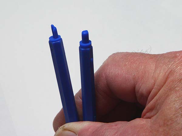

There is a plastic tool that has two different ends, one to open the film gate in the APS cartridge, and one to turn the cartridge spindle; but a small screwdriver and a piece of dowel could be used to improvise. I've not measured, but I wonder if some of the old adjustable plastic roll film tanks will adjust down to the needed size. I own a couple of the aforementioned tools, but I was only interested in getting the negatives out to scan for the web.
Here's an 111414082.jpg example of the tools.
And here's getting the film out with improvised tools
