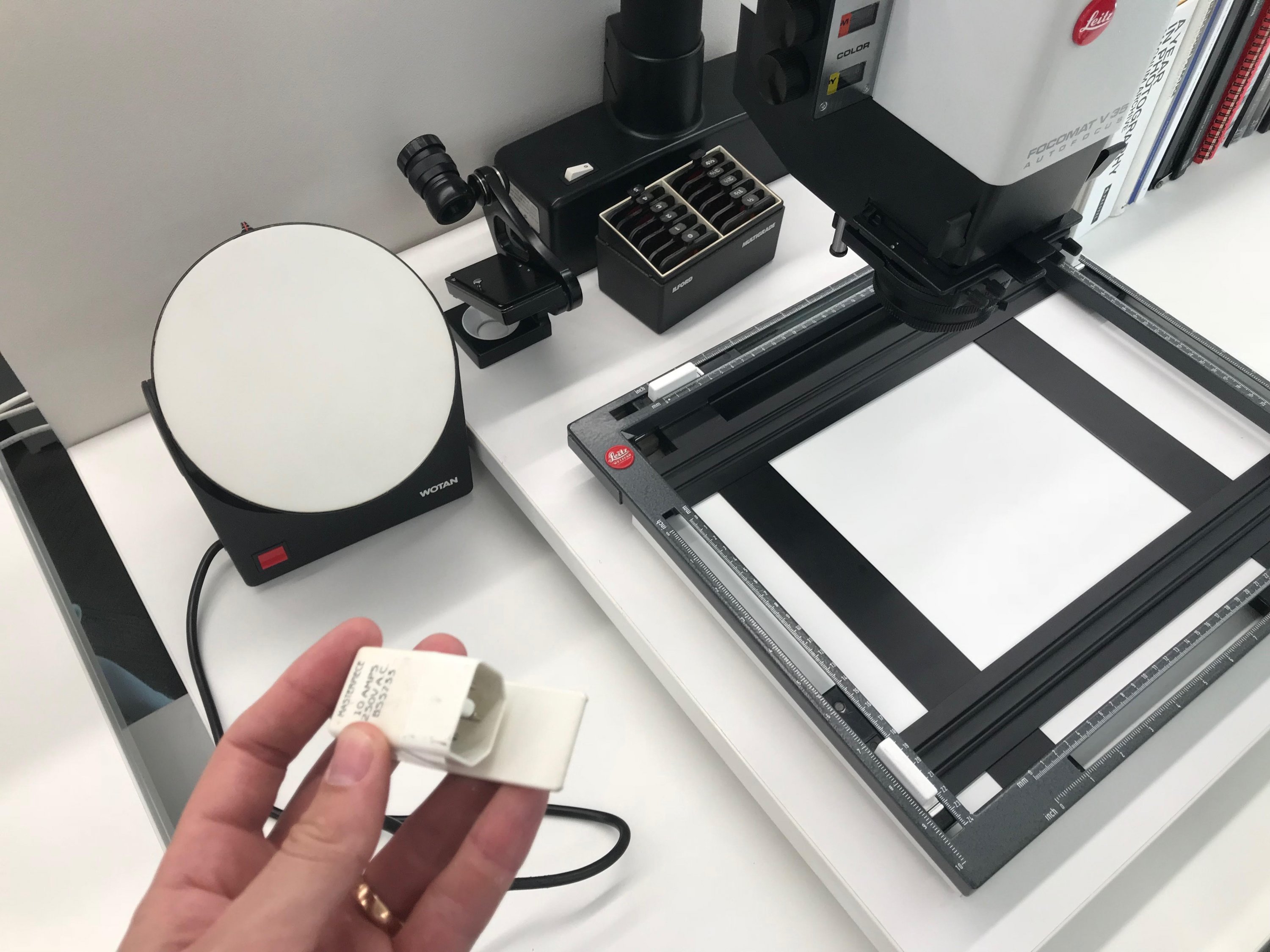

Can anyone help with the following info.
I just one the WOTAN 10 on eBay (about £16 GBP) UNTESTED.
Not sure if it works but I thought it worth a gamble at that price,
It came without a red filter disk, just a white disk.
Do i need the red disk for black and white work, can you buy the red disk separately?
How is it powered? It came with a strange plug socket... (Photo attached)
Can i just take the socket off and wire a British plug?
any info would be great thanks in advance.
-) the plain luminaire is intended for colour papers with their spectral sensitivity gap. For everything else make a foggingf test under your conditions, to establish whether or not to use that extra red filter.
-) you got a special male connector unknown to me, someone mounted likely to get a small coupling within the cord or to some special outlet.
Have a british male plug mounted.
I would guess that that safelight originally came with another appliance - probably a timer - that had that plug.
It looks like a power plug that used to be used over here to plug some computer monitors into the back of desktop computers, so that the monitors got their power without having to have a separate cord to a power source, and to permit the monitors to be switched off by the computer.
Think DOS, CRT monochrome monitors, and music from the 1980s!
@matt thanks. you paint a great picture.
@AgX appreciated.
I will have a go at re-wiring tomorrow. Does anyone have a spare RED disk they may want to sell?
It looks like a IEC C15/16 plug for high temperature applications and you will need a BS1363 to C15 Power Cord.
Jamie, just bear in mind that the lamp and the bulb are unlikely to be new but there is no way of knowing how much life there still is and a new bulb is expensive. If it works and I intended to do a lot of colour printing but very little B&W then the extra time on B&W may not matter but if I were a mainly B&W printer but intended at a later stage to do colour I'd be tempted to get a B&W safelight and save the Wotan for colour.
Not for high but medium temperatures, but otherwise you are right.
I actually got it in house, But I never saw it with such plate attached, made me think of kind of lock for cable coupling.
Anyway, that connector basically makes no sense at such luminaire.
By the way, the manufacturer is german Osram. Once market leader in Europe next to Philips.
In UK that brand name was lost due to the Versaille treaty. There they used instead one of their old brands: Wotan.
Correct! Also known (or used to be known before the days of cordless kettles and bases) a kettle lead. It might have been originally fitted as an easy way to extend the cable...
Just one further point. The Wotan is designed to be permanently on throughout the printing session as its "safelight safety" changes as it warms up each time on being switched off then on again, so switching off and on each time you expose a print may not be sensible and might ( but I don't know) shorten the bulb's life.
^ All this. On this type of lamp (which I've just thought is similar in a way to LCD projector lamps) repeated striking (switching on) and temperature cycling will wear the lamp out faster. Once it's on, leave it on for the full session and cover the front of it if you need darkness for a few mins. Once it's struck, it will consume very little power.
If you need a red lens, keep an eye out for non working ones on eBay. They do come up occasionally...
-) in that case one would have employed the cold-appliances version of such connector
-) I never saw any german electrical device delivered originally with a coupling installed within the mains cable
-) fitted at its end it makes no sense either as there are no wall sockets with the resp. counterpart

@Fin - I will go buy a Kettle lead. and set an alert on eBay - Has anyone tried the WOTAN on B&W without the RED filter fitted?
UPDATE: I just bought a plug and it switches on. It takes a few seconds to start and it makes a humming sound (buzzing) is this normal? How do I know it is now hit maximum brightness? I read somewhere it can take upto 5 mins to fully working. The light it emits is very warm yellow/orange, should it be?
Good that it is working, You may have hundreds of hour left in it. Yes it does buzz and take at least 5 mins to warm up. It has been a while since mine was on but a yellow/orange sounds right. I'd tilt it towards the ceiling. That way there is no direct light on the enlarger or developing tray. Due to the size of its front the light spreads well. Ideally try and place it higher than the enlarger so its out of the way and reflects off the ceiling.
Hopefully you'll get an answer about its suitability for B&W without the red filter. Don't hold me to this but not long after I got the Wotan I think I did try a B&W printing session and it was OK. I have never had the red filter so cannot speak from experience
