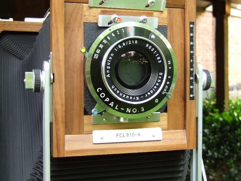

I like the old Angulon 6.8 lenses. Nice images and small size and I'm using 90, 120 and 165 since before. Now I've bought not one but two (mistakes happen) 210/6.8 without shutters. Mounting one of them into a shutter will be an expensive affair (I was looking at the price list at S K Grimes) so I'm trying to see if it will be worth the cost. The main problem for me is that I get different numbers for the coverage. One site lists them at 362mm at f22 and an old Schneider catalogue claims that they cover 12"x15" at f22 (480mm) which is a quite different coverage.
Anyone out there with an actual experience of using one of these on 8x10?
It will cover 8x10 with some - not a lot- of movement. The specified coverage of Angulons, like their close relative the Dagor, is open to interpretation. An IC of 480mm is probably extremely optimistic, but may work out for contact prints. Your best bet is to try it out. I'd test both of your examples; there is an innermost element of each cell that is supported by the balsam only and if the lens has been stored on it's side in a warm environment for an extended period of time it's possible for this element to shift.
Thanks for the advice. Both lenses seem to be in good condition but since they are without shutter, or any means of mounting them on a camera right now I cannot test them. An IC of 480mm does seem like a lot, but the figure is from a Schneider catalogue (I can dream).
If the attempt to attach a photo to this post there is a picture of one of them (they are both the same). I would like to use one of them but I'm trying to motivate the rather high cost of putting it in a shutter. If the IC is below 400 it is not enough to replace my current 210.

The 'light' circle projected by the Angulon is indeed very large. The corners are just clipping with my camera like this. However, the sides of the bellows show, so, without a bag bellows, the camera is not usable in such extreme conditions. Are you using a monorail 8x10 or do you have a bag bellows?
