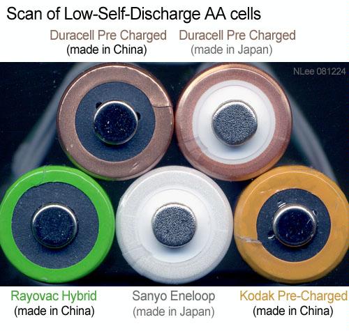

After some on-line research, it appears the Panasonic Eneloop batteries are not available in physical stores in the US. On-line ordering only. So, no way to check them out today...
However, competitor NiMh Hybrid Low Discharge are available in USA stores. The Rayovac Hybrid Pre-Charged are in a store near me.
I need about 30 AA batteries. I don't have that many, I swap between cameras and devices. At this time I'd say I only have about 8 good conventional NiMh batteries, thus the reason for this thread. I'm in the market to get a bunch of new batteries.
I'll pickup some Rayovacs today and report back.

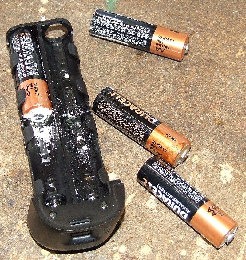

BTW, I'm no fan of Alkaline cells. They leak and destroy equipment.
Only if you fail to remove them from the equipment when not it use. By the time a battery leaks, it has lost its charge quite a while ago. With a battery tester, you can monitor the charge status.
It's really just a matter of getting organized and following a smart routine, and you will never have to deal with leaking batteries destroying your camera, flash unit, etc.
When is a camera 'not in use?' When it is loaded with film and on the 'ready and waiting' shelf or in a camera bag ready to go. Since you never know when the alkaline cells will let lose their innards, the only safe place for them is outside of the equipment. In that case they are useless.
Jul 31, 2012
3,360
I don't know if it is the case any longer, but Duracell used to offer replacement if one of their batteries leaked in your equipment. About 7 or so years ago I got them to replace a Sekonic meter to the tune of over $500 when a battery leaked in it. The guarantee was buried on their website somewhere.

Loaded equipment with some Duracell pre-charged. Based on the image I posted in #11 above, they are made in China. They indicated a 90 to 100% charge in the equipment when installed from the package. Package inkjet code reads: 7016868102, no way that I know to decipher the manufacture date from that.
