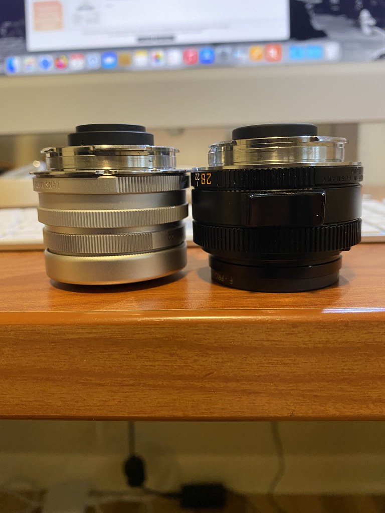

Here is the 15 4.5 Heliar LTM next to a 28 2.8 Elmarit-M. Both are at minimum focal distance and the Voigtlander has the lens cap on to bring the two lenses to approximately equal length. I haven't measured them but here is a visual reference:
The Voigtlander looks like it extends a bit more into the body. It may not hit the M5 stalk but it sure looks to close to try. Maybe a broken CL would be a good test body.

p.s later today I will compare the depth protrusion to other lenses which work fine on the M5. There are lenses - like the 7Artisans 50 1.1 - which must not be used on the M5 as they will hit the meter stalk.
Thanks! Is there a list anywhere? I don't expect to be affected, but it would be good to k now which ones to avoid.
Thanks. It doesn't look promising.
First off, that is a gorgeous 28 Elmarit Asph. Whoever you bought it from must be a stand up guy and popular wid da ladies.
But back on topic, no that does not look promising, every mm counts so I wouldn't risk it.

I got the lens from a dood in SOCAL who has both a M7 with a Summilux and a fifty dollar Kodak Ektar in the same bag.
On subject: My rough estimate is the Voigtlander extends a bit more than 1/10th of an inch further into the camera at MFD. A little too close for comfort considering how hard it it to find someone to work on the M5. Works great on my M4!

Measuring from the front flange of a Rayqual LTM -> M adapter mounted on my M5, I'm getting a plunge distance of ~17.8mm to the face of the metering cell. As long as the distance between the 'face' of the lens flange (without an LTM -> M adapter) and rear element when focused at infinity is less than this, there should be no chance of collision.
