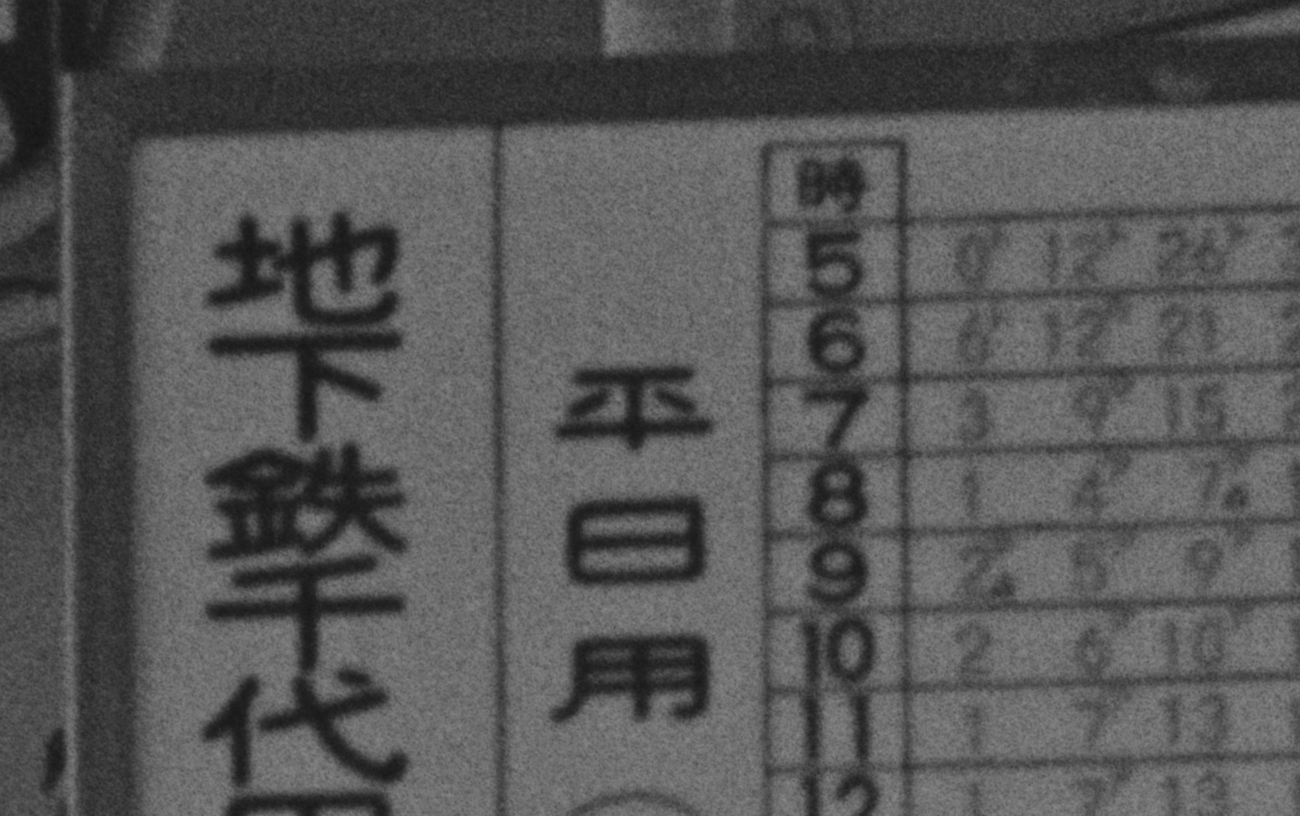

More to chew on! Another set of copies of a 35mm Tri-X negative, this time using an A7RIV with Sigma Art 70mm Macro, set at f/4. From top to bottom, these are single-shot, four-shot and sixteen-shot captures. The multi-shot captures were converted to single DNG files using the LibRaw PixelShift2DNG utility. Raw files were converted in RawTherapee 5.8 and saved as TIFF files, then opened in Picture Window Pro 8 for final processing, which consisted solely of upressing the smaller files using bicubic with sharpening set to 0, and then cropping for presentation. Again, the crops are presented here at 100%.
This clearly shows the cleaner grain representation of the 16-shot version compared with the "worms" from the single shot.
Really though, the benefits for 35mm Tri-X are going to be extremely marginal compared with larger formats and better resolving films.

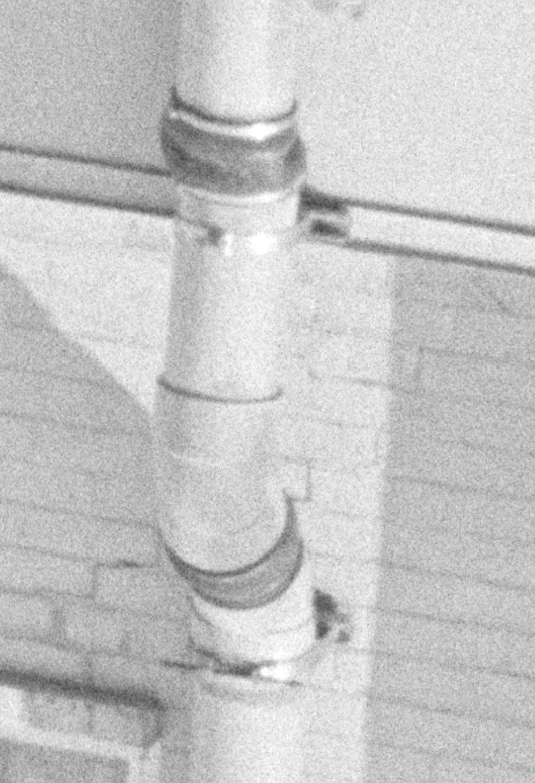

Here are three captures from the same 35mm Tri-X negative. The top one is Nikon LS-9000, the middle one is GFX 100S with 75mm f/4 Apo-Rodagon-D 1:1 lens, and the bottom one is GFX 100S in pixel-shift mode with 75mm f/4 Apo-Rodagon-D 1:1 lens. For both of the GFX captures the Apo-Rodagon-D was set to f/5.6 marked aperture.
The GFX raw files were processed in Capture One with sharpening set to 0 and saved as TIFF files. All three TIFF files were opened in Picture Window Pro 8 for final processing. Minor curve adjustments were made to roughly match contrast and brightness to minimize discrepancies that might bias perception. The two smaller files were upressed to match the pixel-shift file using bicubic with sharpening set to 0. The crops here are presented at 100%.
