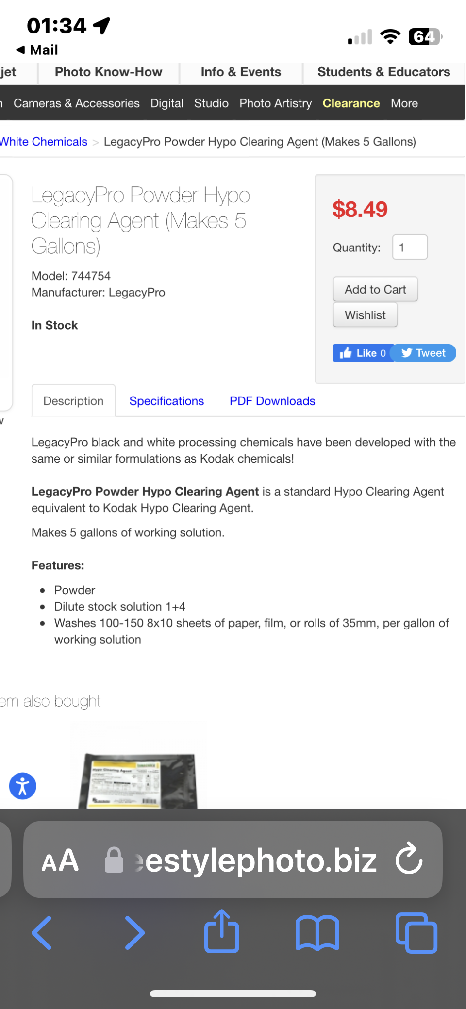

What is the difference between Hypo wash and hypo clearing agent?
Hypo wash/ Hypo clearing agent, as Sirius Glass says, are the same. Hypo Eliminator is different, but I don't think you can even buy that anymore.
Oh I see one is Eco and one is a copy of the Kodak product.
No, Hypo Clearing Agent is the Kodak product.
This is old packaging:
The use of exactly the same name - including the use of "Hypo" and the same capitalization - by Legacy Pro is probably a trademark infringement, but I think the chances of Sino Promise suing to enforce the mark are pretty small 😁
