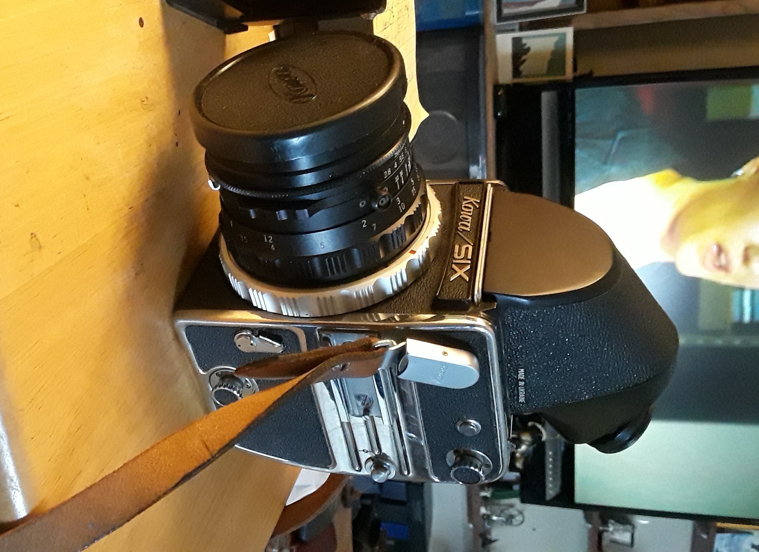

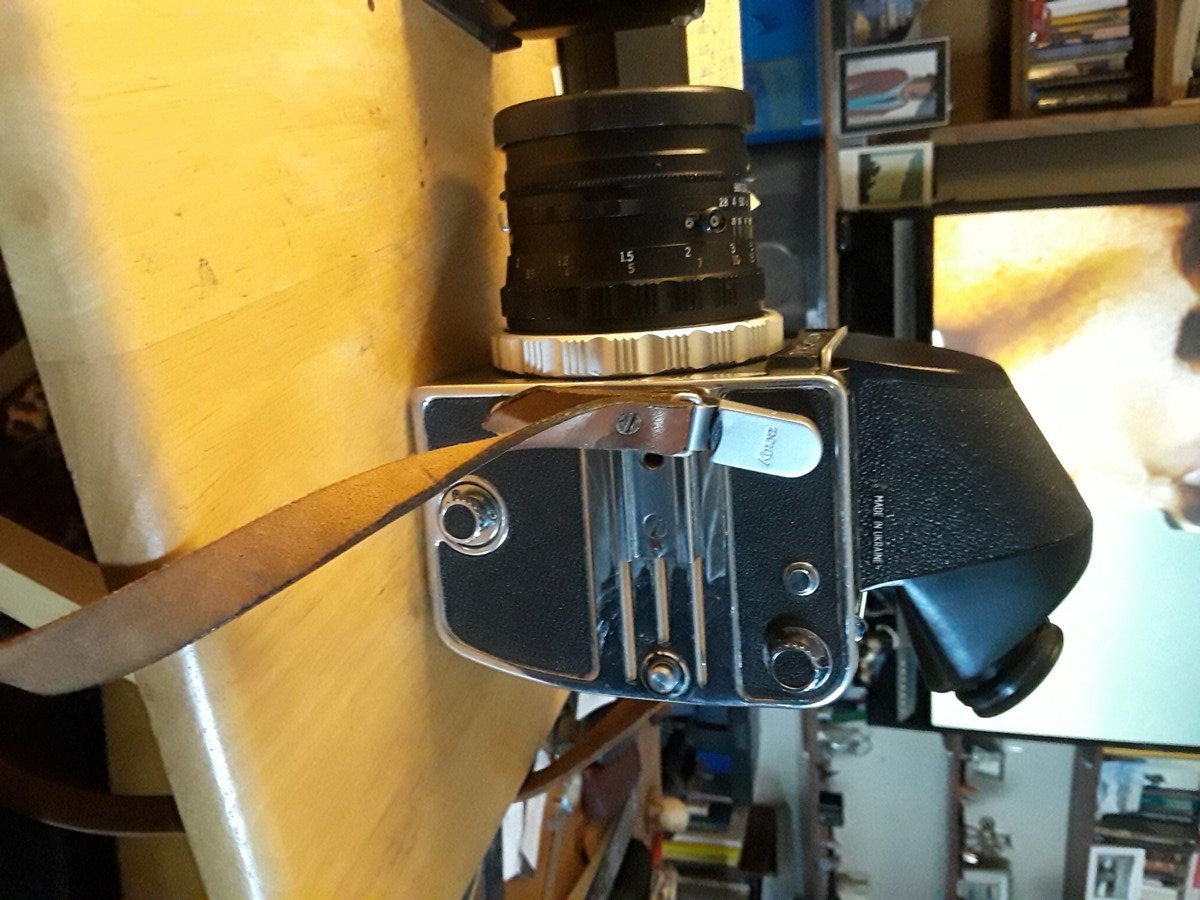

Although I love the bright waist level finder, I had a hankering for a prism finder. The originals are hard to find and expensive. I stuck my neck out and got an NC2 copy for about 30 bucks. It works great, a wee bit loose, but that is easily fixed. It makes it much easier to focus and the correct view is really nice.
I have both the metered and the unmetered eye level, still bright, the meter is no longer working, when it was functional did a reasonably good job.
^ I'm envious , the metered eye level finder was a source of GAS for me, but after this much time I'm pretty much over it.
The Sekonic 208 does a good job and is really small too. Peter
30 bucks and a bit of tinkering.
I have no idea why they are loading sideways. :-(

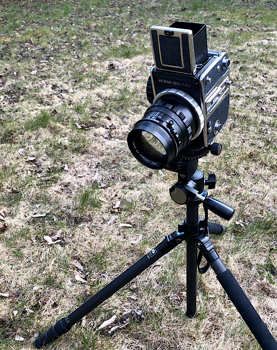

I just picked up the first style 55mm lens, the one with the big front. I would dearly love to put a bit of protection in front of that beautiful piece of glass. The calipers make the thread diameter at 84mm, but such an animal does not appear to exist. Any insights on the filter size?
I couldn't find one for it when I was hunting last month. I did find the slip-on lens hood on eBay and bought one of those.
It's 86mm if anyone stumbles across it in the future. The front lens cap is a 90 push on.
I feel much better with a UV filter over that huge piece of glass.
Thanks for that, good to know!
I personally am not a UV filter fan, but it helps a lot for looking for ND filters and Polarizers.

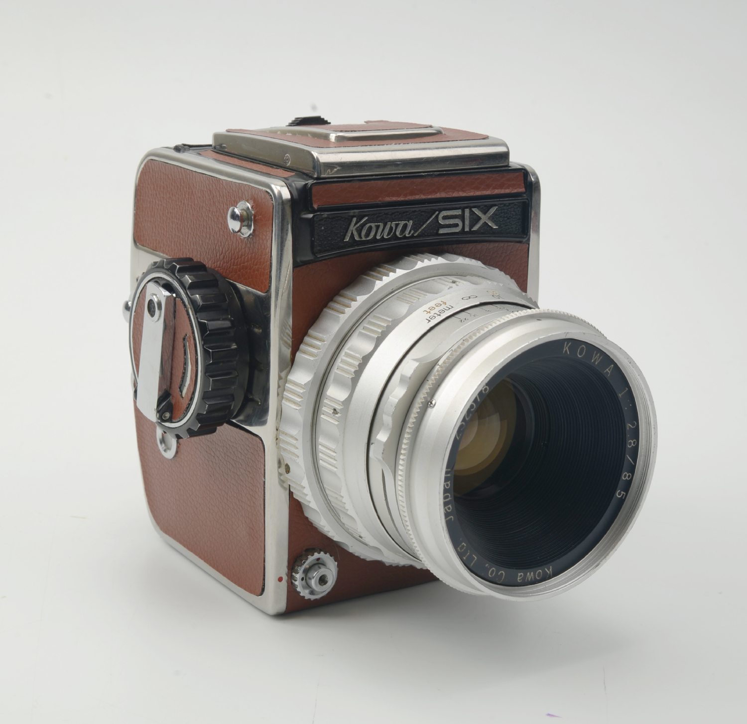

I picked up a jammed Six for not much money and tore it apart. The damping piston was siezed and also there were a few other things going on. I replaced with parts from another dead Six and got it up and running again. Couldn't find a source for pre-cut leatherette so I cut some of my own from brown stock and recovered it after I put it back together. Works great now!
Jeremy
