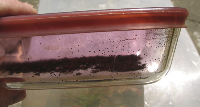

Hi again,
The distance could be a problem. I guess it's only 50 mm away from the plate nuw but to improve this I have to build a new bottom section for my box.
I lost some time because I had no clue about the sort of reaction I had to expect from Iodine. I remember leaving the box out in te sun for hours without any visible reaction. (that was with a dose of bisublimated Iodine - tiny little balls)
Then I used crystals. I expected them to react in mid air but again nothing happened. So I sealed the inner tray of my box and put it in the sun again. You can see the different tints of vapour that I obtained. Can you hint me on how intense it should be?
I know the heating sounds tricky but my box is sealed well and I wear a high quality breathing-mask at all times.
