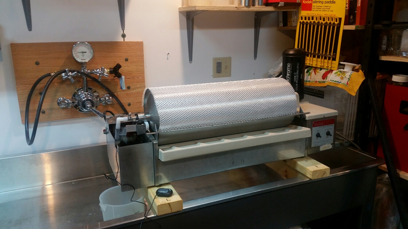

Here's the beast, Cibachrome 8x10 tube for scale. That mixing valve is a Genuine Lawler made Kodak mixing Valve that I got from a guy in Rochester brand new 40 years old:D. The bearings were broken from rough handling found a company made exact replacements. I trimmed the fishnet too wide it needs to be about 3/4 inch narrower on both ends. Looks pretty good for being close to 50 years old NO ONE made equipment better than this. 316 Stainless, magnet wont pickup a screw, washer bearing nothing it's all 1st rate. Best Regards, Mike

thanks for the pics, looks like a nice beast! so cool that someone is keeping things like this going.
A interesting machine, the inversion of todays rotary processors.

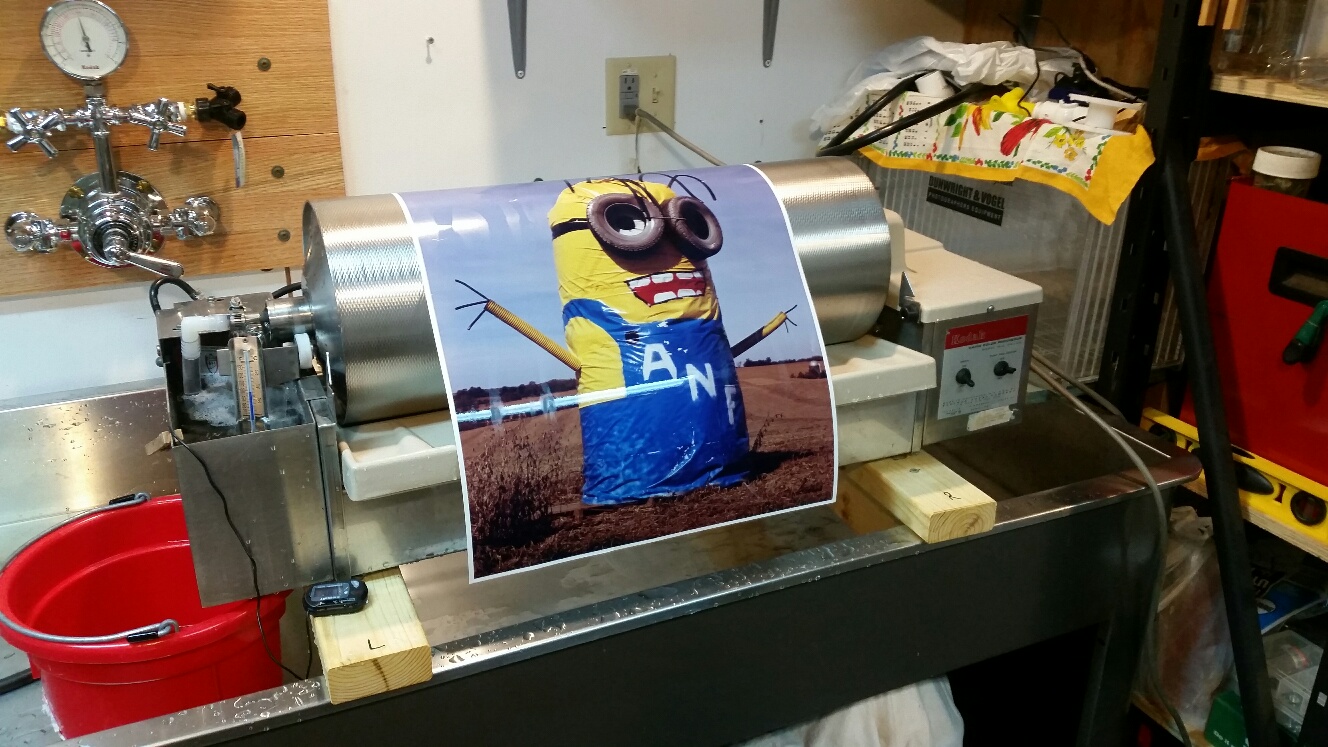

I fired up the Beast today! works lie a champ. Picture is from a roadside display of big round bales of straw, ANF Minion, (ANF, America Needs Farmers). 4 minutes on machine, 38 seconds through my rescued Ilford dryer. Machine is ready for next print as soon as one comes off. No cleaning or drying tubes. If I had a two person crew I think I could turn out a print every 6 minutes. Best Regards, Mike

PS. I've got three Thomas super safelights with color filters. You can see everything quite well (well well enough):D
This brings back fond memories of my first two years at photo school, two people per room, just bigger than a room closet, Chromega enlarger with storage underneath, and a K 16 in a sink, we really could pump out the prints with this unit.. I am really surprised home darkroom workers have not tuned into this great machine.
